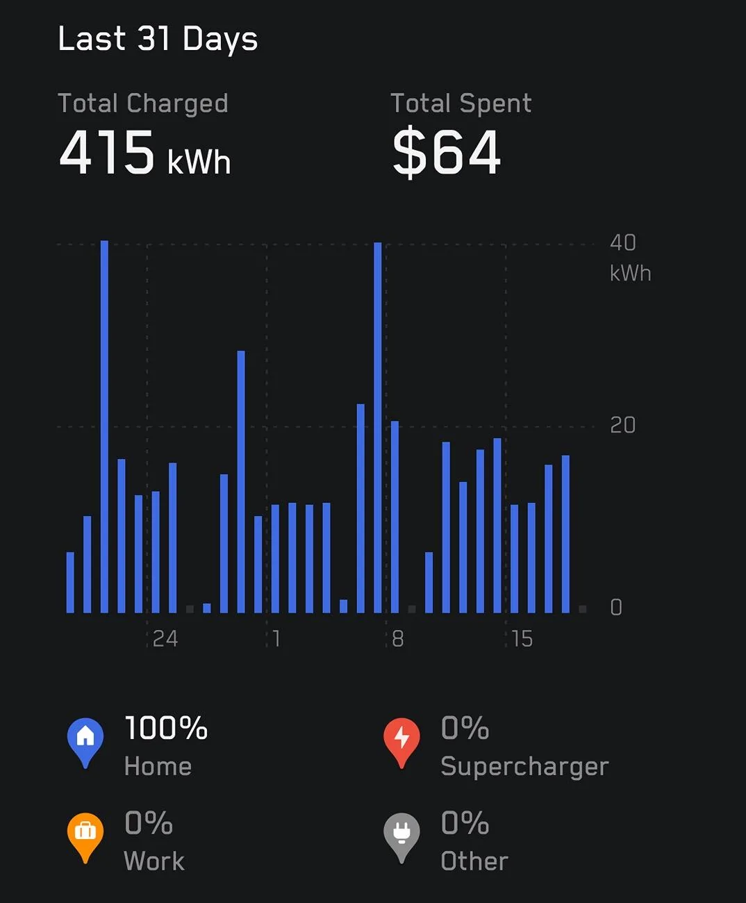

I plug in and charge to around 58% when I get home. After the sentry mode drains over night I leave for work at about 54-55%. Total burn per day there and back is around 25%. Then repeat.
The internet says 20-60 is ideal from what I gather.... But probably extremely conservative.
