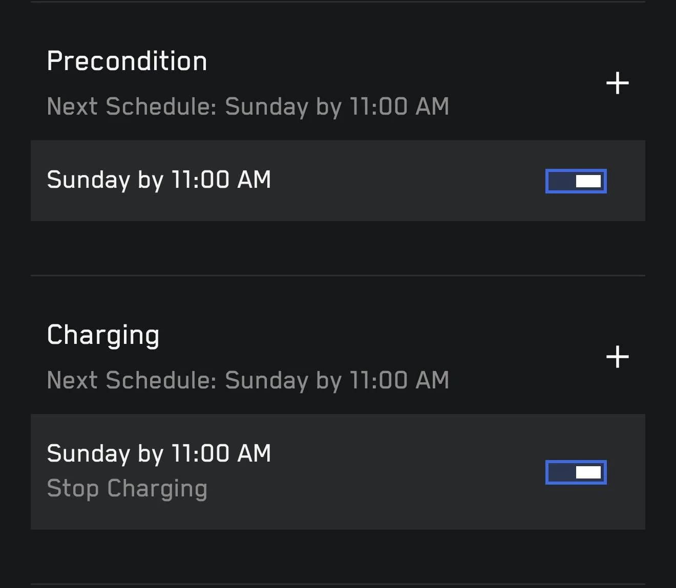

I’ve previously been able to schedule charging to end at a certain time, and it worked correctly. It should start at 5AM tomorrow to reach the limit at 11AM, but it’s just starting right away. If I stop charging now, it won’t automatically restart in the morning at the right time, at least the last time I tried it.
EDIT: this condition in the manual is causing it to start right away
  • “When the next scheduled charge is more than 18 hours away and not the current day.”
Changing the time to within 18 hours made it work correctly ?
I’ll leave the post up in case it might help others.

Your schedule reads start at 11am Sunday and end at 11am Sunday.

The “trick” is to set your end time and NOT set the start time. Then when you plug it in, it will light up quickly to assess how much juice it needs to hit your stated charging goal, then it will go to sleep. It then wakes up when it needs to wake up to hit your goal.
That’s what it’s set to. It just wasn’t working right because the set time was more than 18 hours away.

You may want to delete all and start from scratch.
