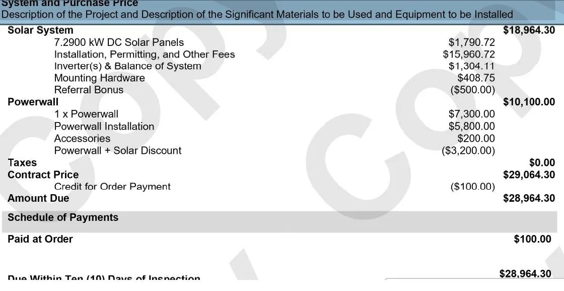

The Universal Wall Connecter was installed yesterday. It cost $663.
The solar panels and Powerwall 3 will be installed in a couple of months. The costs are below. It is eligible for a 30% tax rebate. Tesla will give you an estimate.
