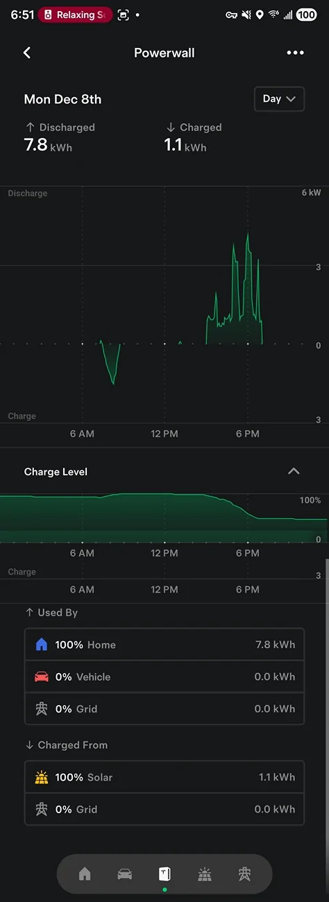

Looking at the information from the Powerwall it doesn't seem to be cycling too bad. I'm not sure if the idea would be that it would be drawing power 24/7?
There's been a few mornings where it's running almost the whole time from midnight to noon. But most days it cycles on for an hour off for an hour or two.

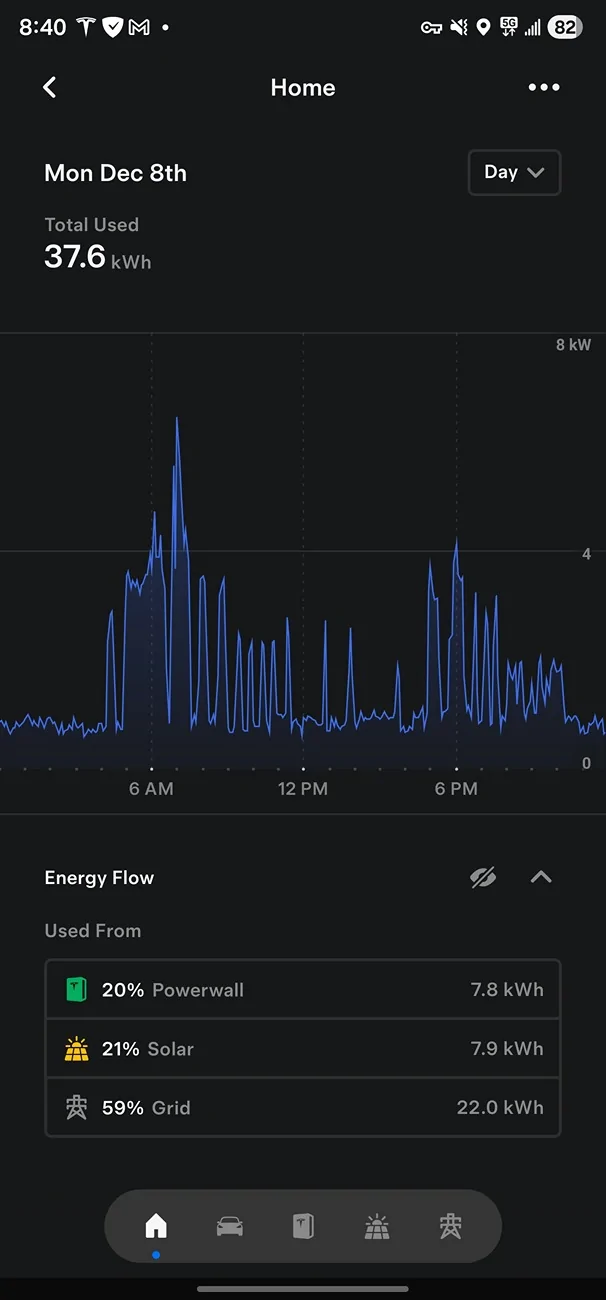

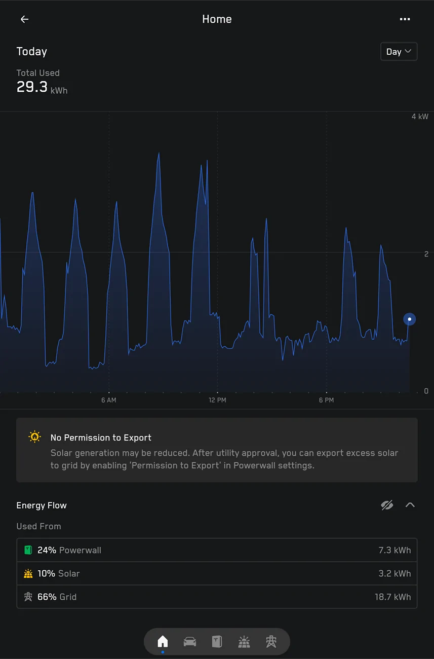

Interesting mine looks like this:
Tesla Cybertruck Does Powerwall 3 support powershare now with no need for gateway? 1000026492
We have winter Peak rates so mine looks like this every day to offset the increased electric pricing in the evenings.
What does it look like when you select the home on the far left icon? That should give you a better idea of when the HVAC is running.
My power wall is currently set up similarly and almost all of the solar. It goes to charging the battery during the day so that the house can draw from it from 3:00 p.m. to midnight when the utility rate is highest. I was just bummed out that there wasn't enough solar to charge the battery and cover what the house is using during the day as well.

Do you think those peaks correspond to he AC is earning question?
Mind you and from what I've read it's not too bad And when it's the coldest mornings then running almost the whole time but on most days and afternoons it's running a little over an hour and then it's off for a little over an hour. I think that's pretty decent so I'm not sure an 18K BTU unit would have been better? I'm still if I were to do it today, I'd get the 18K and spend the three grand on extra insulation.
I still need to check and see if my 24K unit is set to the lowest 50% setting.
I already have the static pressure that's configurable in the thermostat to the lowest setting or most conducive setting when the unit is likely overpowered.
It looked like there was maybe another setting that had the ability to limit the cycles per hour? But again I think I'm OK there because I'm not cycling every five or 10 minutes In some cases it's an hour and a half or so but the compressor/inverter kicking on.
Yeah. The peaks are the heat pump. I have it set 64 at night and then 67 when we wake up. Jumps to 69 when we get home at night and then back to 64 before bed. It's a 5 ton unit which I dialed back to 85% of it's capacity. I started an HVAC LLC and got the unit, a Carrier, myself. Here you can buy scratch and dent Carrier without a dealers license. Paid $5k for a $28k set-up with only minor dents. Knocked most of them out and they look brand new.
