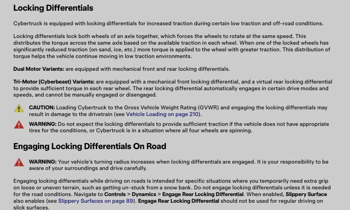

So I pulled this from the owners manual.
Tesla Cybertruck Controls > Dynamics > Slippery Surface - huge improvement for CyberBeast front drive thuds IMG_0241

Beast is mechanical only on the front axle. AWD is mechanical on both axels.
I see that from reading the manual after my post. beast has two motors in rear so why would you want or need a mechanical locker back there? Seams as though the beast would be better off road due to the ability of applying different torque to each rear wheel as needed.
I have yet to take my CT off road. Looking forward to it when I can.

Joshua, you are right that the virtual locker isn't necessarily worse than a mechanical locker, but it depends on them getting the behavior right in the software. Mechanical lockers are more proven and simple. If they get the software right, a virtual locker should perform just as well as a mechanical locker. When the CB was released, the software wasn't ready. It is enabled now and works, but I can't say if it is as good as a mechanical locker because I haven't tested it.
The annoying thud seems to come from the fact that the CB is mostly front wheel drive most of the time. Engaging slippery surface mode shifts some/more power to the rear wheels, which reduces the thud. Maybe some day, the geniuses at Tesla will figure out a way to adjust this through the software automagically.
