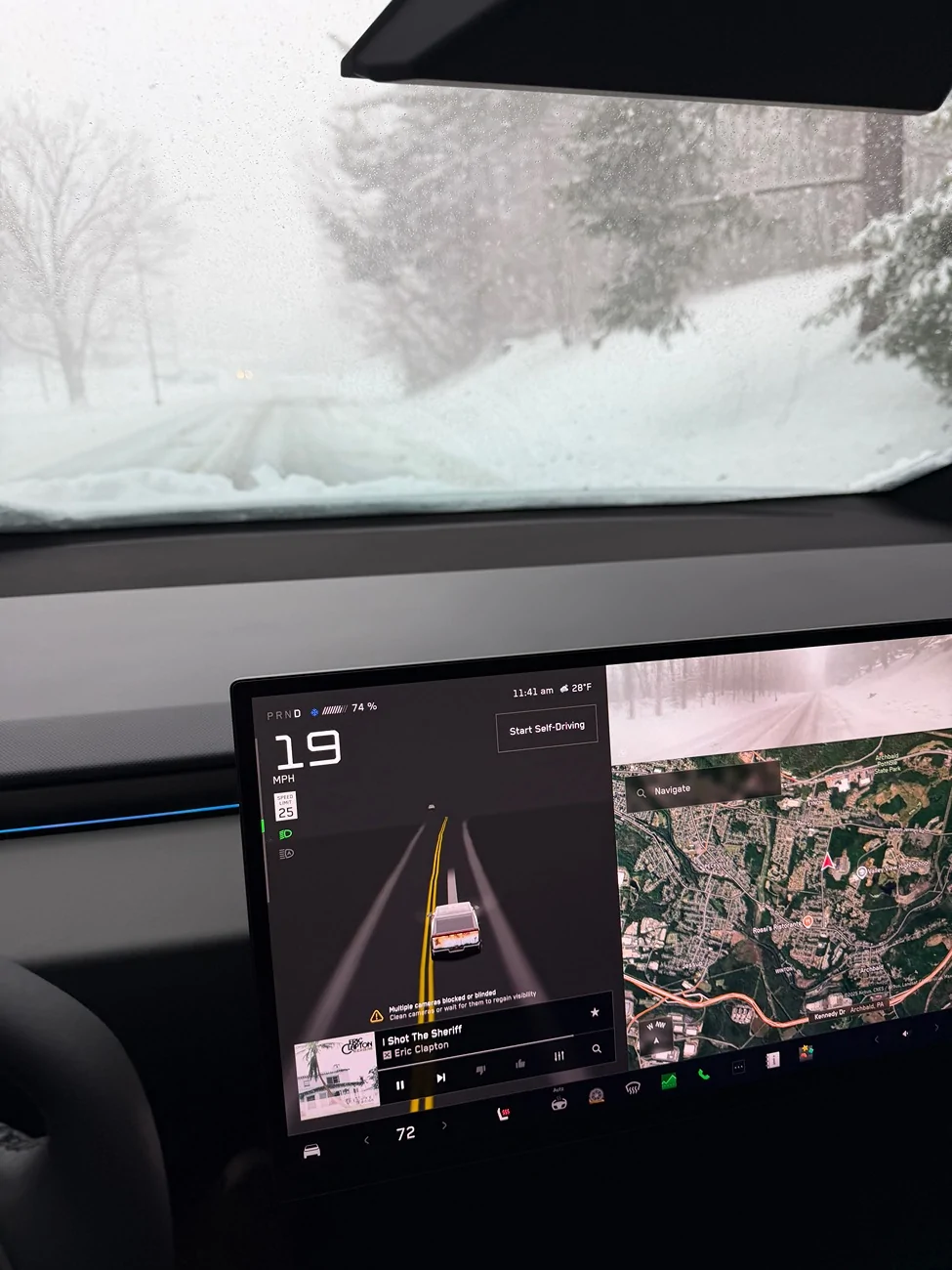

RonSol
Ron
Feb 19, 2020
205
626
Archbald PA
MY LR / CT / 3P
Systems Engineer
This is slippery surface weather. And the OEM Goodyear AT tires to me are not great in the snow. Plows to easily and don’t like to bite while sliding sideways
(on purpose). Nokians are on the way.
