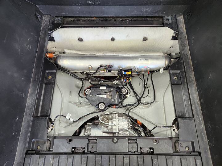

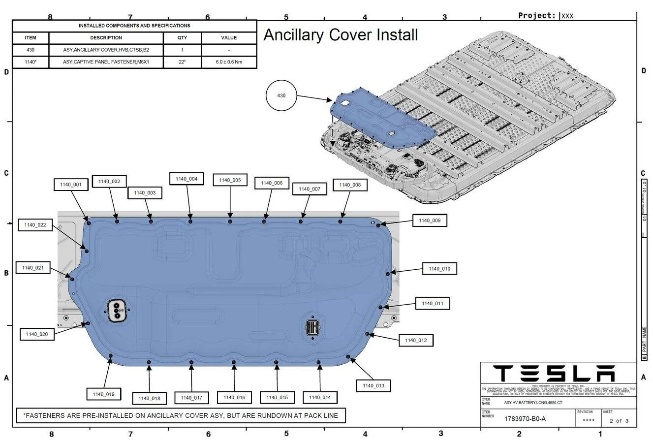

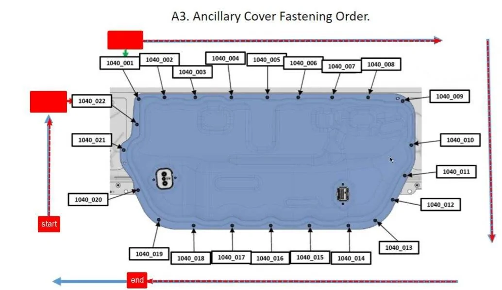

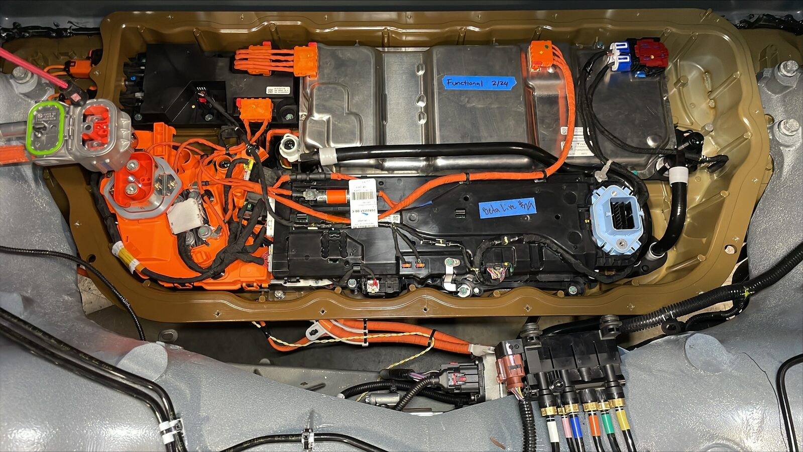

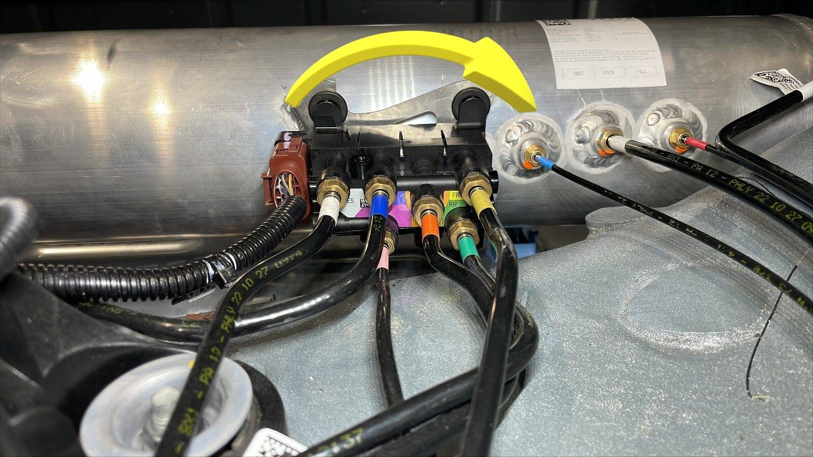

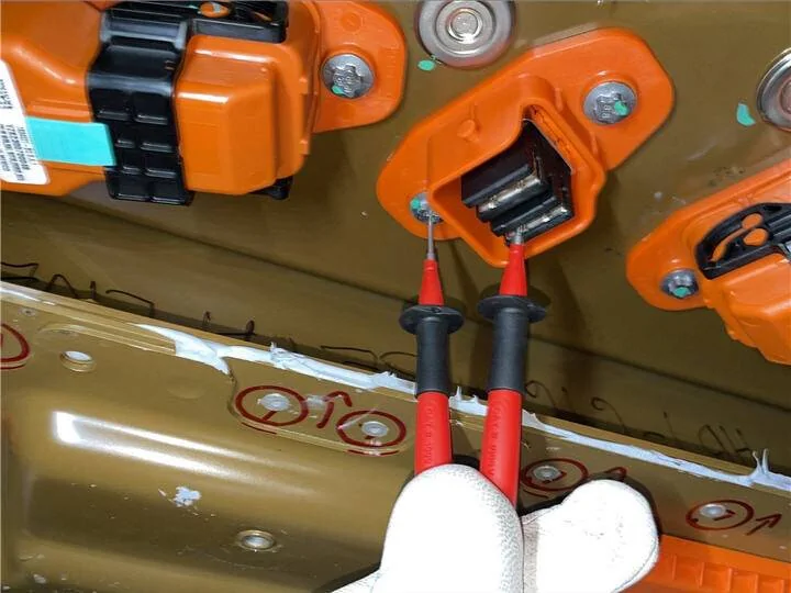

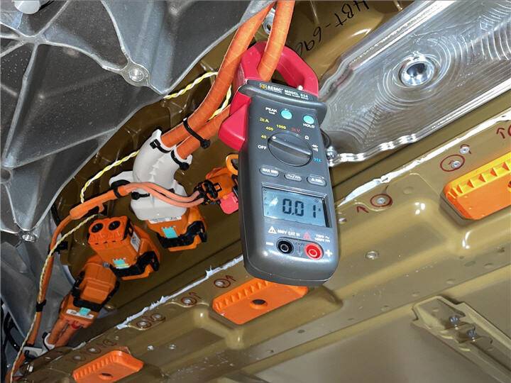

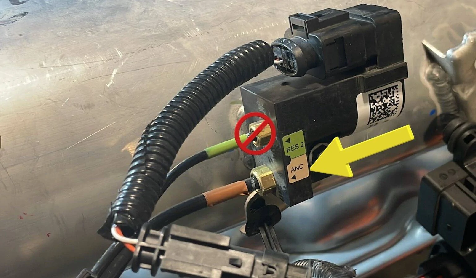

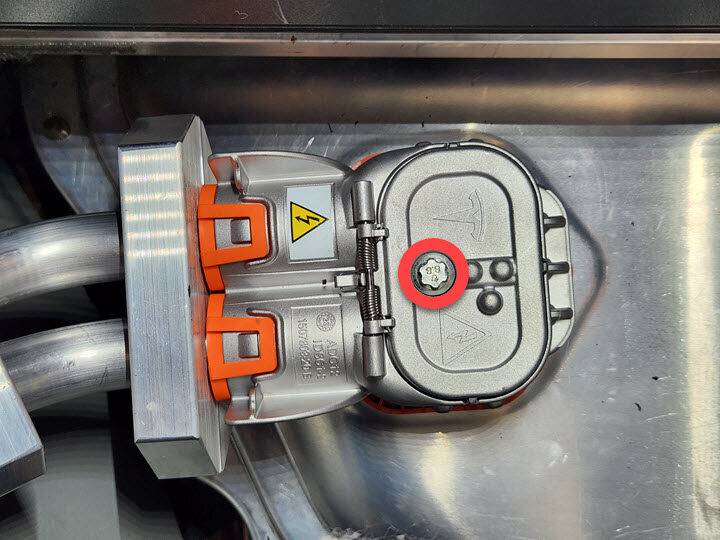

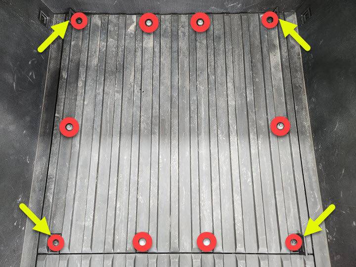

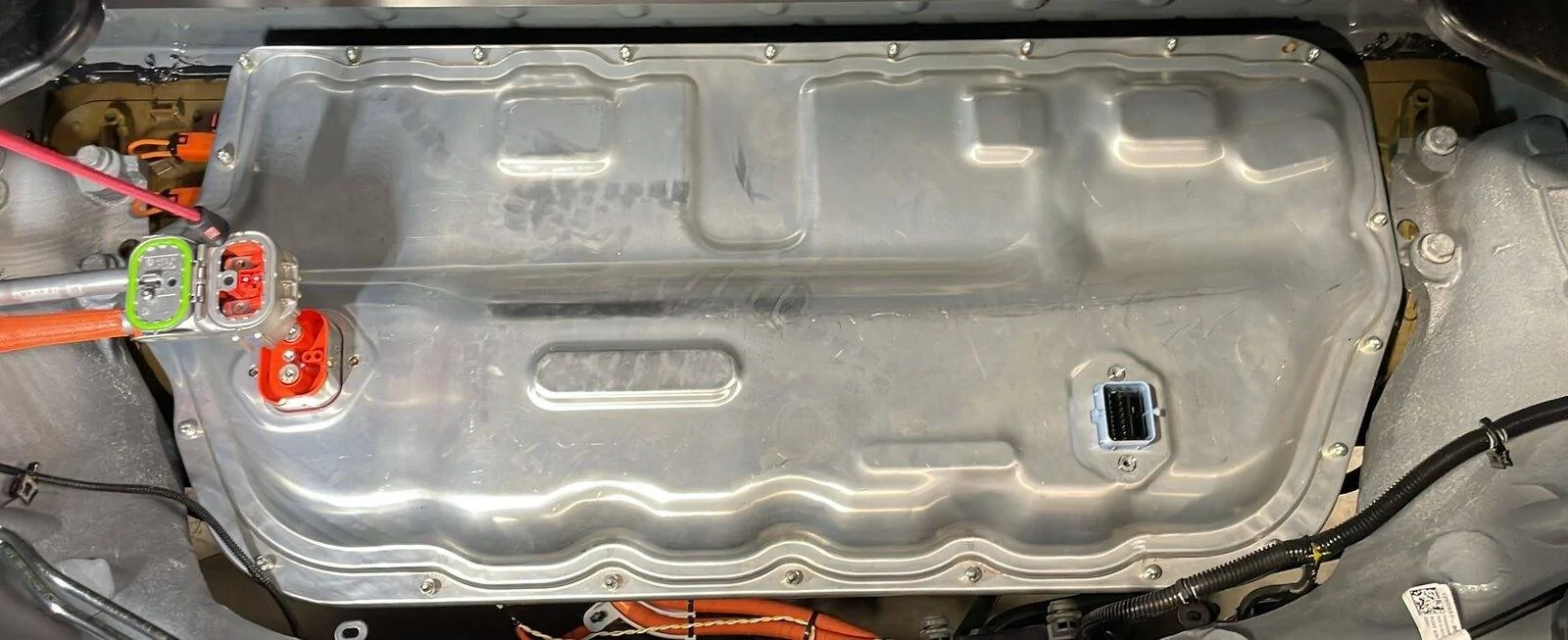

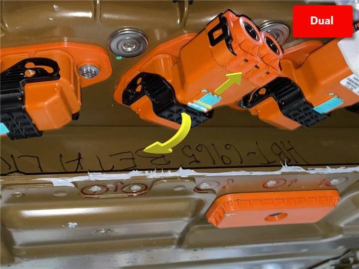

i believe this is the service procedure link for it. Looks like they have to remove the truck bed cover to access it:
https://service.tesla.com/docs/Cybertruck/ServiceManual/en-us/GUID-BB2A9ECD-A09F-4E25-A56D-142B952F3E7F.html#:~:text=screws, T25, 5 Nm Clean all debris from ancillary cover Note During removal of ancillary cover any
