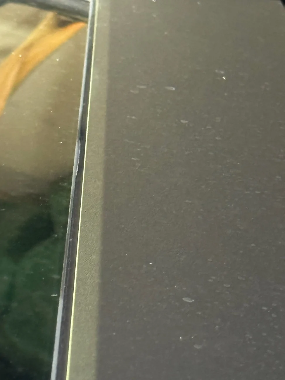

I just went out and took a picture of mine. This is also what I noticed on several other new ones. It is a little hard to see from the picture, but the seal is not laying in there correctly. I haven't had it apart yet, but based on the video, it just seems like it takes some time to do correctly. Maybe that is why they don't want to really deal with it. Both the supervisor and the tech seemed aware of the DIY Youtube fix.

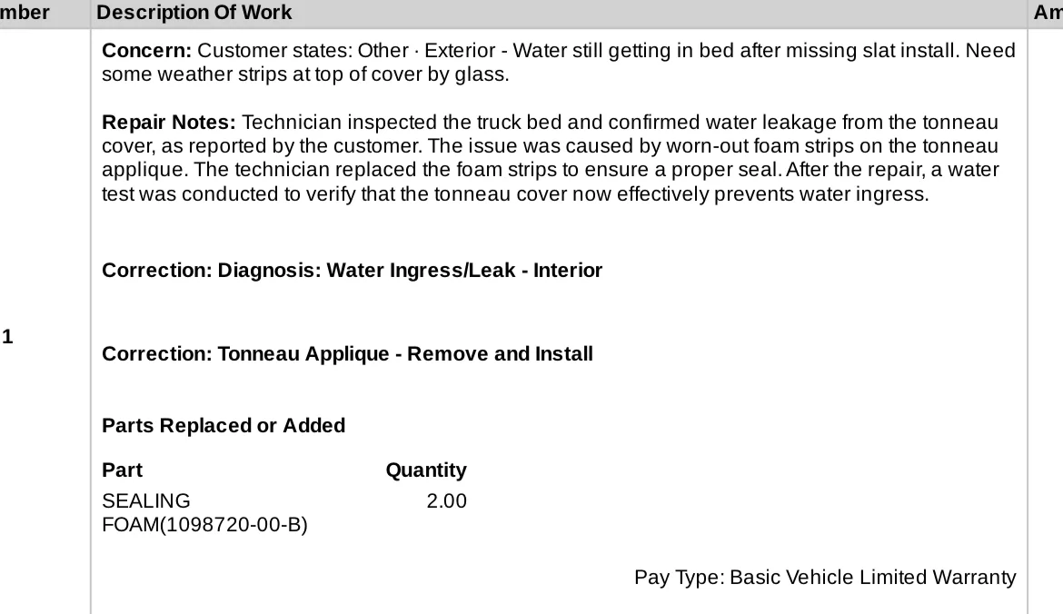

I have no foam strip at all . lol . I mentioned this to SC at the second visit to fix the leak There is only a rubber strip along the removable piece.
This is my invoice:

This is my invoice:
I wonder if this part of the vehicle's assembly, when in stalled to spec, works really well. But the actual process of installing it makes it very difficult to install to spec.
"Worn-out" foam strips is just silly when you are talking about a new vehicle. "A water test was conducted", lol, mine said that too. Must of been testing with water mist.
Is that seal attached to the window glass or the removable appliqué

If you watch this video and jump to about 6:55 you can see it is part of the removable appliqué
I have the seal on removal appliqué but absolutely nothing on the window side . So that’s the problem my guess .
