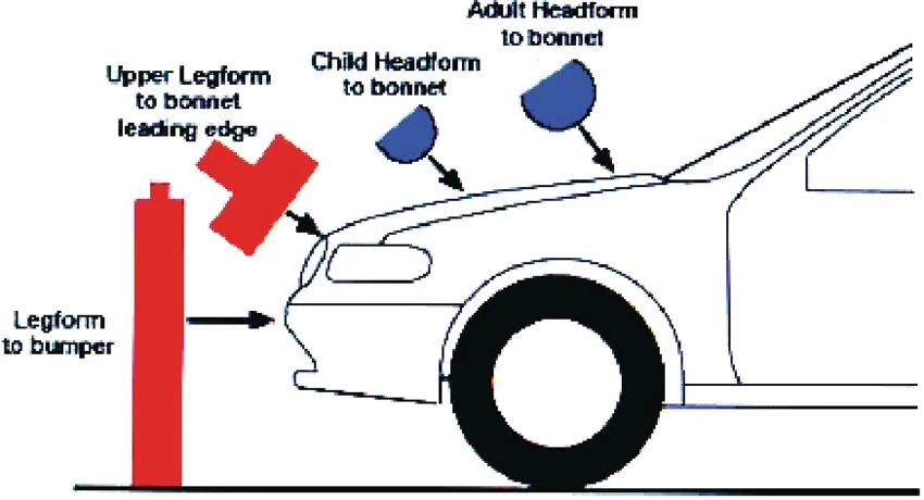

Sure, anything can kill a pedestrian - a fall from standing height can do lethal damage.
But you can calculate the chance of the damage, and it will be different. Materials that give before bones break can accelerate the pedestrian with a lower chance of lethal shock. Which is why bumpers and hoods that dent before bones break are required in the EU regulations.
But probably more importantly is avoiding the accident by having increased forward vision from the cameras, and the ADAS warnings and braking you get from FSD even in its supervised form. No collisions is the ultimate goal.
Still, the fact that the truck normally rides lower than other trucks - especially ones with the same clearance - means it's more likely to throw an impacted pedestrian up or to the side than under the wheels. And that, I think, is more important than soft materials.
Has some European safety group actually tested the Cybertruck for pedestrian safety or is everyone just guessing that it wouldn't pass the tests in Europe? I cannot seem to find any actual test having been done and the Cybertruck failing said test. If Tesla hasn't submitted the truck for testing it could simply be that they aren't concerned about selling in Europe yet so no need to spend the $ to test yet as opposed to any real flaw in the design that would prevent it from passing. I'm just wondering where all this pedestrian flack is coming from, do you know?
Tesla has acknowledge it wouldn't pass the European safety test. They are pretty crazy. This is a page from the requirements.
Tesla Cybertruck Cybertruck gets FIVE STAR safety rating from NHTSA ⭐️⭐️⭐️⭐️⭐️ 1740061951009-1t
I think Wes or Franz once said at minimum bumpers would need to be installed on the edges or potentially rounding the corners.
Then how do Dodge Ram and other pickups pass this test?

Here it is: 3.2mm external radius on any protruding features
So then a bunch of 3.2mm radius rubber strips stuck around the Cybertruck should do the trick, surely one of those aftermarket companies is working on just such a kit... ??
...If it's rated as a commercial vehicle, there is no test or limits. But as a privately operated passenger vehicle...
The regulations require a soft material for the nose of passenger vehicles, which the Cybertruck does not have at all, and a set angle for the nose of the vehicle, which it also straight up fails.
Compare the nose of the new ID.Buzz's slant vs the slant of the nose of the Cybertruck: That's why the Buzz has that slightly more set back nose than the concept.
You could also just coin the edges of the non-adjoining panels, too. Only four panels and the frunk have corners that face outward. You'd barely notice the difference.
And that's on top of needing yellow signals and probably headlight washers (if any one light array is brighter than 2000 lumen) and other small differences.
They're imported as either one-offs or commercial vehicles.
