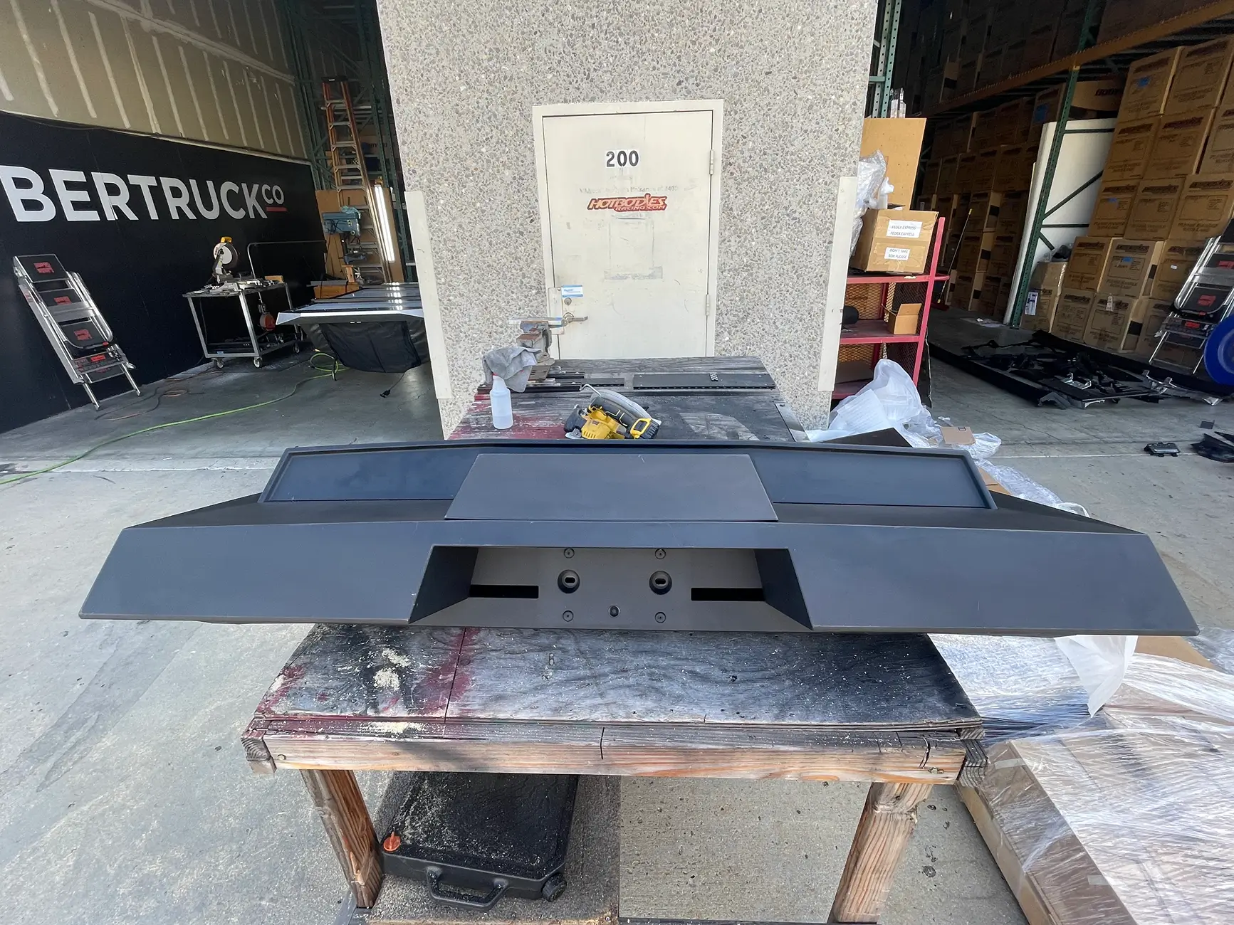

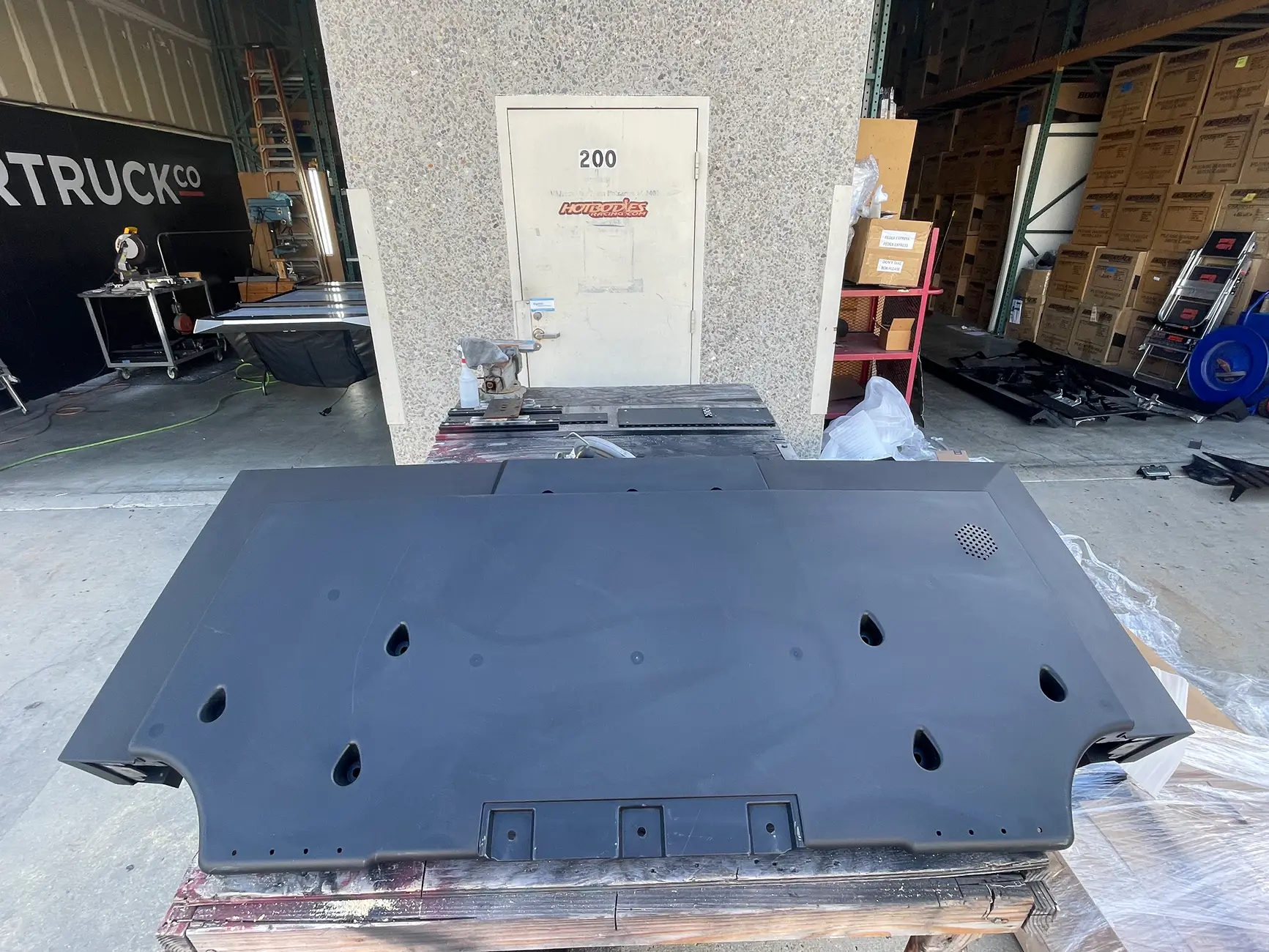

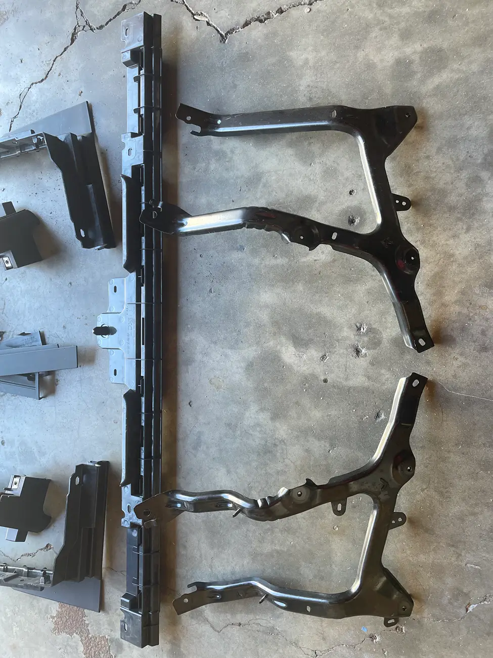

The OEM bumper and all components are what I have sitting in my shop.

Part of the OEM bumper includes aluminum crumple zones. These things are probably what you damaged on your CT. They are so malleable it is crazy. They are almost like aluminum cans. There are hard plastic crumple zones and the aluminum pieces WILL crumple before the hard plastic cracks.
