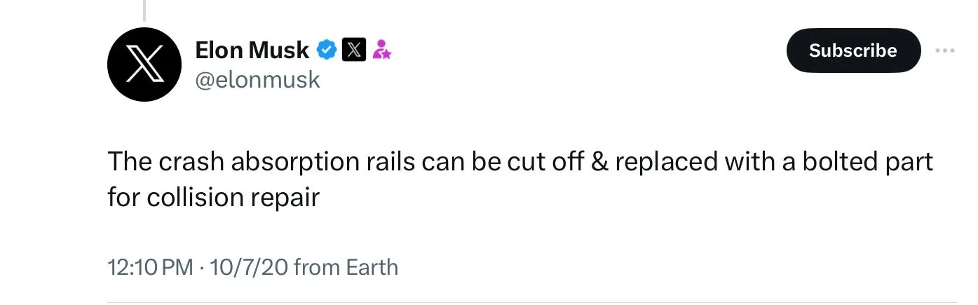

Link to videos below. First off, Tesla isn’t using a generic aluminum, and with the gigacasting, the possibility of cracking is greatly reduced. He mentions he spoke with a supposed expert and the recommendation for THIS type of aluminum when cracked, is to weld it. One of the things he points out is the crush zone surrounding the casting. Before the impact gets to the casting, there are body parts to protect it. And he makes the comment that a standard unibody (sans castings) is more likely to be written off than a Tesla, because a unibody spreads the impact out in areas that may make the vehicle unrepairable. In another interview I saw, Tesla was talking about how their design team works WITH the production team AND the repair team when they are designing the vehicle. So when the vehicle rolls off the line, they already have an idea of how to fix it.
Then we have Elon’s tweet. He directly says you cut the bad part off (using a Tesla supplied jig) and bold the new piece on.
The last is Sandy (and a sledge hammer) showing the difference between welded steel and a casting. It certainly is eye opening.
I think the take away from all this is that there is a whole lot of FUD about the gigacasts, and that is being stoked by detractors, when the truth is, it is safer. And in the long run, that is ALL that matters.

Maybe you guys missed this from the horses mouth:
