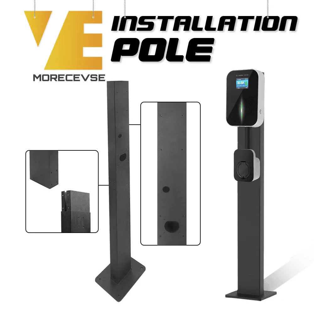

I am looking at getting an EV charger installed before the truck shows up. My house setup is odd so I need to run about 150' of cable and mount the charger to a pedestal installed at the corner of my front garden bed by the driveway. Has anyone looked at pedestals? Any recommendations? It seems I should be able to find one for under $200 but most of what I see is $700+

Cheap level 1 EVSEs cost $200. Why do you think you ought to be able to find a weather-hardened stand-alone Level 2 for that?
I'm just talking about something to mount the wall connector to. It is only a square steel box or pole I can secure to the ground. I forgot about the Tesla pedestal. That may be my best option.
I would really like something I can mount two chargers on since I will eventually have the CT and a Model Y. Maybe I can pull extra wire and fabricate a mounting plate.
