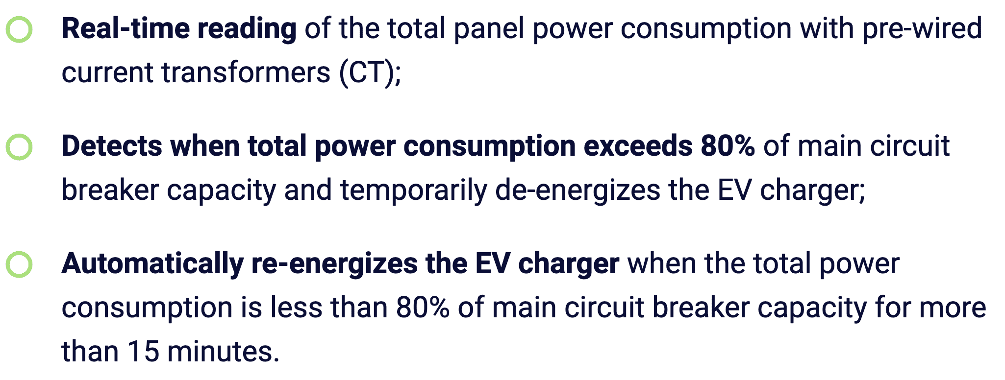

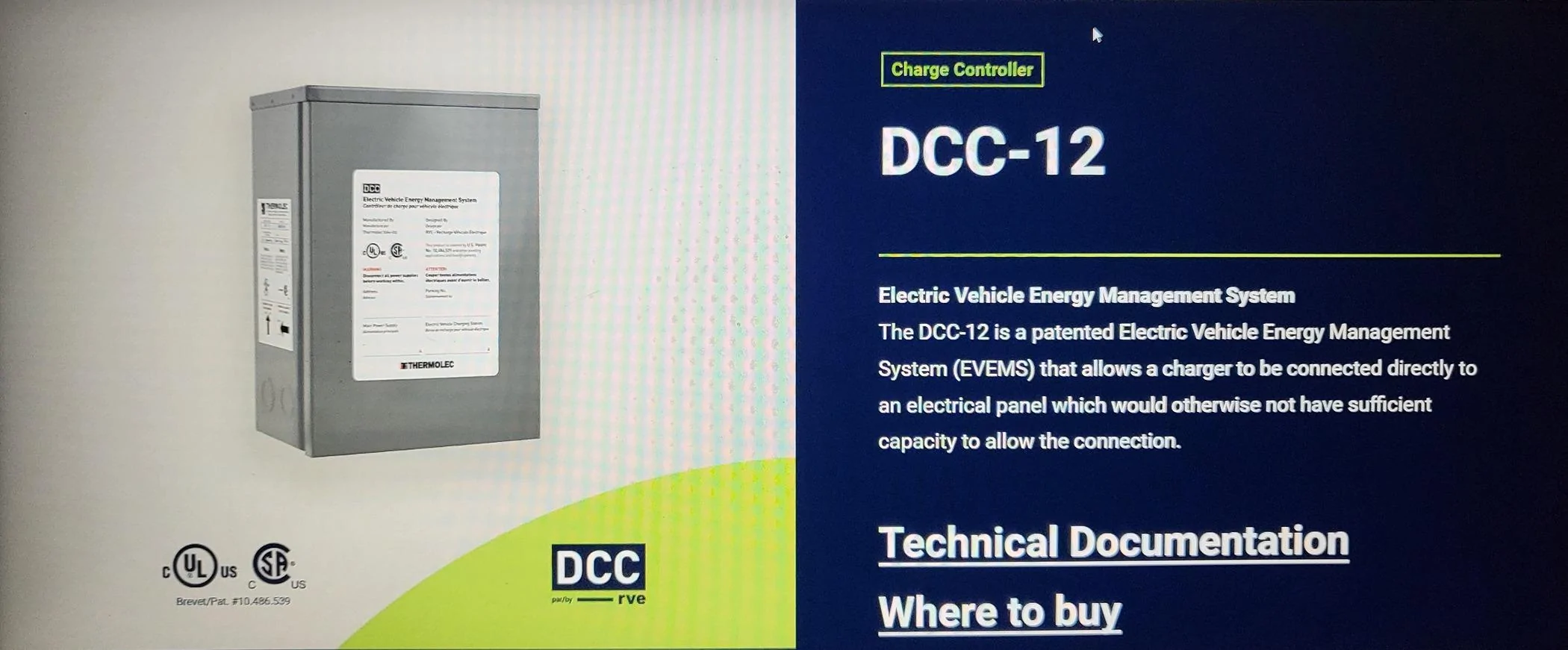

I have a contractor that wants to install this on my 2 powerwall, gateway, solar system in order to connect my Wall Charger. Has anyone seen this and had this done? According to Tesla it's not a part they spec and would be connecting the Wall Charger directly to subpanel of gateway. Any help would be appreciated.

Seems like your electrician believes your main panel cannot support another 60A load.
Of course, I doubt this works with a bi-directional setup like PowerShare.
