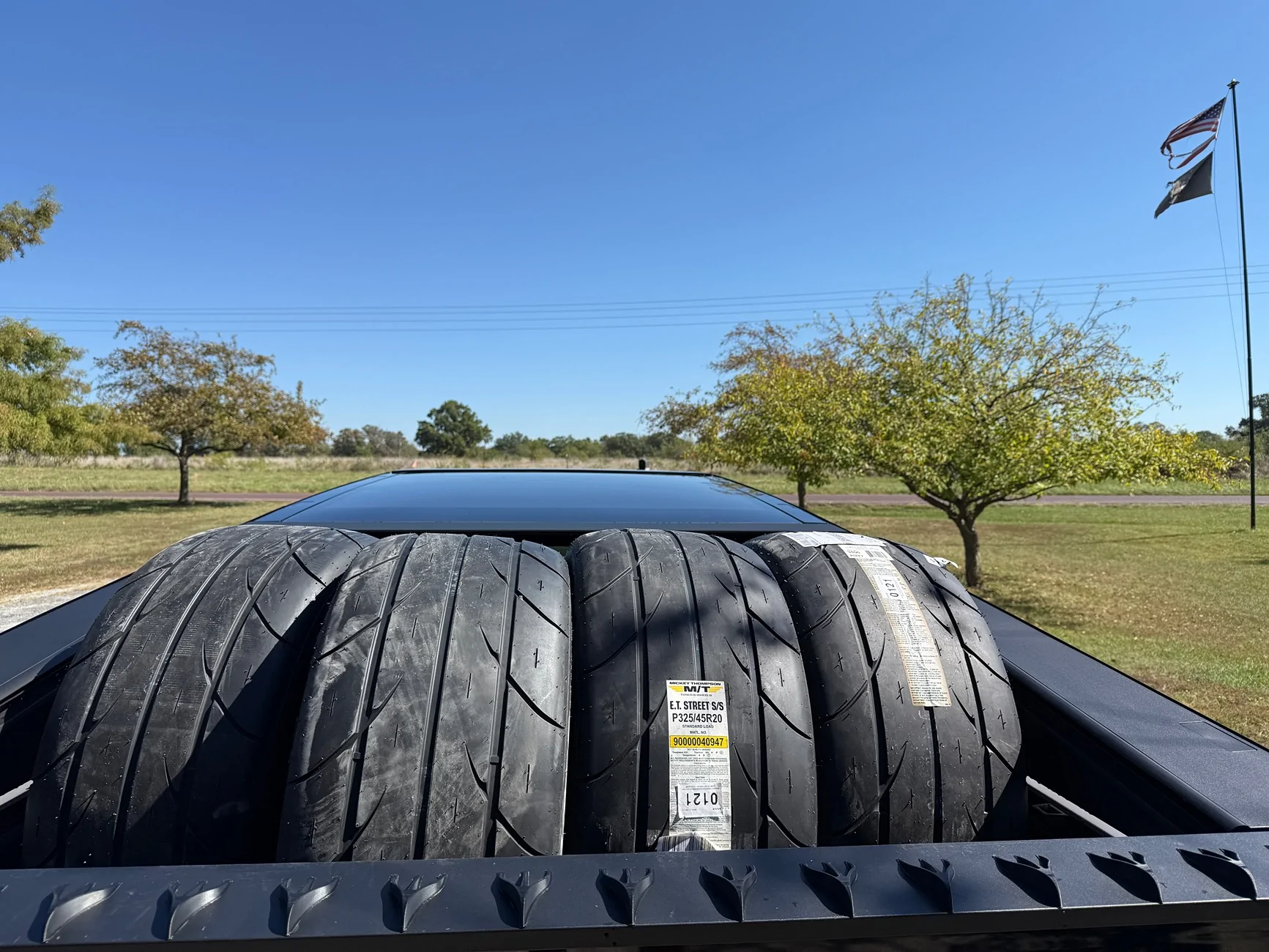

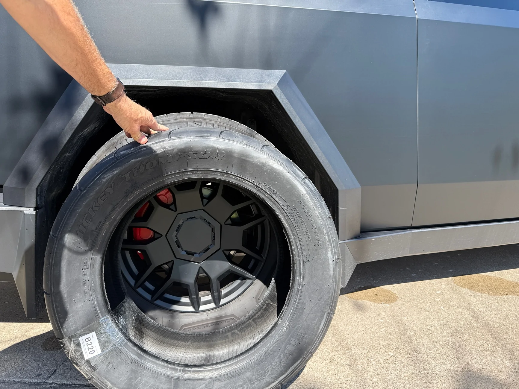

New tires just arrived! Now just have to wait until Monday for the wheels to get here, then the next test n tune at the strip.

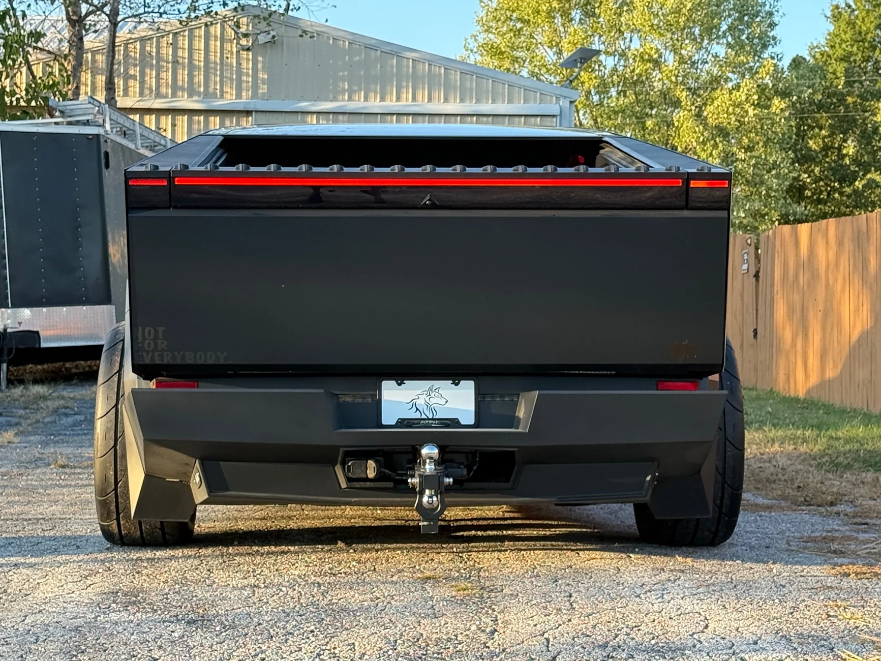

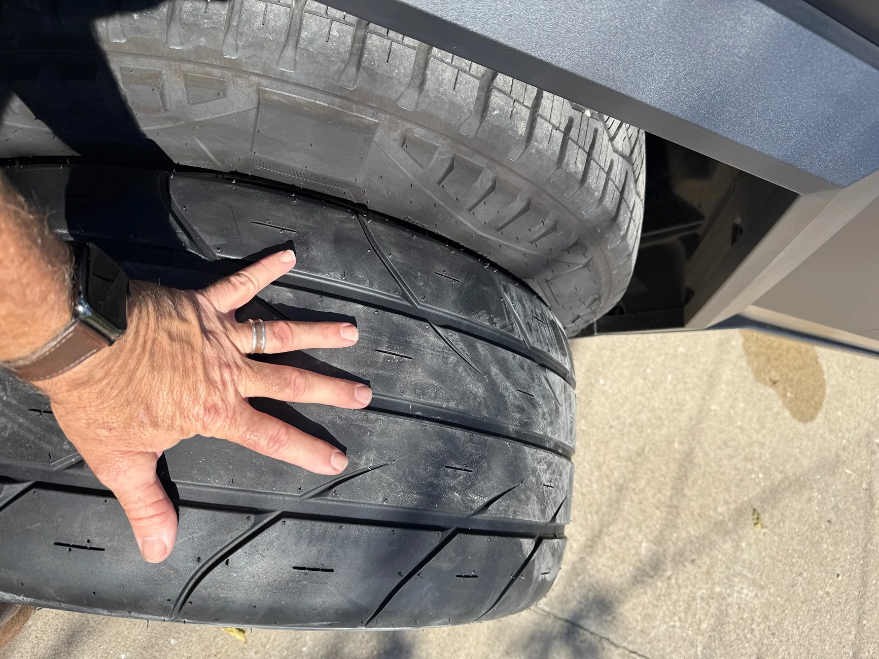

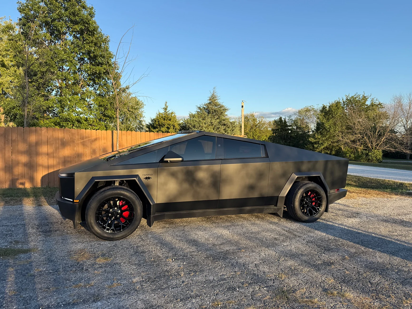

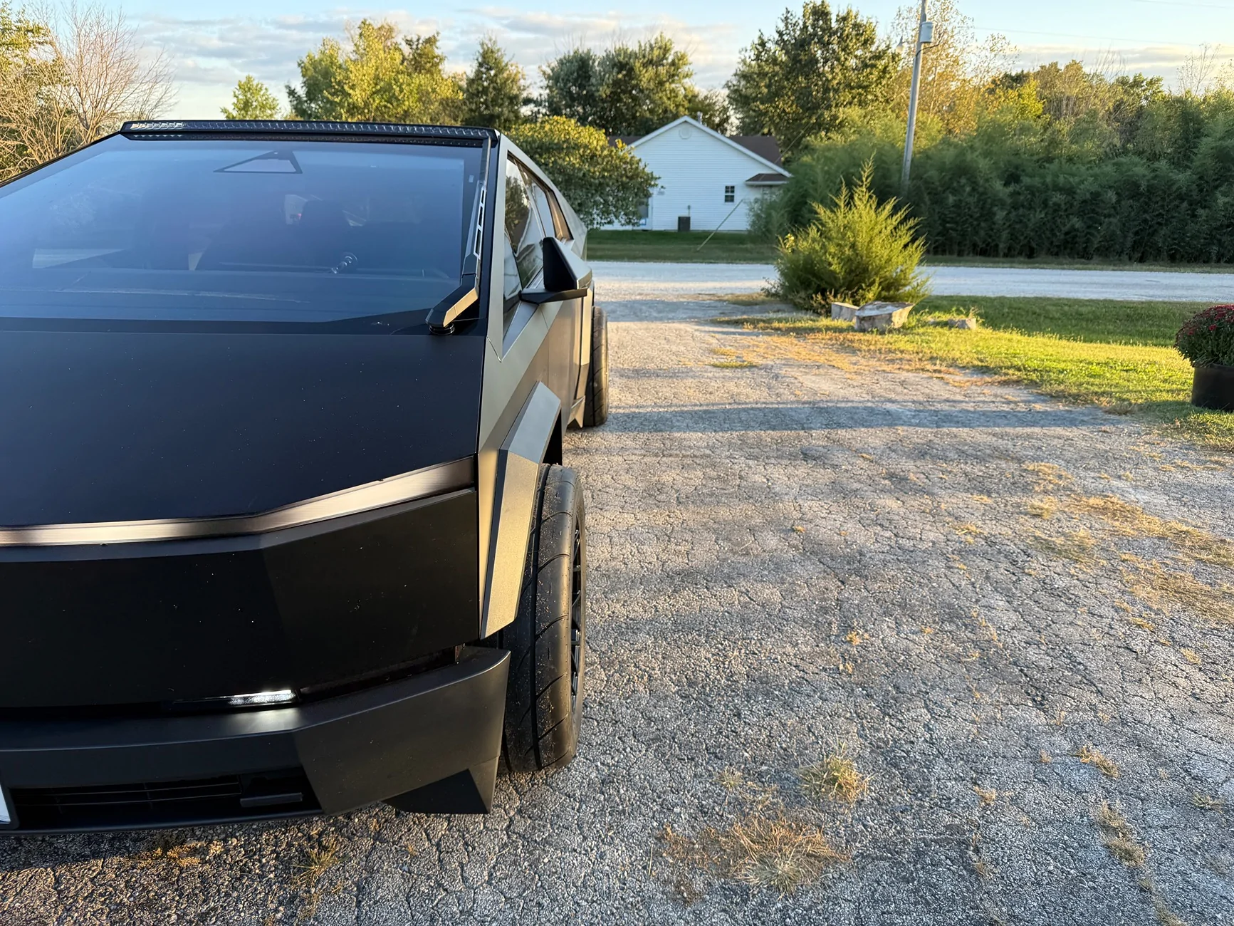

Here they are on the truck, a bit more poke thank I wanted but for the price of the wheel I’ll take what I can get while experimenting. Defiantly snappier just on the road but I’m worried the speed li
Tesla Cybertruck Drag race time from Flying H Drag Strip IMG_9824
miter is going to actually make it a
Slower 1/4 mph. The Tesla service manager never did get me an answer if I can just bu
Tesla Cybertruck Drag race time from Flying H Drag Strip IMG_9825
y a subscription to Toolbox and adjust the tire height that way. Thursday evening is the next Test-n-tune night so won’t have to wait long to find out !

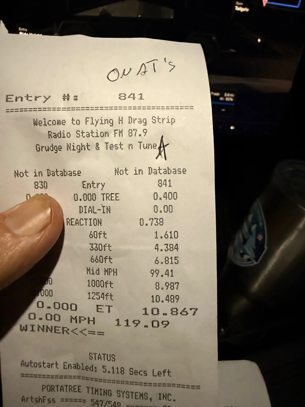

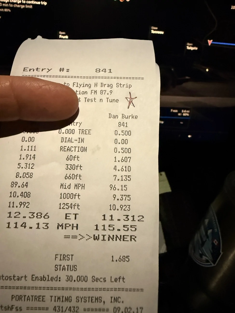

Final update, it’s slower on the drag radials than on just the factory AT’s . I did get a response from Wes Morell saying there is no way to adjust for tire size besides what’s on the service screen under wheel &tire. I tried all 3 settings, launching in Baja with traction control off and in beast mode launch mode. The truck seems to think there is wheel spin due to the smaller diameter and you can feel it back out of acceleration then pick back up. Fortunately I have another truck to run the drag radials on so they’ll be put to good use.
