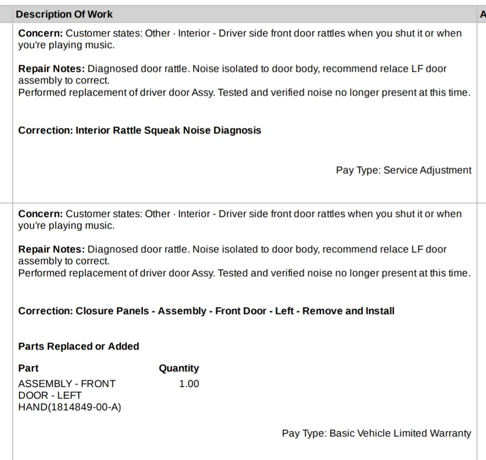

Here you go, this was my driver's door making a rattling noise
