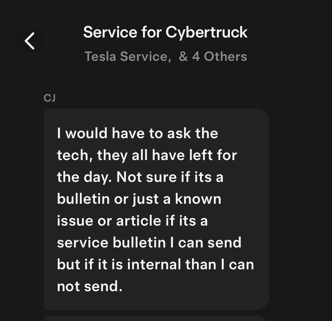

Brought mine to service center for complaint of vibrating door at high speeds. There is now a Tesla service bulletin apparently and they are ordering a bracket (that broke off?) to install end of January.
Please post bulletin
