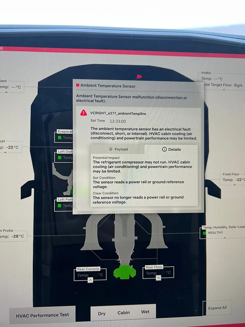

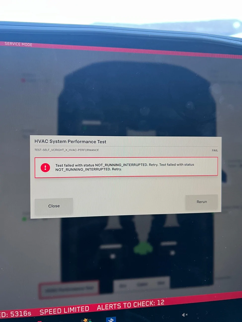

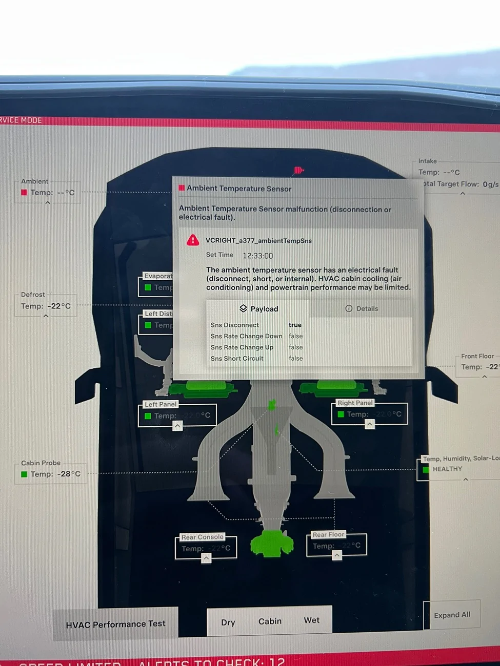

I made sure all doors closed, started service and ran the hvac test w a failure. It’s -40f out and -23f in the cabin.
Would driving to supercharge from 86%-100 possibly thaw out the system?
Or do I need anchorage service visit?

My neighbor was kind enough to allow me to park inside for 4 hours!
I was not too happy when the app climate control sequence was failing like before, I then walked over and inside using the screen I was astonished to hear and feel somewhat room temperature air venting! Cranked it to high and out 5 miles on the back roads just to get it all moving!
