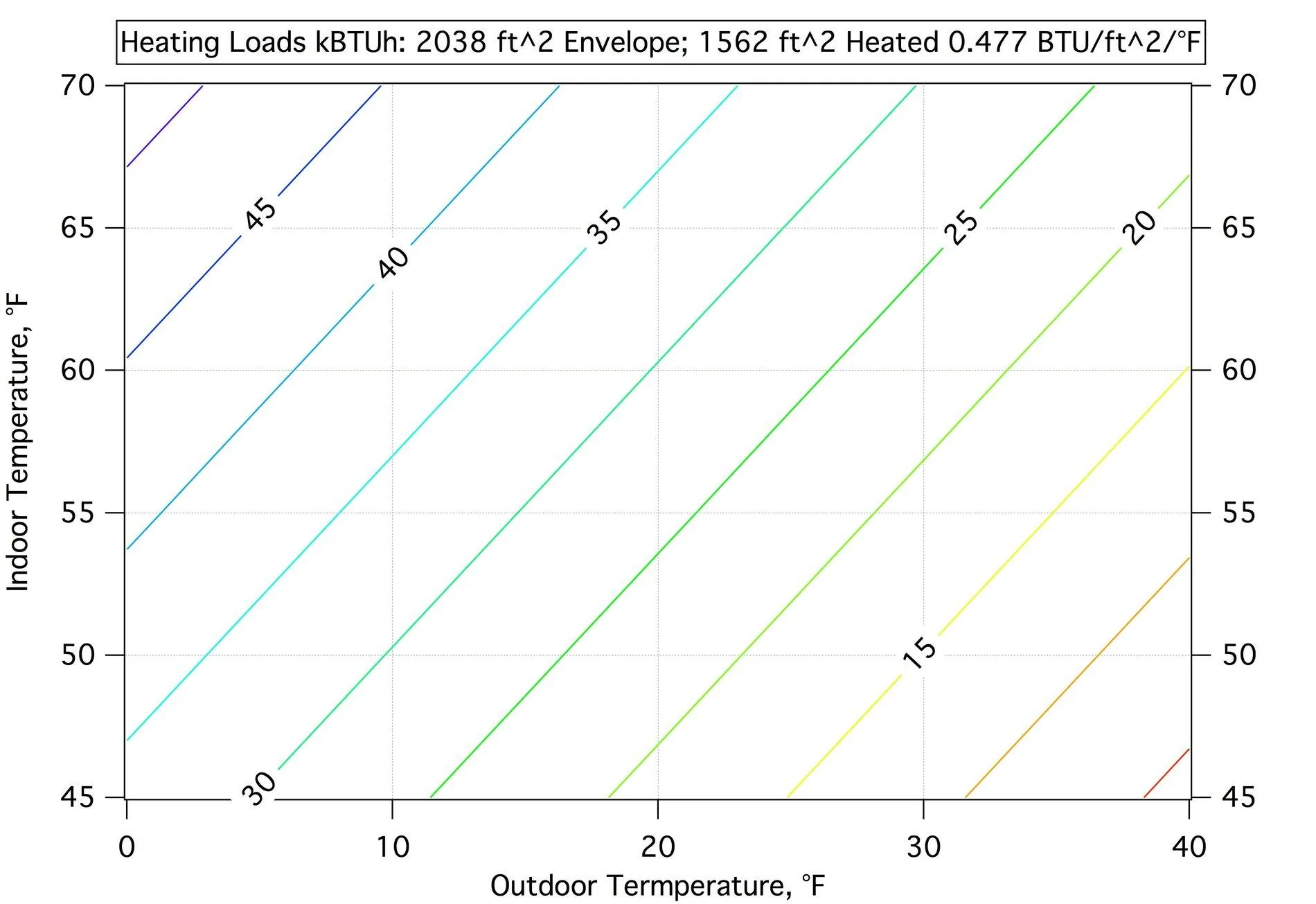

I'll explain briefly how the wise man sizes his heating system and then relate that to how long a properly sized heating system can be run on 5 Powerwalls. As an example I'll use the project I am doing now which is a 2000 ft^2 garage/storage/workshop building with about 3/4 of that heated space. We start with a Manual J calculation which shows the building leaks 0.477 BTUh per square foot per degree rise. This quickly leads to a diagram like this one which shows heating load against inside and outside air temperatures:
Tesla Cybertruck EV sales have doubled. Is a ‘tidal wave’ coming? kBTUhLoads
Obviously one should size for the coldest parts of the year during which time, in my area temperatures tend to hover around freezing during the day and dip below that at night. 0 is seldom reached but 10 °F is not that uncommon (5 days a year at night) nor is 15 °F (10 da/yr) so it's clear that a 45 kBtuh system is a good choice. During the daytime when the temperatures are around 30 °F it would run at about 50% duty cycle (of course the modern ones don't do "duty cycle" as such - they adjust motor speed to move more or less refrigerant per hour). Now one can, of course, spend a lot more time on thinking about say a 40 kBTU system with E-heat etc but that gets into additional analysis which probably isn't necessary. I chose 47 kBTU total split pack heat pumps (with propane backup).

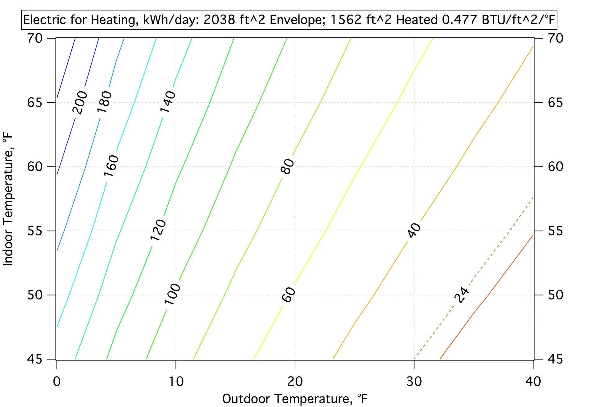

The electric load required to supply the heat is easily calculated:
Tesla Cybertruck EV sales have doubled. Is a ‘tidal wave’ coming? kWhdaLoads
The only comments I'll make on this are that the curves are steeper at the left side of the plot than on the right because COP falls off as the outside temperature drops. The other comment is on the 24 kWh/da dotted curve. I stuck that in there because that is the power I am estimating that I will have available in December (the building has no grid connection). I am using this as a garage and so 50 °F for the indoor setting is fine and I'll be able to maintain that as long as the outdoor temperature is above 30 and when it isn't I can shut off heating to some of the areas (storage) and/or heat them with the E-heat system. Looking forward to collecting some data on this system this winter!

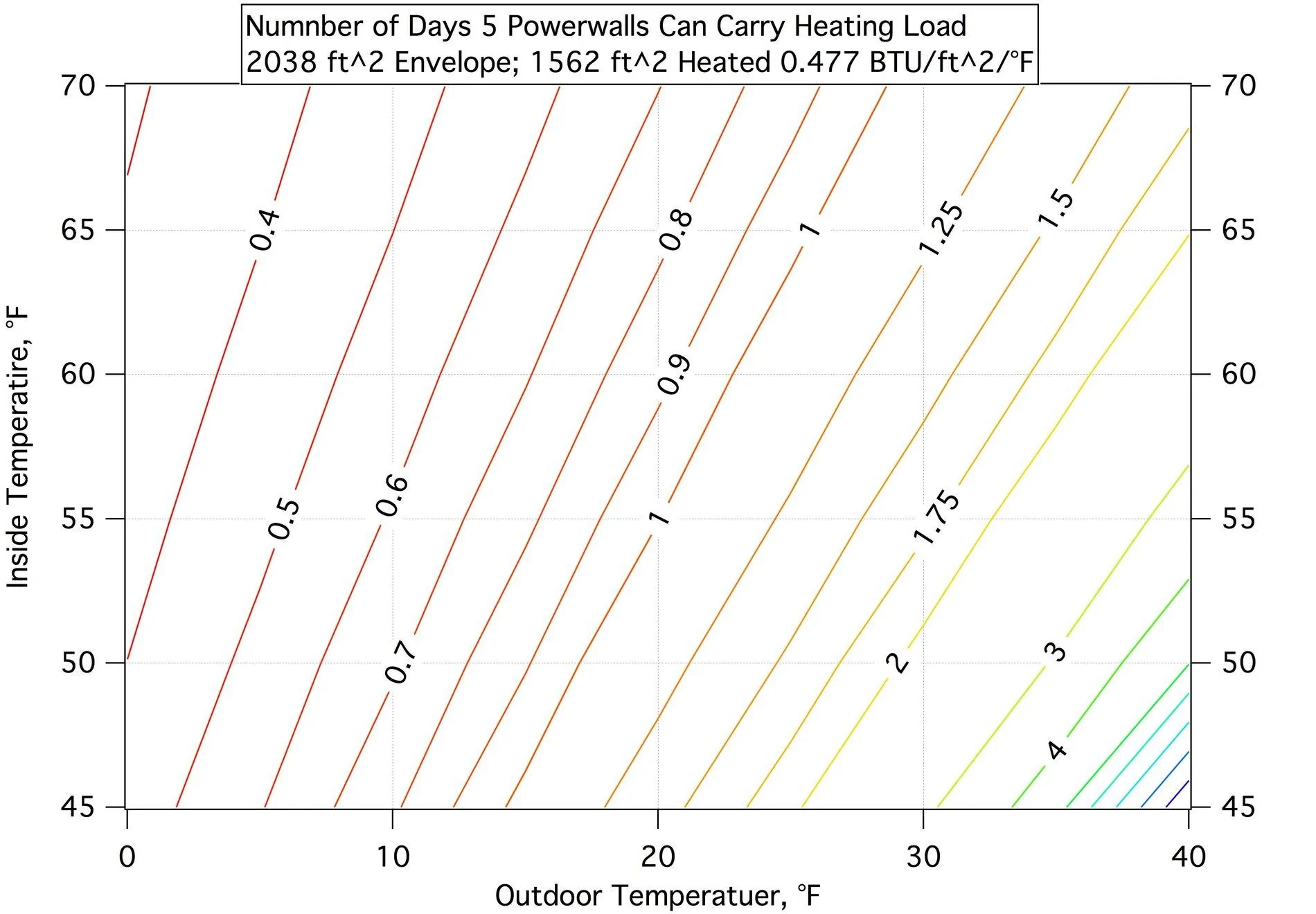

Final step gets to the question which I think is at the heart of this particular diversion to the main thread: how long could 5 Powerwalls run this heating system in the event of an extended outage. That's easily calculated knowing how much energy a Powerwall stores which is 13.5 kWh.
Tesla Cybertruck EV sales have doubled. Is a ‘tidal wave’ coming? DaysLoad
This chart is clearly bad news for those who fancy that they can run even a small house in Zone 3, 4 or 5 for days on a couple of Powerwalls. But for me it is really good news. I can set all the thermostats for 50 °F and as long as the temperature stays above freezing run forever on solar even if the sun goes in for 3 days. But of course I wouldn't do that if I knew a cold snap was on the way. I'd set some of the rooms to 45 or even 40 and pick up a day right there.
Now of course the same strategies apply to someone in a residence of this size. They would have 1.25 days coverage if they set the themostats to 65 °F rather than 70° F at 30 °F outside. Some may live in warmer climates and it may be possible to get load coefficients down to less than 0.477. Clearly if that can be halved, the times would double.
If there is an overall message here it's DO THE ENGINEERING. Modern HVAC systems, especially when integrated with solar and battery, are very complicated systems and if you skip the systems engineering you will likely get a result that is not as effective as it could be. The last four times I've had systems put in they would have been very disappointing had I accepted what the contractors proposed.

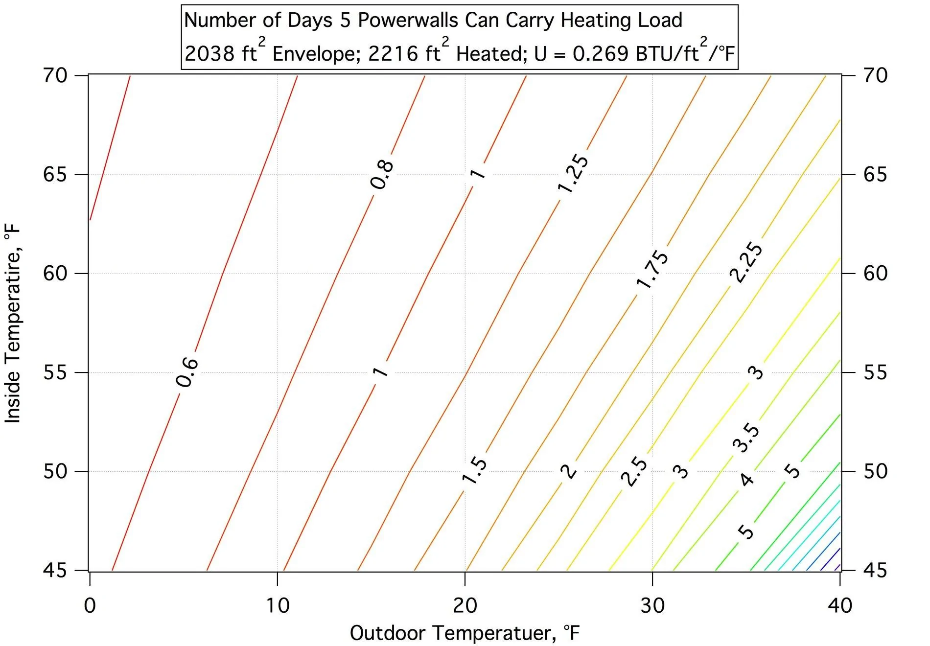

I hope at least a couple of people have found this interesting. To the others I apologize.

What we learned is that the garage/storage/workshop building that you are using as an example is not particularly well insulated
Actually it is quite well insulated (U = .257)
...and you have done the calculations for weather that that is far from average for zone 3.
Anyone who knows anything at all about how to size an HVAC system understands that this is exactly what one is supposed to do.
It looks like you are not familiar with well-insulated structures that are designed to be heated with minimum losses.
Familiar enough to know how to run a Manual J and direct a contractor as to where to beef up the insulation to get me the U value I need and to direct the HVAC people as to what equipment to install.
Your calculations show how things were done in a world of cheap and easy fossil fuel.
Wrong there too. My calculations are done per ACCA recommendations using current ACCA databases for my region. Though I must say that this discourse has caused me to look into this in much greater depth than I had at the outset.
Well-insulated houses can reduce heat loss by 500% or more.
Relative to what? What range of U (BTUh/ft^2/°) are you claiming?
Seems that what we have learned is that you haven't learned a thing from this discourse and that your understanding of HVAC is very limited.
But I have learned a great deal and so I am grateful for the dialogue. I have gone back and looked at the drawings for the garage project much more closely than I had previously and analyzed IAD weather data to a much greater extent than I ever have before. I am now quite confident that my neighbors will not be hearing my backup generator as much as I had previously feared.
