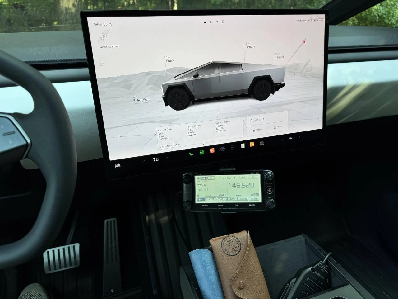

I'm running an ICOM ID-5100 with the detachable head mounted (suction cup mount) under the Cybertruck's screen. Mic just rests in one of the center console charging bays. Antenna is a Tram Browning 1191 Through-Glass unit (instantly solves the question of how to route coax into the cabin; and works better than I expected).
Tesla Cybertruck Exquisite Cybertruck_ID-5100
Here I'm up in the Blue Ridge Mountains, hitting our local 2m repeater 28 miles away.
Tesla Cybertruck Exquisite L5001269-SEP032

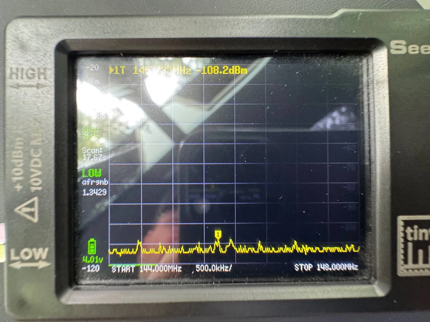

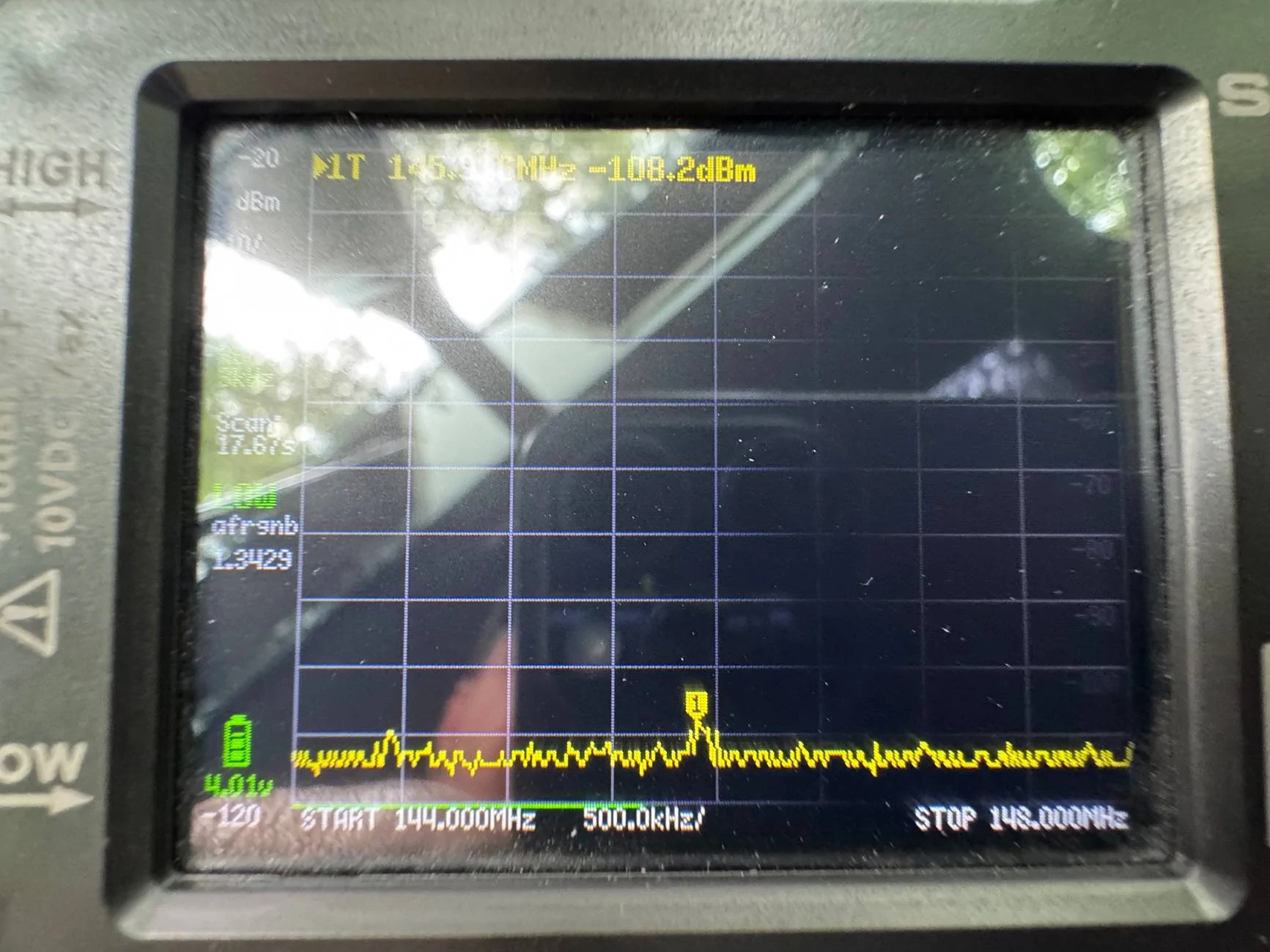

Well, I went out and spent some time with my little TinySA Ultra, poking around the truck. I've confirmed that my little switching supply isn't the problem. Unfortunately, it appears to be the inverter for the interior plugs that is causing the noise. Here's a photo of the waterfall on the SA:
Tesla Cybertruck Exquisite Inverter Noise
You can see that the display was clean, then the noise appeared when I switched on the 120V sockets from the touchscreen. No load on the sockets and my switching supply was not connected. The noise is heard on some frequencies, but not others. Unfortunately one of the local repeaters is impacted. I grabbed the LFP battery I have for portable operations and used that to power the radio. The repeater sounded fine. So it certainly looks like there is some noise from the 120 V cabin power inverter.
I scanned around on lower frequencies and except for a few spots on 10 meters, it looked pretty good. So 15 meters through to 80 look like they will be OK to use the 120 V sockets. I haven't gone to any serious effort to look for noise with the SA when in motion, but confirmed that the VHF repeaters are apparently fine. I have a feeling that they put their efforts into RFI suppression for the driveline but didn't spend enough time with the power socket system.

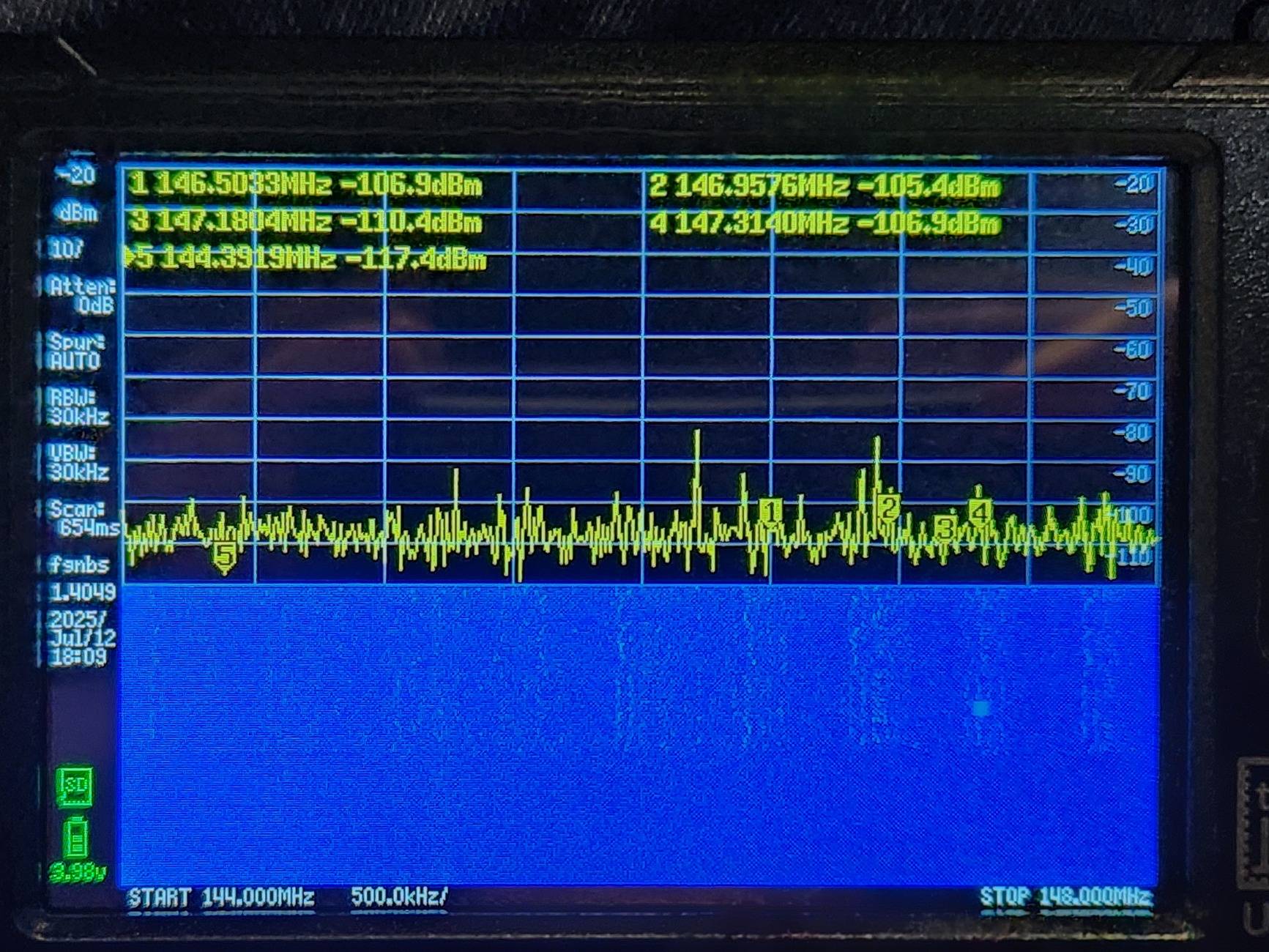

Brock, I'm honestly not seeing a meaningful increase in noise from the SA print that you posted. Looks to me like you've got a noise floor of around -108 dBm whether your Cybertruck outlets are active or not. The right-hand half of your print shows a bit more (very weak signal) activity in the waterfall, but you're looking at a different part of the spectrum at that point and those might - probably - were legitimate signals, albeit very weak ones.
You did make me curious, though. So I took my TinySA out to my truck and pulled two quick sweeps inside the cabin... first with the outlets turned off; second with them turned on. (apologies for the crappy images - my TinySA can't capture screenshots like your Ultra can).
I scanned the same 144.000 - 148.000 MHz that you did. I did change Resolution Bandwidth (RBW) from your 30 kHz to 3 kHz... as doing so reduces the amount of noise coming out of the TinySA itself (at the cost of increased sweep speed). Doing that also probably reduced the noise floor I was seeing by 8-10 dB.
Tesla Cybertruck Exquisite tempImageCd1IFA
Tesla Cybertruck Exquisite tempImagexFvySL
Wasn't much there.

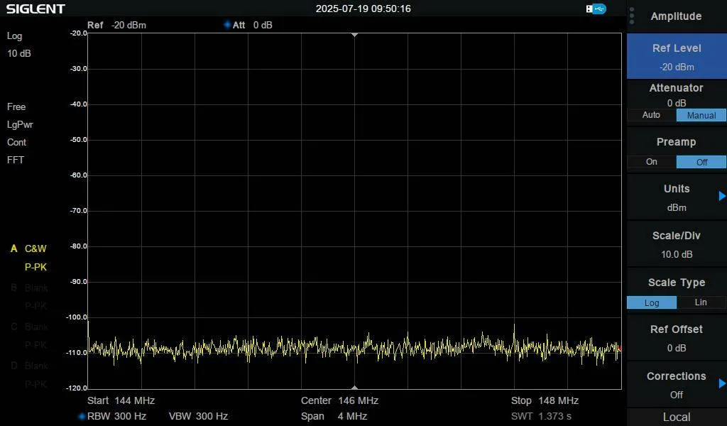

Still curious, though, and painfully aware of the limitations of the TinySA, I went back inside and retrieved my Siglent spectrum analyzer. It's powered by 120v and so I pulled an extension cord out of the (electrified) shed my Cybertruck is parked next to. I used a Diamond SRH320A antenna from one of my HT's as input to the Siglent. No attenuation. The following two prints were a minute apart... the first with the Cybertruck outlets turned off; the second with them turned on. Notably, when the Cybertruck outlets were hot, a 12v switching power supply, an IceCo fridge, and a Valentine One radar detector were also all hot inside the cabin. This was very much a quick and dirty test... but also one that would show the Cybertruck in the worst possible light.
Same 144.000 - 148.000 MHz slice of spectrum. The only thing I did different with the Siglent was to reduce RBW even further, to 300 Hz. Again, to minimize as much as possible the noise coming out of the spectrum analyzer itself.
Tesla Cybertruck Exquisite Cybertruck - Outlets Off - normal
Tesla Cybertruck Exquisite Cybertruck - Outlets On - normal
What I can see in the second print, with the outlets hot... is a very, very small increase in noise amplitude. And if I had to bet, I'd bet most or all of that very modest increase is down to the stuff in my cabin that energized when the outlets turned on.
For context, we need to be 14-15 dB above the noise floor to be full-quieting into most repeaters. The maybe couple of dB we're seeing here is, literally, noise.
Which is not at all to dismiss the noise you're experiencing. When you can hear something like that coming out of a radio receiver, it's pretty in-your-face. For sure, something is causing it.
I'm also aware that component or parts supplier changes, sample variation, and a few things like that can make one vehicle exhibit something that another doesn't.
At the end of the day, every active circuit and every energized device is going to generate some amount of RF noise. Including our Cybertrucks.
All I can say with certainty is that in my very small sample size of one - okay, two... I'll include my 2022 Model 3 - RF noise is negligible.
Best of luck in finding what's behind yours.

Thanks for running additional tests!
This noise is fairly random as you could (sort of) see in the waterfall. And you really need to have a waterfall display to see it. I thought there was nothing there just watching the typical display and it was only when I enable the waterfall option that I could see the effect of turning the sockets on and off.
It requires a somewhat weaker signal to detect the noise. A full quieting signal will overwhelm it and you will only hear the FM signal.
I was out a distance from one of our repeaters today, so shot a short video that demonstrates what I've been experiencing. The radio is running from a battery, so the Tesla sockets had nothing plugged into them.
In the video, I kerchunk the repeater with the sockets on, then turn them off and finally back on again.
A strong signal will sound just fine... it's anything less the ideal that becomes even worse thanks to the noise from the socket system. It would be nice to filter it out, but I think that would take Tesla to take enough interest to track it down.
