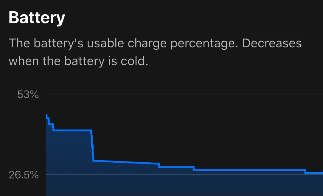

I left my truck parked last week, this is the drain over the preceding 7 days:
Tesla Cybertruck Extreme battery drain since low power mode introduced IMG_1739
While parked, it lost maybe 1% per day or less?
I just enabled low-power mode to see how much it will help, but the idle drain meets my expectations.
In the Tesla app, it should show "Asleep XX hours". If it says "Parked", then the truck is not sleeping.
