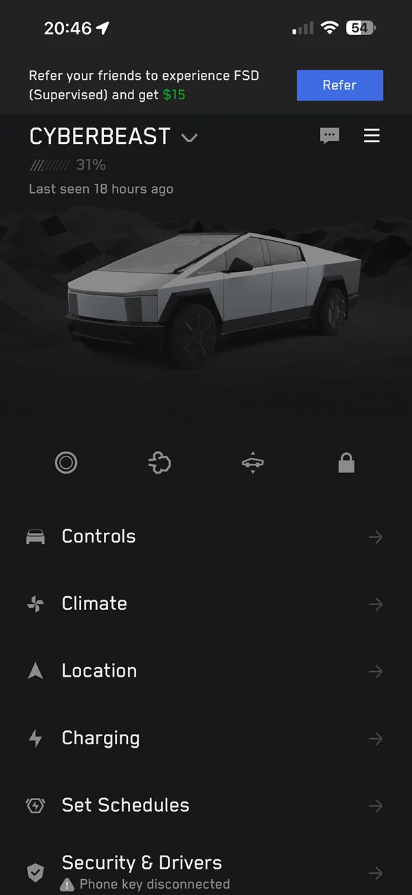

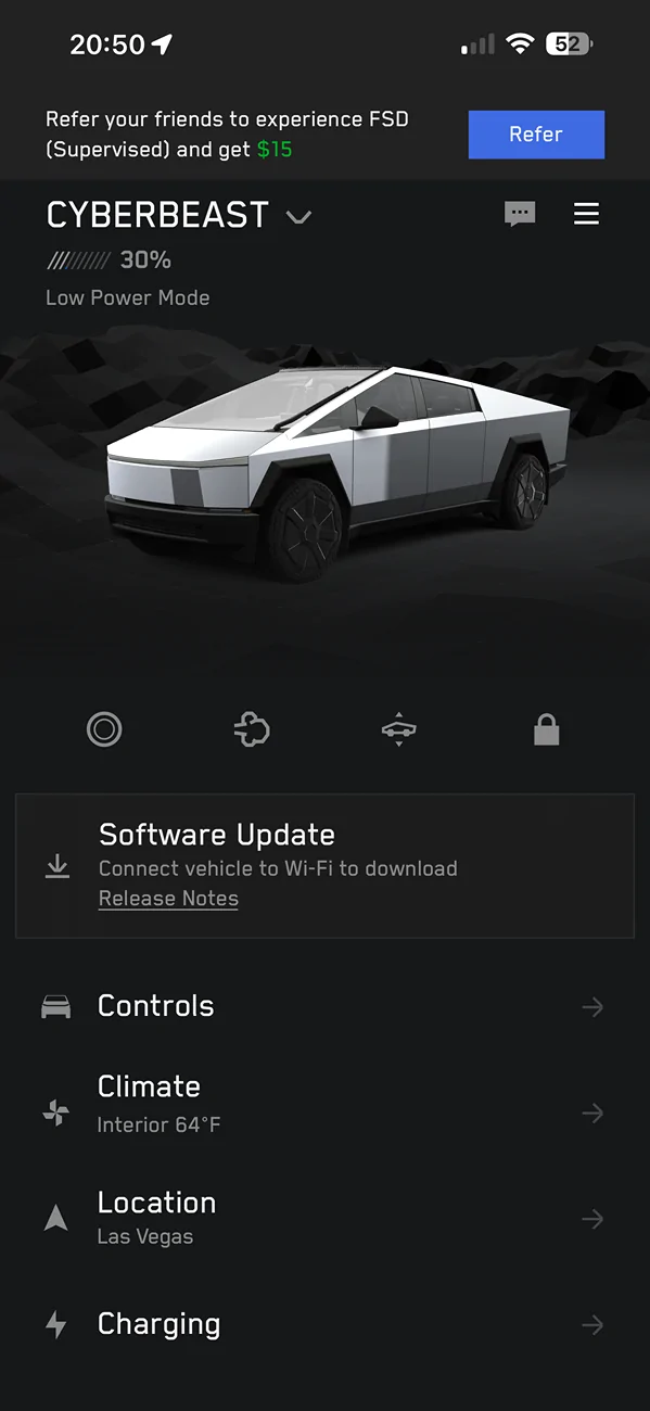

But that said, I believe I have a fix for the 6% per day battery drain in low power mode bug, and this is the important part of this post: sign out. Sign out of the Tesla app. I was losing 6% per day but after signing out 18 hrs ago, I’ve only lost 1%. That’s enough to make it so I won’t be at zero when fly back, even at the old rate of loss.
I hope this trick works for the others who are in or will be in this situation (again). And I hope it keeps working for me! FWIW: I’m on iOS.

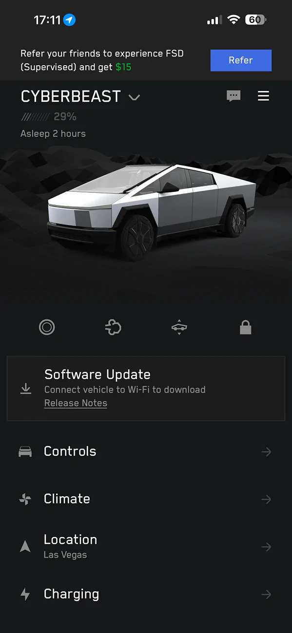

Interestingly, signing out of the app allowed the CT to fall asleep after about a day…
Tesla Cybertruck Phantom Power Draw in Low Power Mode IMG_3577
and most excellently, I’ve only lost another 1% while signed out and in low power mode. This is a massive massive improvement over the rate of charge loss before signing out (6% per day). Probably still abnormally high, but maybe discharge rate would have gotten even lower if I didn’t wake it up after 24 hrs to check up on it by signing back in…
but as best I can tell, the answer to the problem of phantom battery drain isn’t low power mode, it’s just signing out of the app (or both, low power mode might do something too, but not on its own).

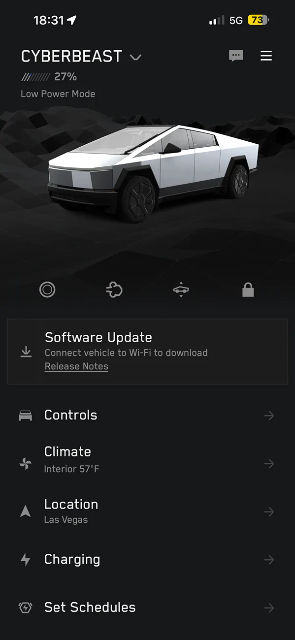

Signing out seems to be the durable almost fix for the phantom power drain bug following Tesla posting a software update. Only lost 2% overnight. This still, of course, means they have an unfixed bug or two but being able to defend against Tesla incompetence by signing out is a welcome bug work around feature. I hope I remember to disable update checking feature next month when I take the wife to Sweden for two weeks!
