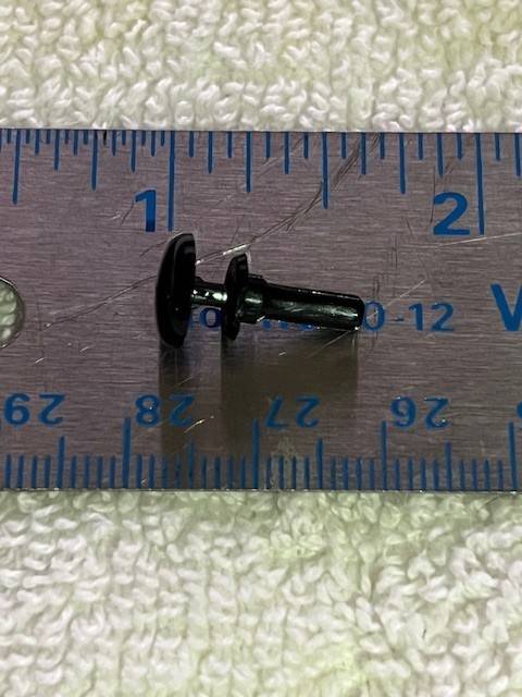

Found this on the floor-can someone please tell me what this push clip might be for?

While sitting in front seat , look down at the floor. The flat area between the seats has a plastic L shaped trim on each side. If you were to lift that plastic trim up, you will see 3 on each side securing carpet in place.

When side trim is removed, the clip you found is use to secure 3 small tabs of the floor carpet under the trim

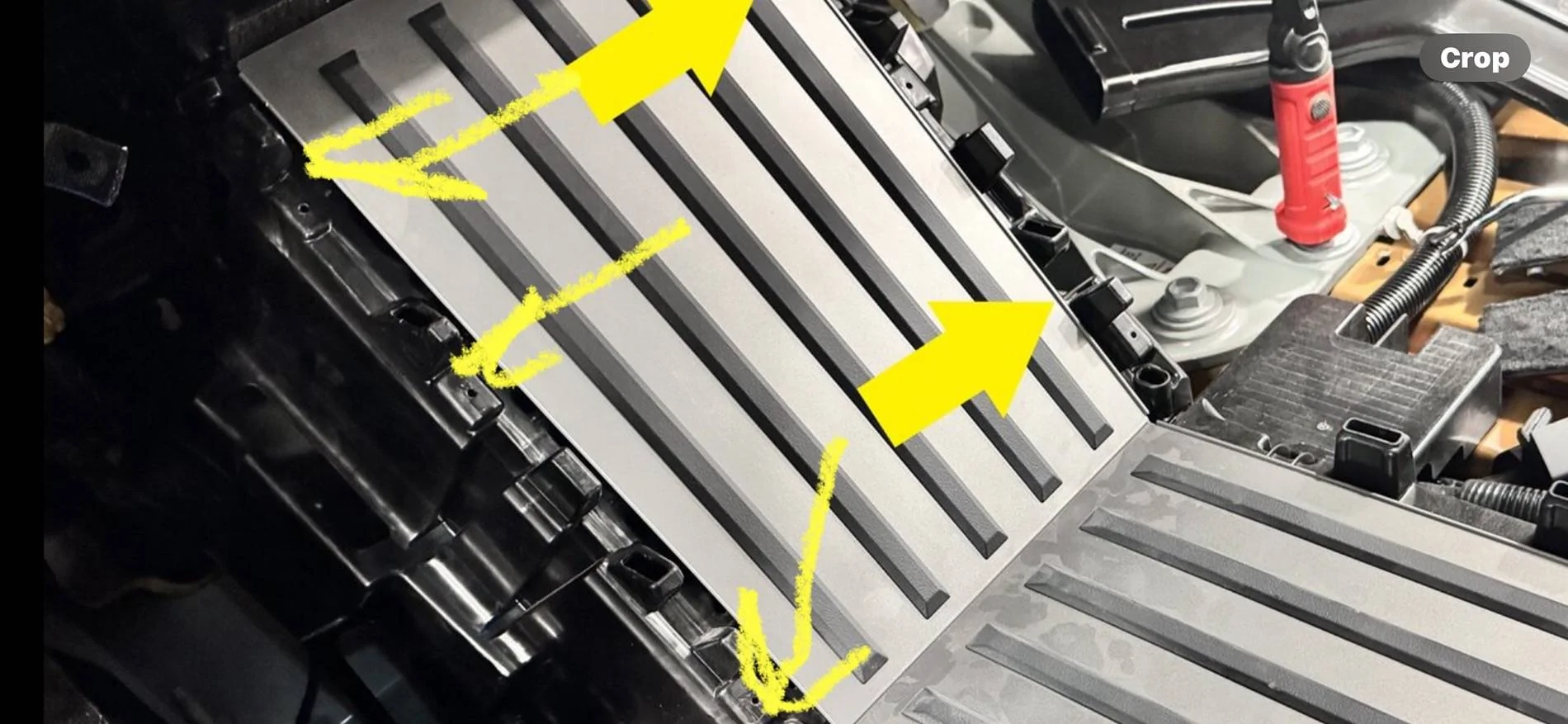

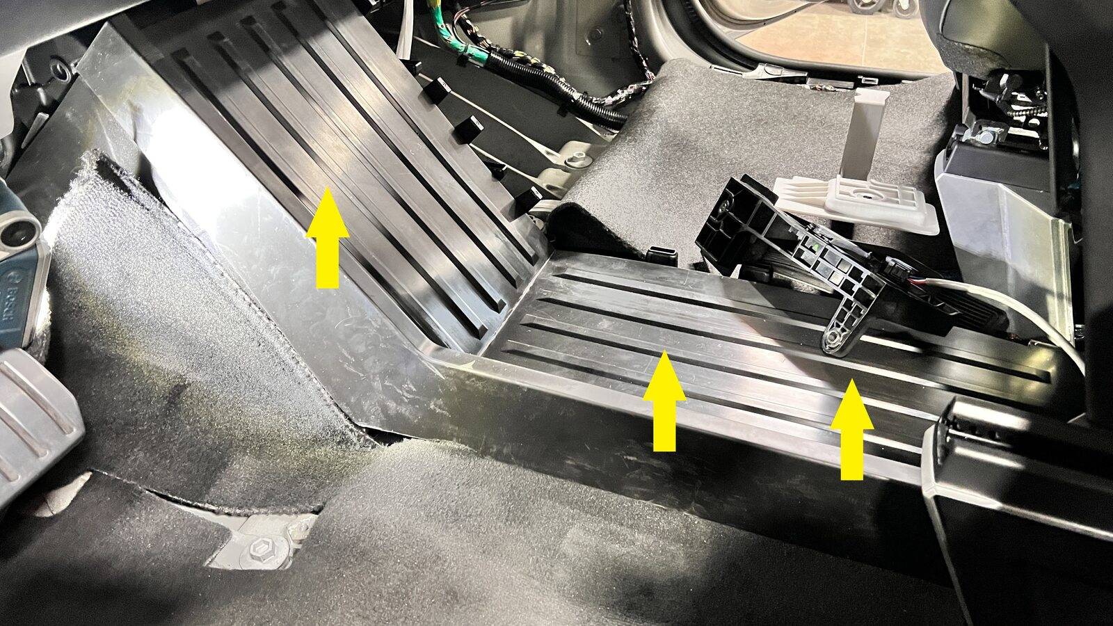

Tesla Cybertruck Found this on the floor-can someone please tell me what this push clip might be for? IMG_2953
Tesla Cybertruck Found this on the floor-can someone please tell me what this push clip might be for? IMG_2958

They're used all over vehicles to hold in plastic trim pieces.
Do you want a list of places they're used in your truck?
If your truck is new, it could be an extra one that got left in the truck during assembly.

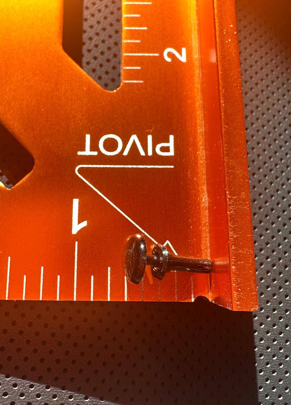

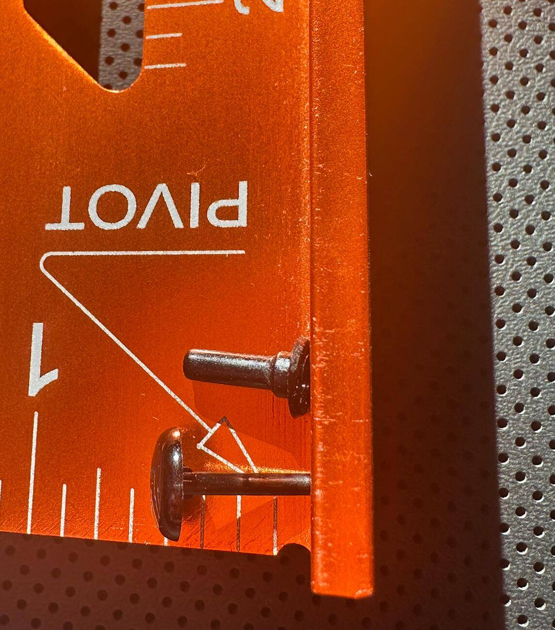

Tesla Cybertruck Found this on the floor-can someone please tell me what this push clip might be for? Screenshot 2025-02-02 at 10.41.27 AM
Tesla Cybertruck Found this on the floor-can someone please tell me what this push clip might be for? Screenshot 2025-02-02 at 10.41.47 AM
I found one also on the drivers side floor board. I pulled it apart for the pic. My truck has 10,000 miles on it I don't think its a freebie dropped at the factory.

I suspect factory installer dropped it and you found it. Bonus.
