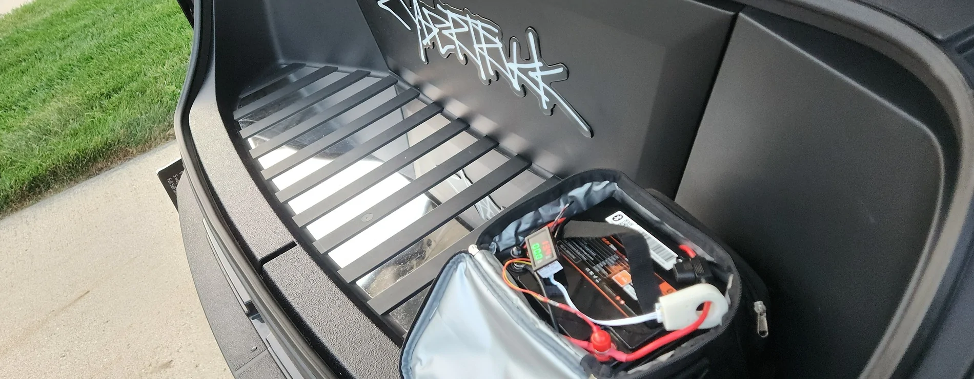

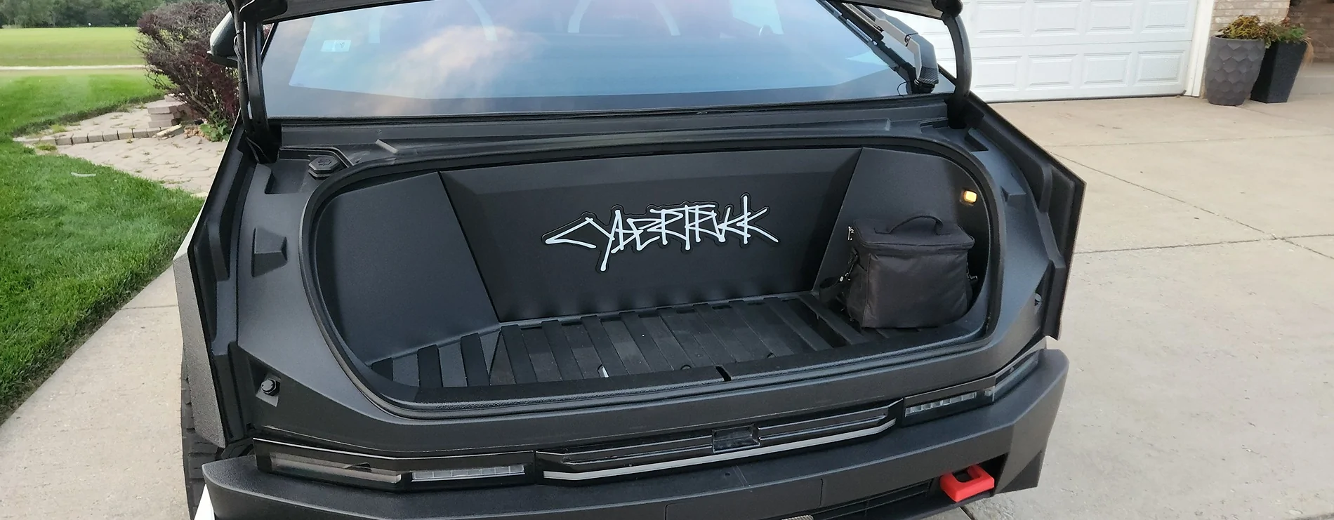

Everyone keep in mind that the 48V frunk power wires can't supply enough current for all of my lights and controllers. I use the frunk power wires to charge a separate 12v lithium battery in a lunch bag in the frunk using a 48v to 12v converter after car shows. 48V to 12/24V DC to DC stepdown Converter—Accessory Kit | XKGLOW
My Bluetooth LI 12v battery in the lunch bag lasts about 5 hours at car shows. I have 2 of them. The other one is just sitting in its own lunch bag in the lower bed compartment - just waiting its chance.
LiTime 12V 50Ah Lithium Trolling Motor Battery | Smart Bluetooth – LiTime-US
Tesla Cybertruck Foundation Series Light Bar Waiting Room 20250830_192240
Tesla Cybertruck Foundation Series Light Bar Waiting Room 20250830_192201
With all of my lights running - I'm pulling 21 amps out of that battery. The 48 volt system of the CT only supplies 8 amps max. 48v @ 8 amps should be the equivalent of 12v at 24 amps, but the CT seems to shut off the 48v power feed around 12amps at 12V. Wierd - but oh well - lots to learn.
FYI....The ONLY light that is NOT powered by my small battery is the lightbar. Its powered by the trunk as though it was the OEM light bar.
