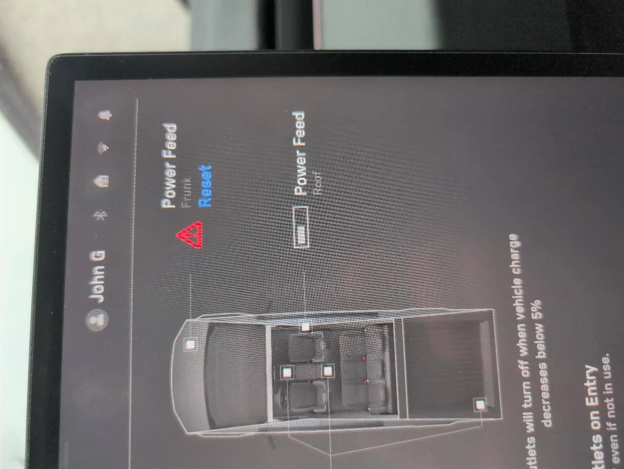

I got mine through Tesstudio. Both the power running boards and the grill light. I get a error on my frunk switch for the power running boards. They are telling me these two items are not meant to be daisy chained on their CAN connectors. The light works, but the running boards pop that error up. I did unplug the connection on the control box, and re plugged it back in when i had the frunk apart and got it to work. But it only worked until the truck shut off and didn't work again when I came back.
The light that I installed does not hook up to the power in the frunk. That’s probably why I’m not having any issues with it. Mine connects to the power inside of the passenger compartment (Main Port) hope this helps

Yes, my light is the same way. But both the light and the power running boards connect to the CAN connection in the passenger side of the dash. They were telling me there could be an issue with my running boards because these 2 connections are daisy chained in line together. They suggested i may need a splitter. My light works. But the power running boards do not.

Thank you. It looks as if you already has an additional plug in that CAN spot. So with the running boards you will have 3 of them chained together? I'm curious if that would cause any problems. I may pull mine apart and switch the order of the plugs and see if that makes a difference.

So I heard back from Tlyard (who I’m getting the running boards from) and they said theirs are powered by the frunk power so no interference. Hope this helps.
