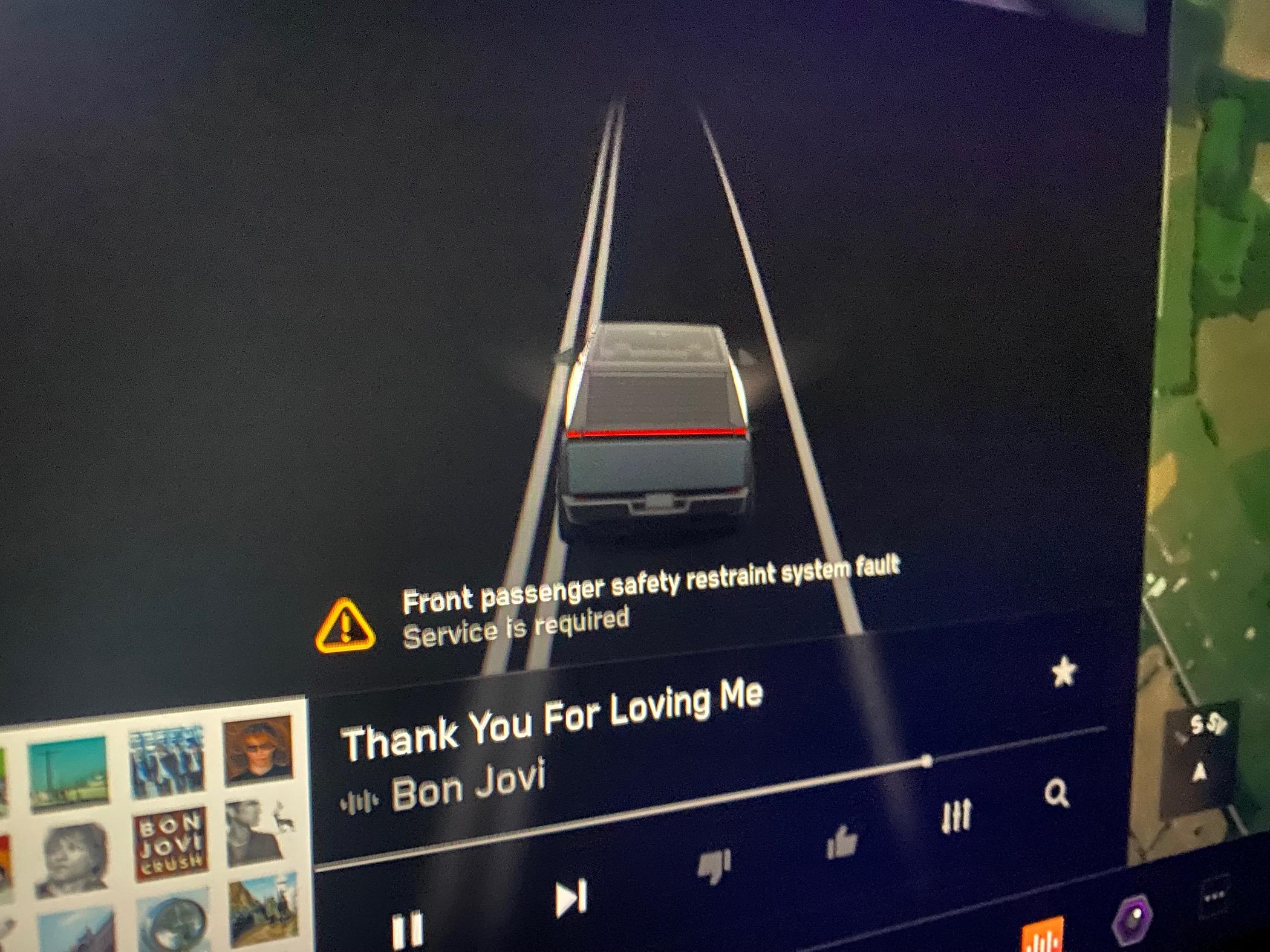

This fault came up just a few miles in. They have already reset it at the service center and of course that didn’t fix it. The next available appointment is the end of June. Does anyone know what this is exactly? I would love to at least look and see if it’s something obvious. Hearing the fault prompt sound every 5 seconds is getting old.
Tesla Cybertruck Front passenger safety restraints system fault, anyone else? IMG_1337

My model 3(2023) just started showing that error yesterday too

I have same but different warning, mine just says safety restraint, where yours has it as front passenger

I am getting similar error message. "Front left safety restraint system fault." Service is required.
Took to SC, who reported: Performed circuit checks and verified no hardware issues or circuit fault found. Further diagnosis isolated that the fault presenting is a software issue and will be resolved in future firmware. No repairs made at this time.
This is so annoying! Alert comes and goes. Terrible on long drive trips. It was alerting every 10 mins.
The 2 button reset and power down only clears it temporarily.
The only relief is to enable Joe Mode!
Come on Tesla, if you are reading this ... please provide the firmware update to fix this annoying issue.
