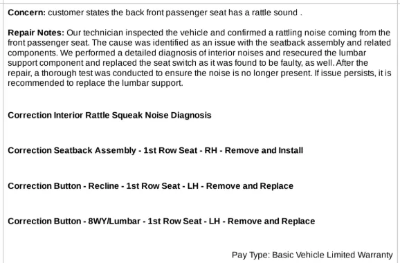

Took it in this morning for the front passenger seat rattle. Fix was.... disassembly and reassembly? Hopefully with some extra loctite or something....
thanks for the update! I will add this to the service on both my front seats.
I hope it does not happen again for you. Keep us posted.
