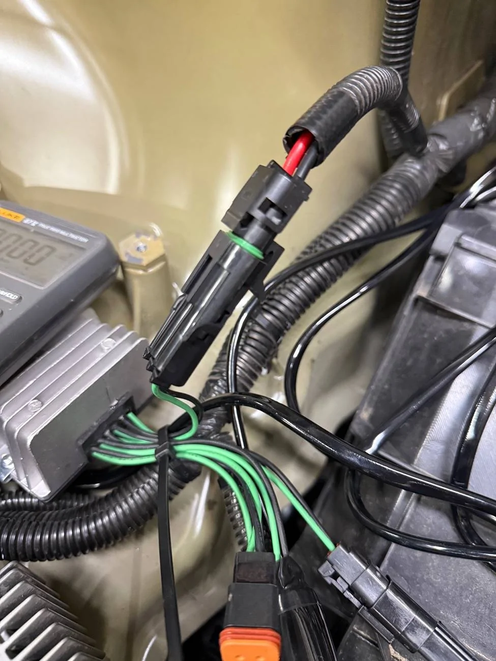

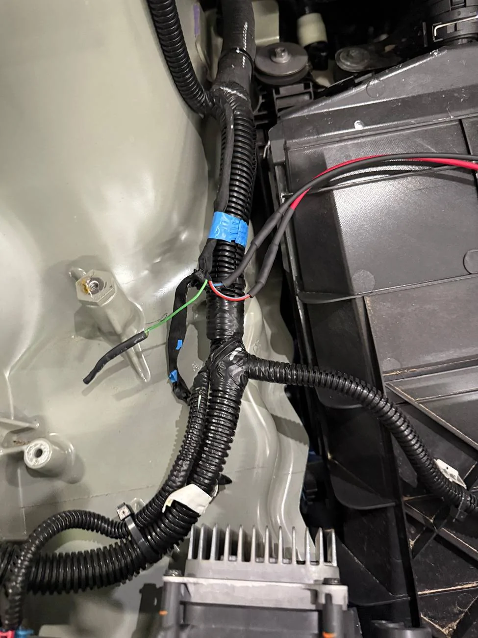

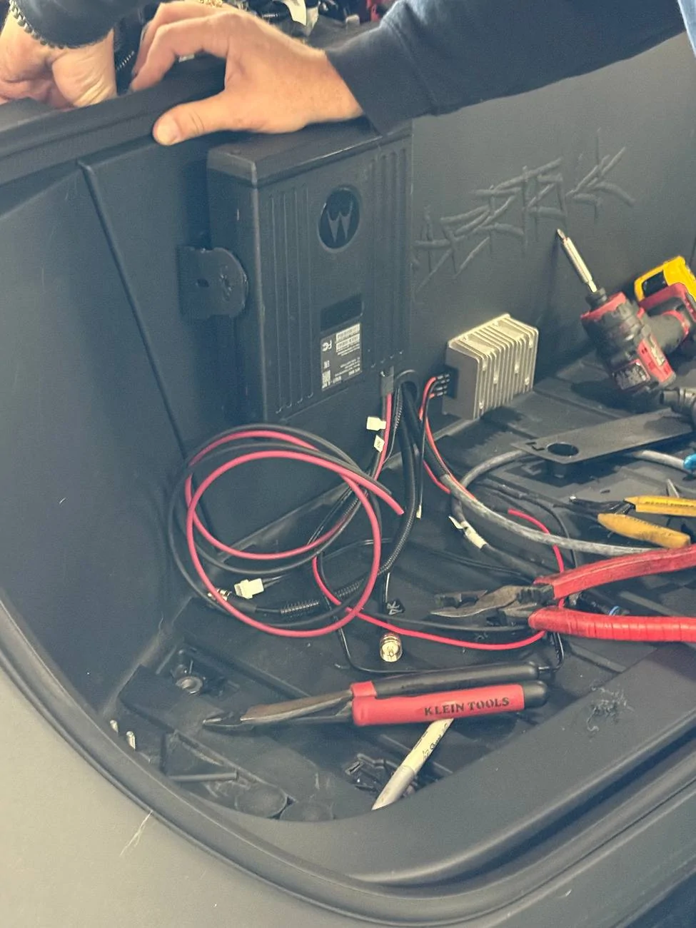

I have to take apart the frunk to get photos as it is all hidden out of the way beneath the factory plastics. 1 small 200w amp, 1 6” PA speaker. Then in the cab I have a wireless remote and microphone. Can do various police sirens as well as the PA.
