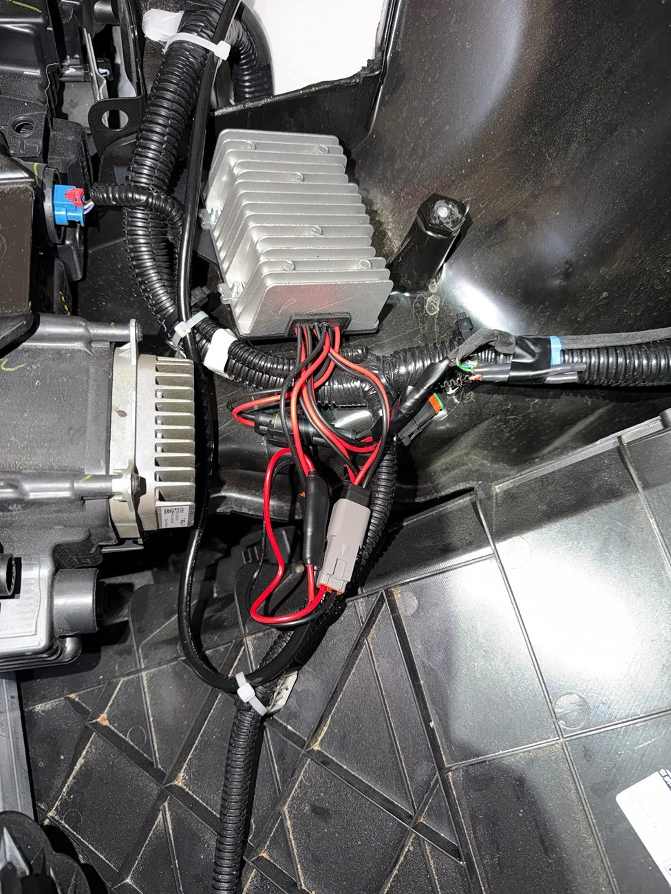

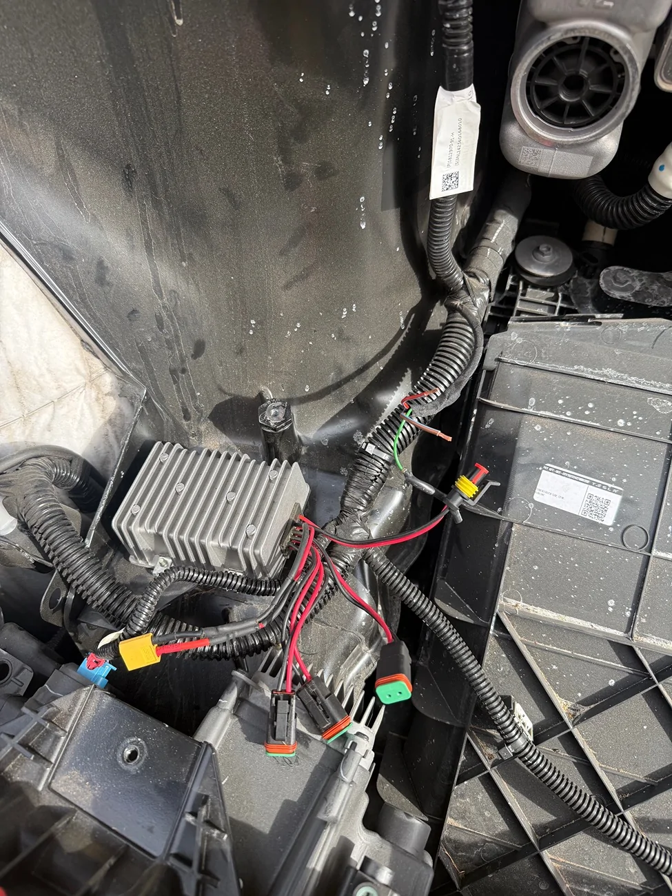

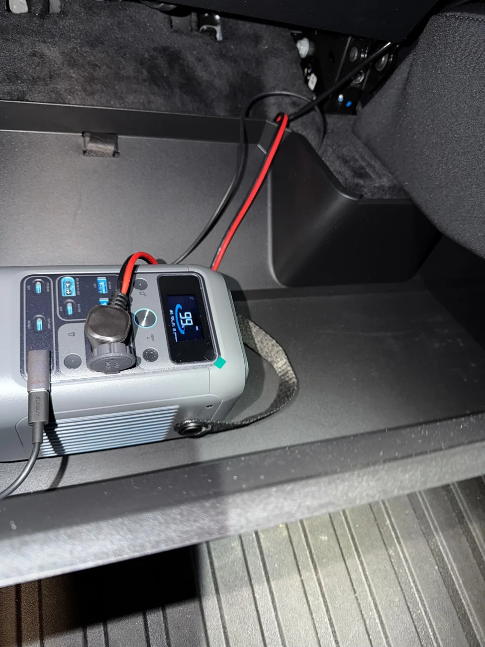

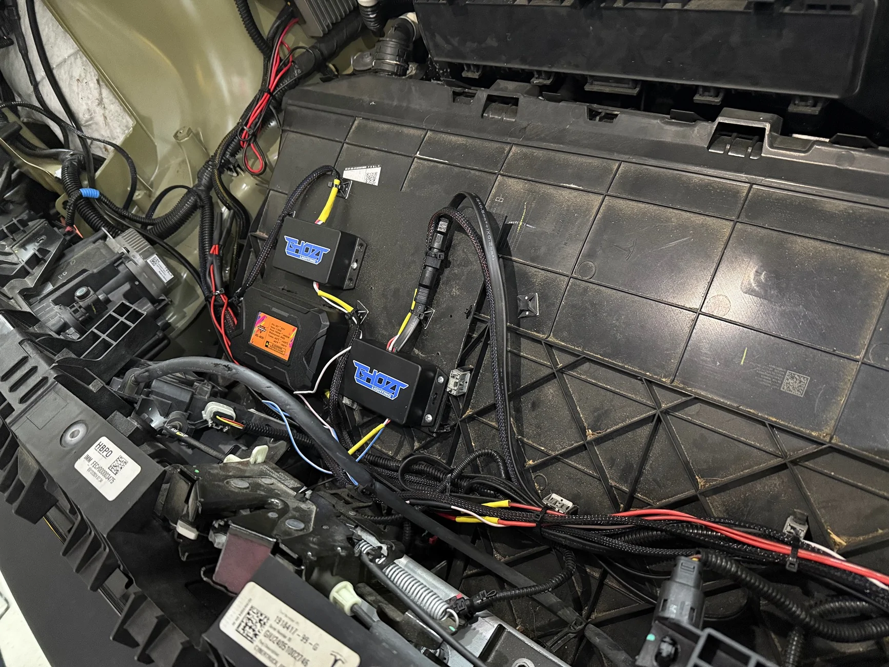

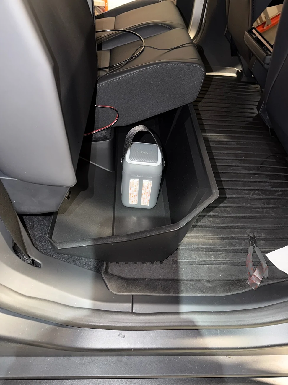

T Sportline buck converter, used to power console fridge and Starlink mini, powered through a Solix C300 DC mounted under the rear seat Tesla storage bin.

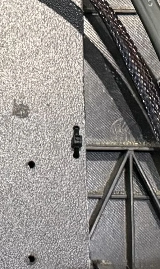

Have not yet written the install up, (and a big thanks for those here who have inspired me to install a fridge) waiting for rocker panel sill plate clips that somehow Tesla doesn't have part numbers for. Found out they're the same as model Y clips, just not in the parts manual for CT for some reason. Tesla # 1496105-00-B, a available from Amazon.
Will write the install up and add it to the other thread as soon as I put everything back together.
Very cool. I have a c300 dc too. Great little power station. How did you secure/mount it?
Was going to post to the other thread in more detail soon, but, velcro. Need to add a diverter in the undersea storage bin to keep other things from slamming into it.
