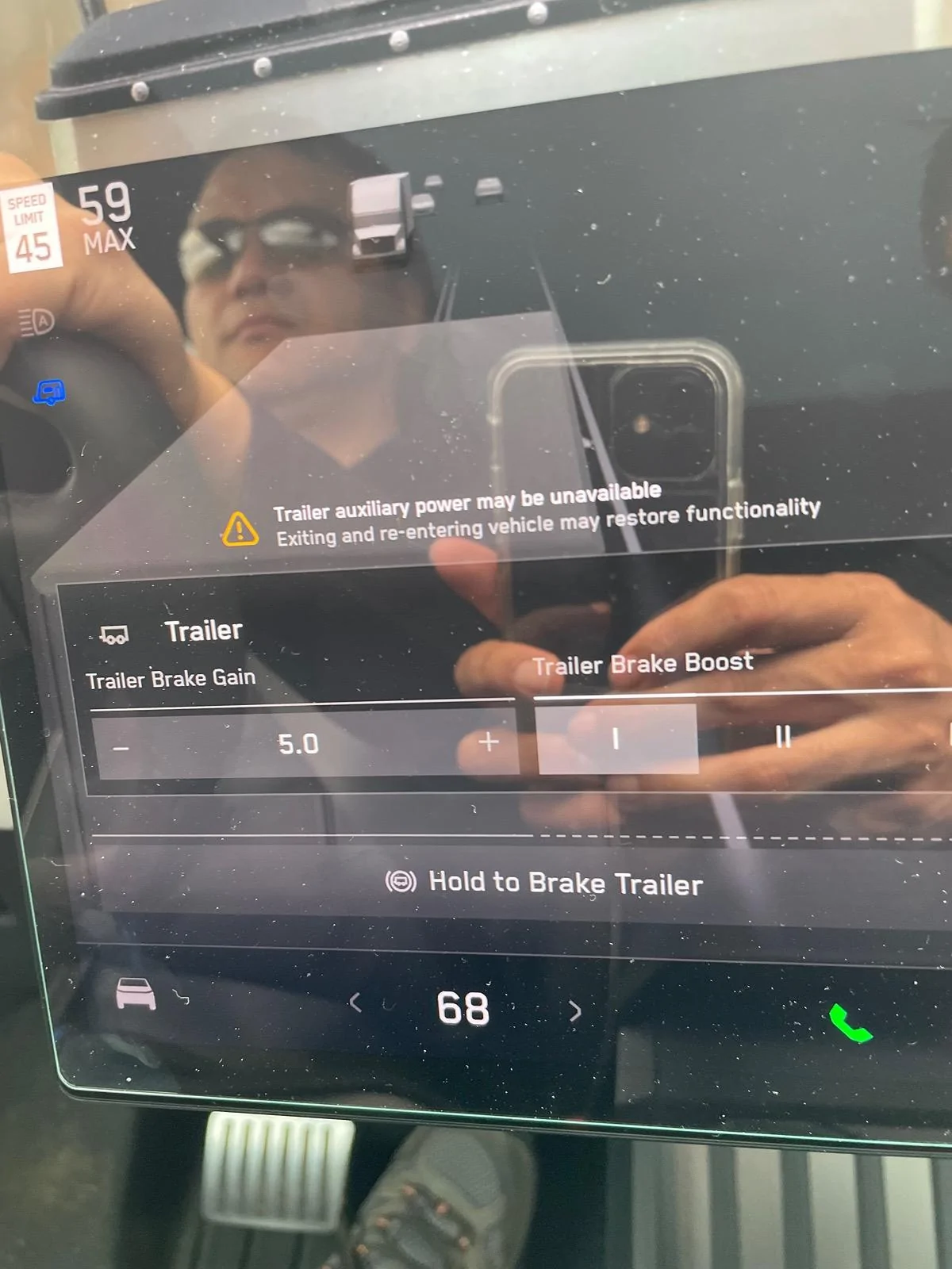

But we stopped and checked a few times, the power feeding to the trailer was fine. All trailer brake light and turn lights were working as expected.
Anyone had the similar warning?

you connector on the trailer may be rusty, prohibiting proper contact between trailer and truck. Inspect for rust and clean connector, then add some dielectric grease. Should resolve the issue.
