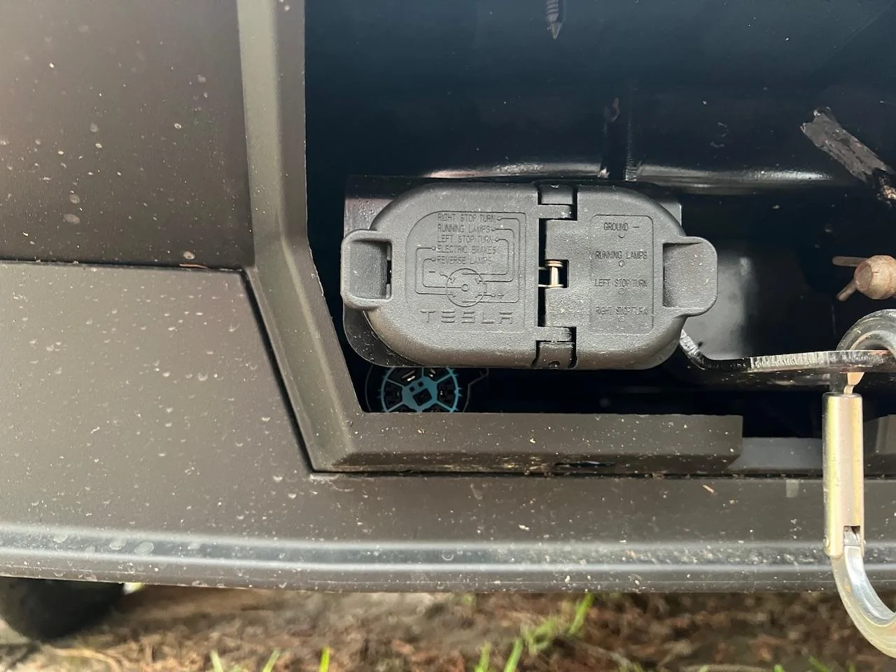

Figured out the problem, was a loose connector on the inside of the bumper. The blue connector in photo had to be snapped in. Fortunately this was accessible by reaching in through the right side opening in the bumper.

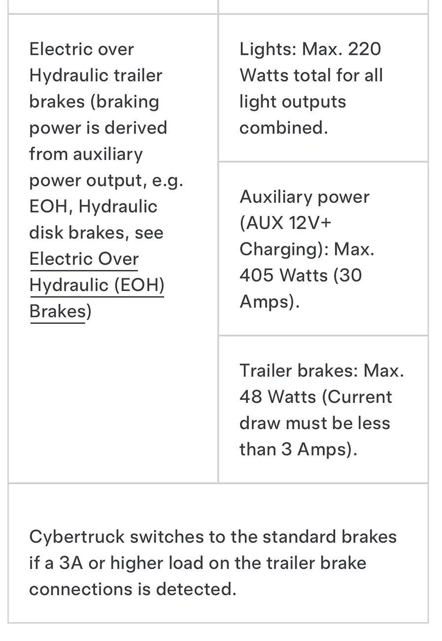

I been trying to see if Tesla has any current specifications for the 7 pin trailor connector. I can see it is controlled by this Trailer ECU but would like to know if the current is limited, fuzed, and protected.
Specifically want to know how much power the auxilary pin is capable of providing.

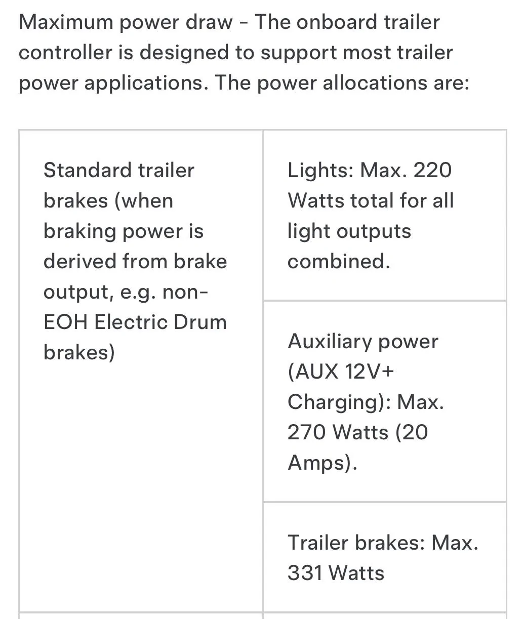

It’s definitely limited and protected (hence the need for touchscreen trailer mode resets from time). I assume just electronic fuses. 20A to 30A for the aux pin, depending on mode:

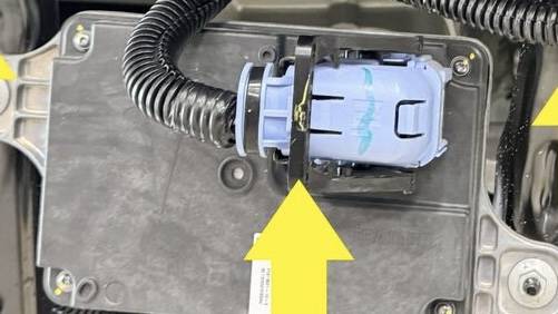

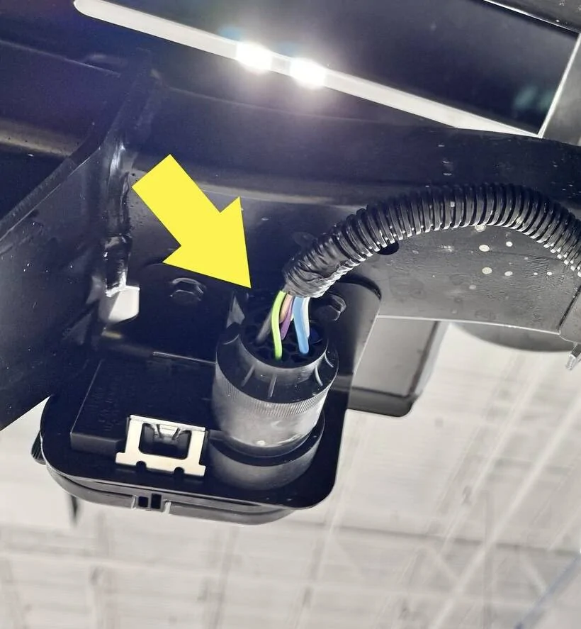

This is a better view of the connector into the 7-pin receptacle, I would try pushing it in (towards the rear of the truck) and if you hear a click then it’s now seated all the way. There’s also a blue connector into the trailer controller in that area, but that’s a lever locking connector that seems less likely to not be seated completely, plus it probably has an error code that would show up in service mode since the in/out wires are all in the same connector.
Tesla Cybertruck 7-pin Trailer Connection - No Power IMG_1784
Trailer Controller Connector:
