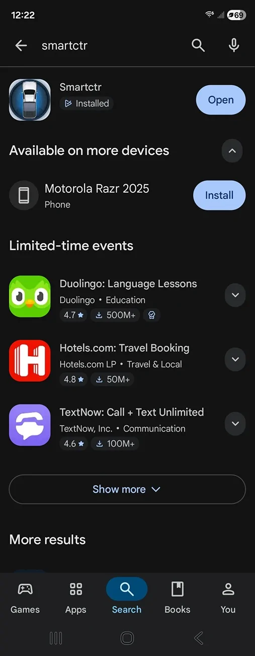

1. You should be able to just toggle the switch in the outlets menu. After a reset it can take a minute to provide power.

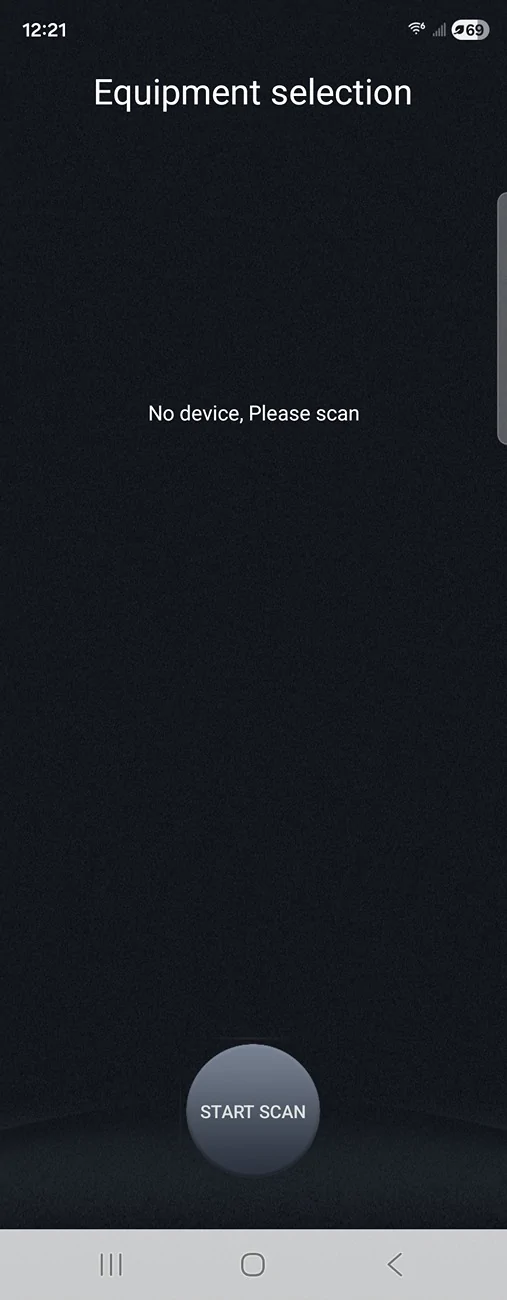

The app I use is "smartctr" it connects via Bluetooth. I would download the app and do a scan to see if it picks up your running boards.

If your frunk power is on try to use the app to verify if its the steps cpu miss reading the door switch. I.e functions fine with app vs just opening/closing the door.
If thats not an option it could be bad or loose connection to the frunk power or a loose connection at either motor where the barrel plugs connect to the two motors.
