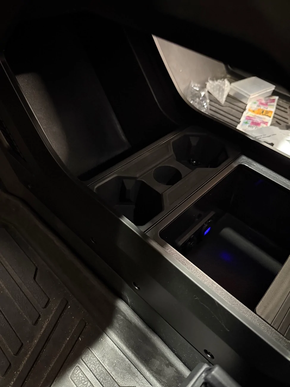

I got mine in today and added 12V to the cubby. Ran it from the step down I wired in the frunk. It’s switched off a relay that’s triggered by the 12V in the cabin camera.

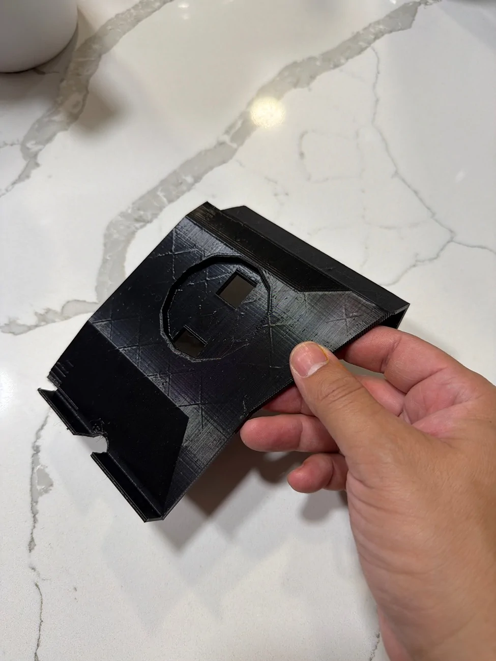

Next mod is a 3D printed MagSafe charger so that I can lay my phone onto the tray and not worry about cooking my phone with the oem charger. I already am polishing some that go over the current wireless chargers (different thread).

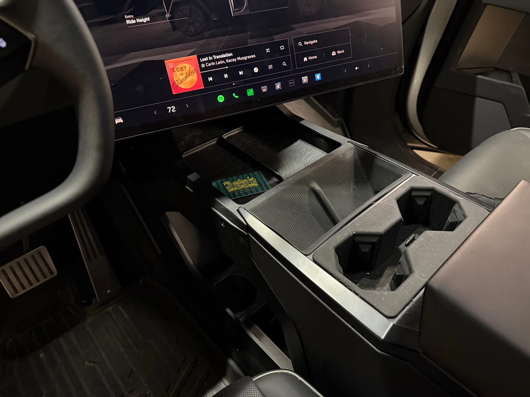

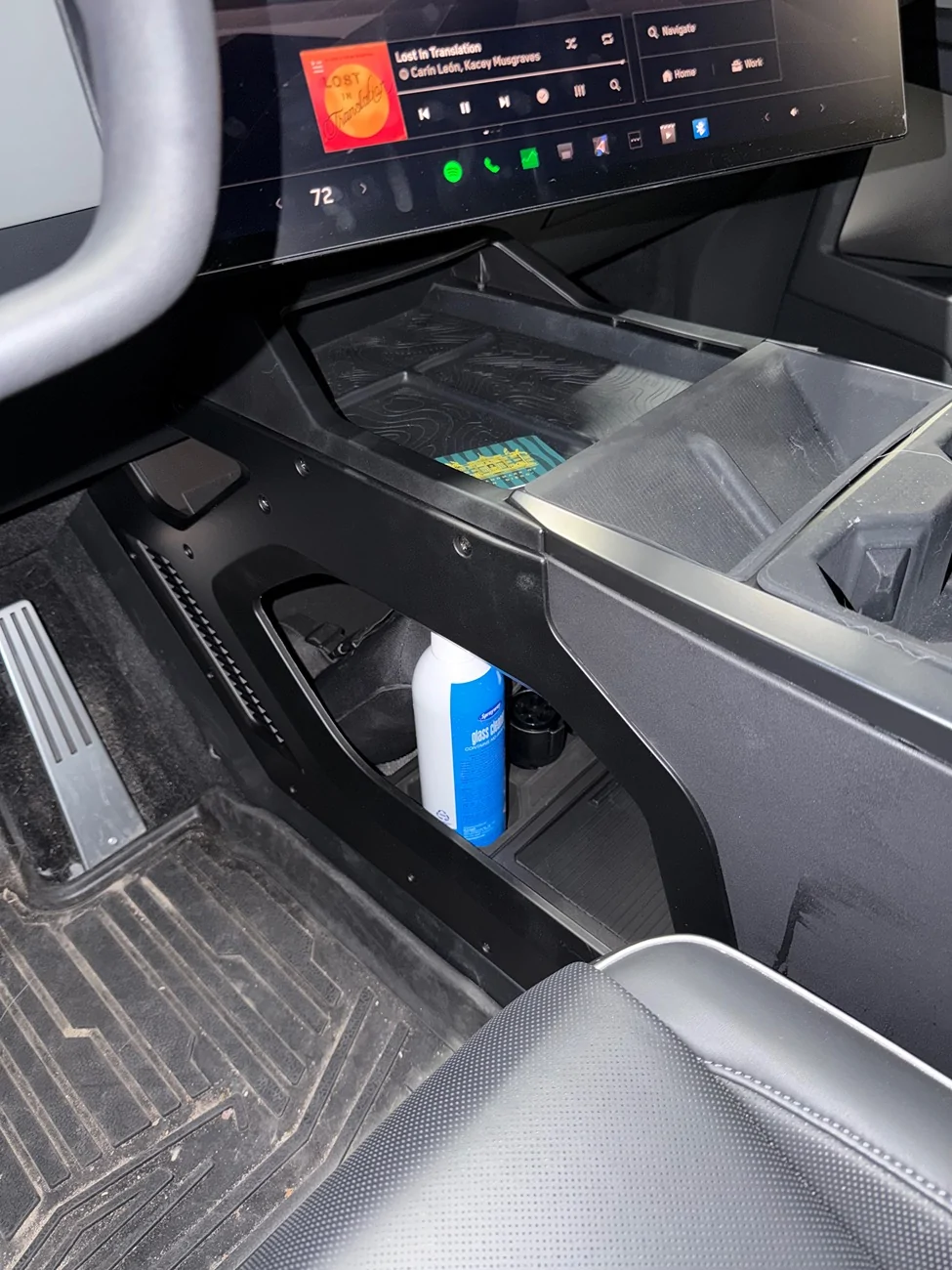

I was surprised at how solid it was once it was in there. I gave it a tug and it wouldn’t budge, feels like it’s part of the truck. One tip is leave the last screw out before dropping in the top tray so that you can pull the sides apart and put the top tray in.

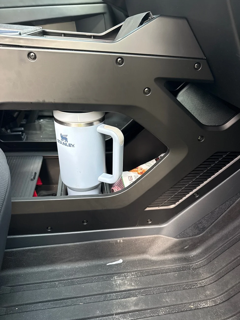

How big are the cup holders? Will they fit Owala or Stanley water bottles?
You're more limited by height. I haven't tried my wife's 40oz tumbler, but it looks like it might fit. I'll give it a try later today for you. My Owala 24oz does.

It fits, but the way you put is not super convenient.
