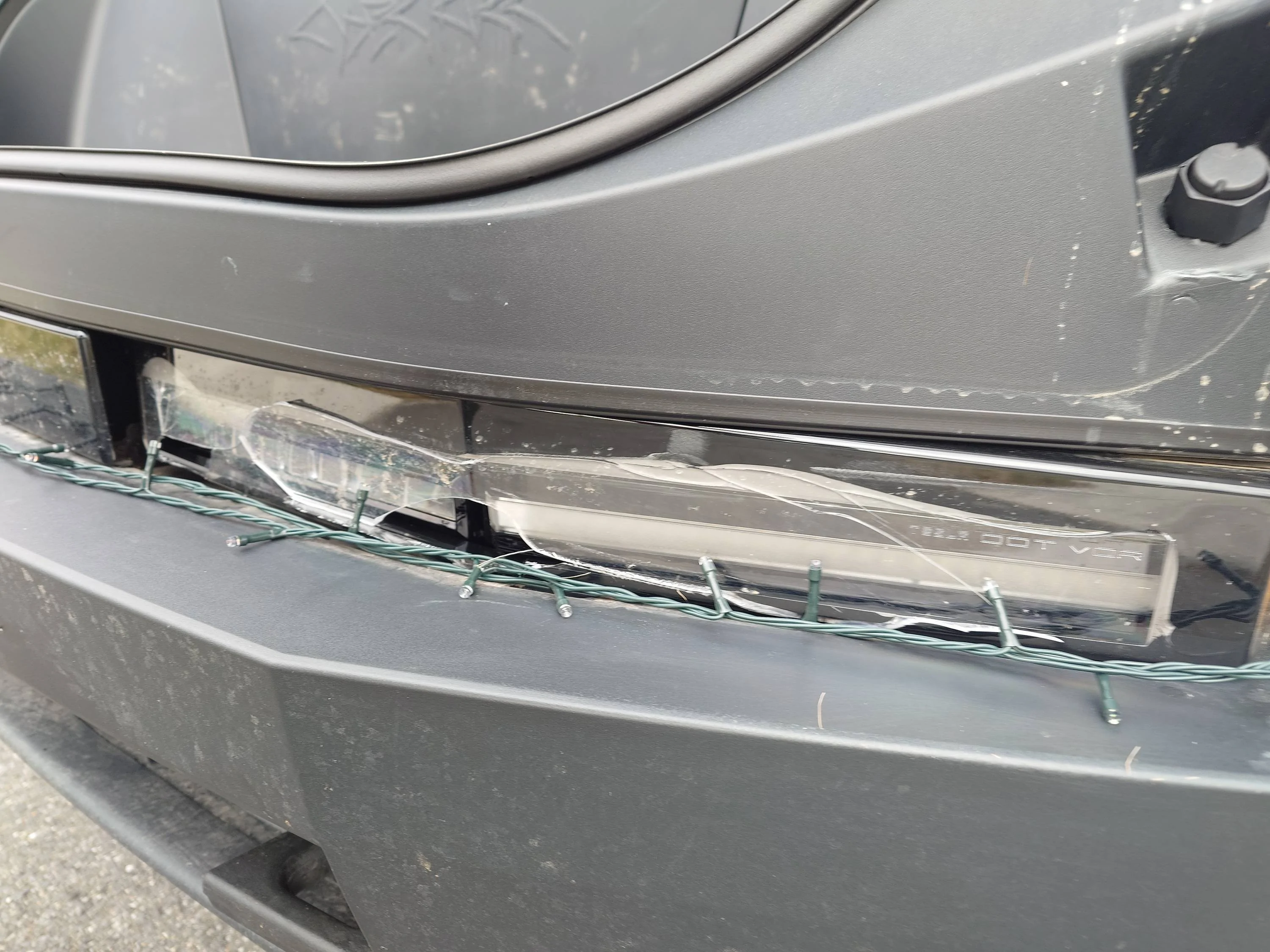

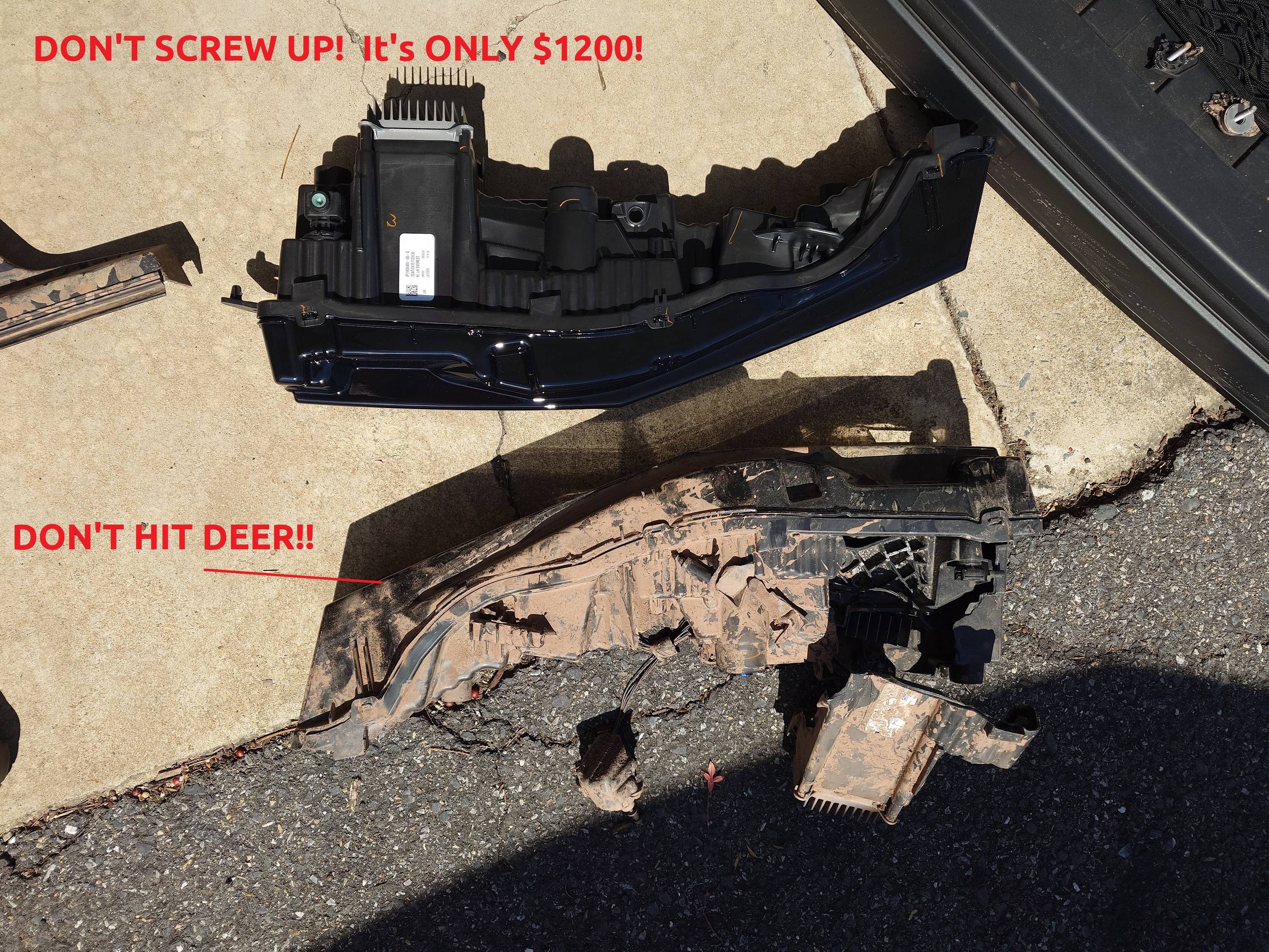

12/17/2024 after putting Christmas lights on my cybertruck a deer decided it wanted to play.... They were nice (for about 2 hours....). I was using autopilot it didn't see the deer at all (ironic, we received the first FSD 13.x late that night...).
Needless to say the deer had other plans : [

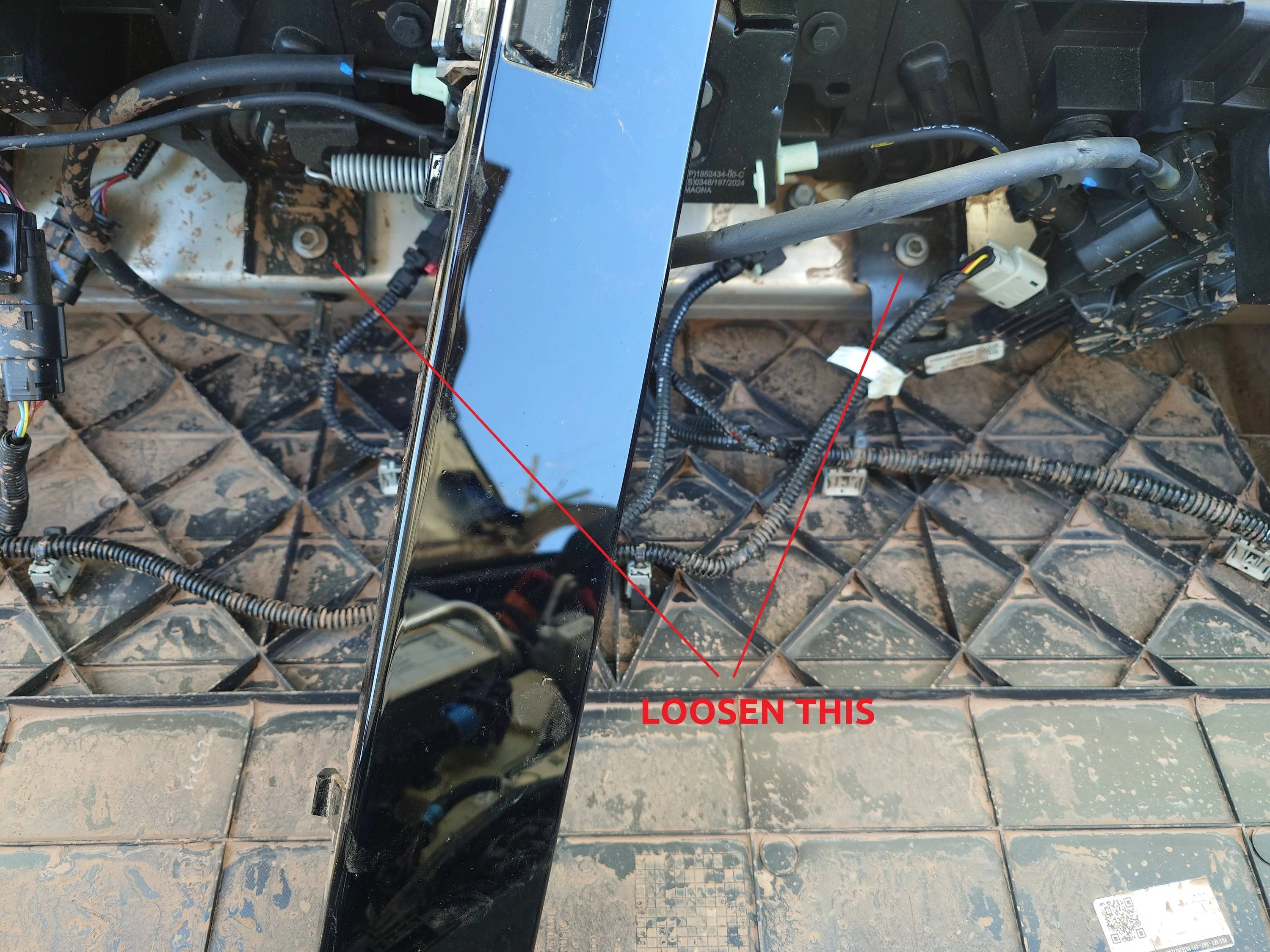

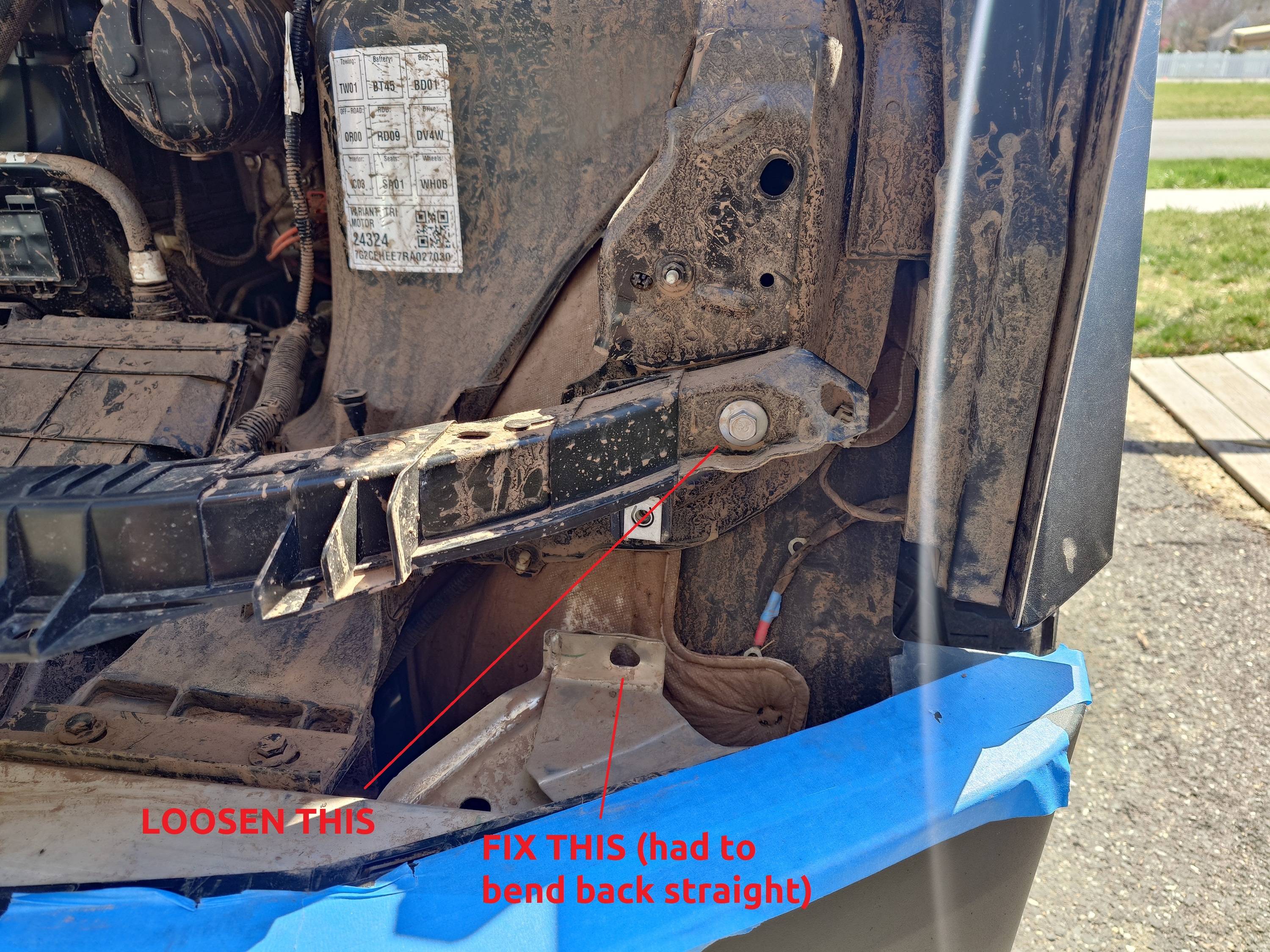

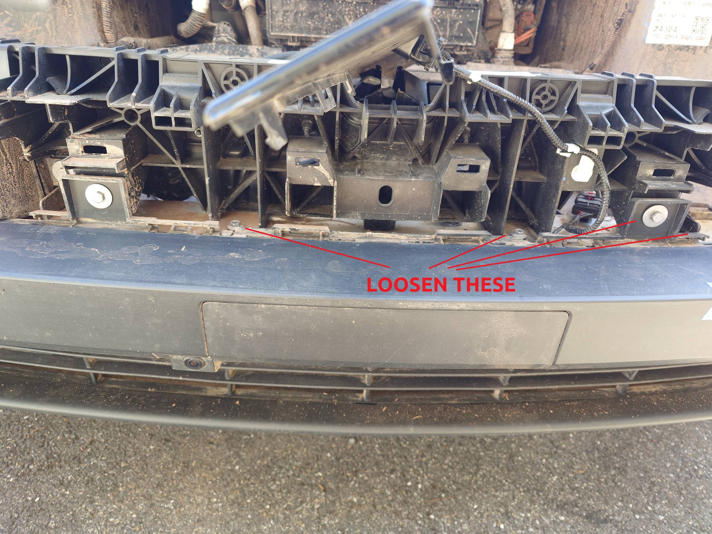

Loosen all the components BEFORE removing the old headlight to save some headache (guess who didn't....).

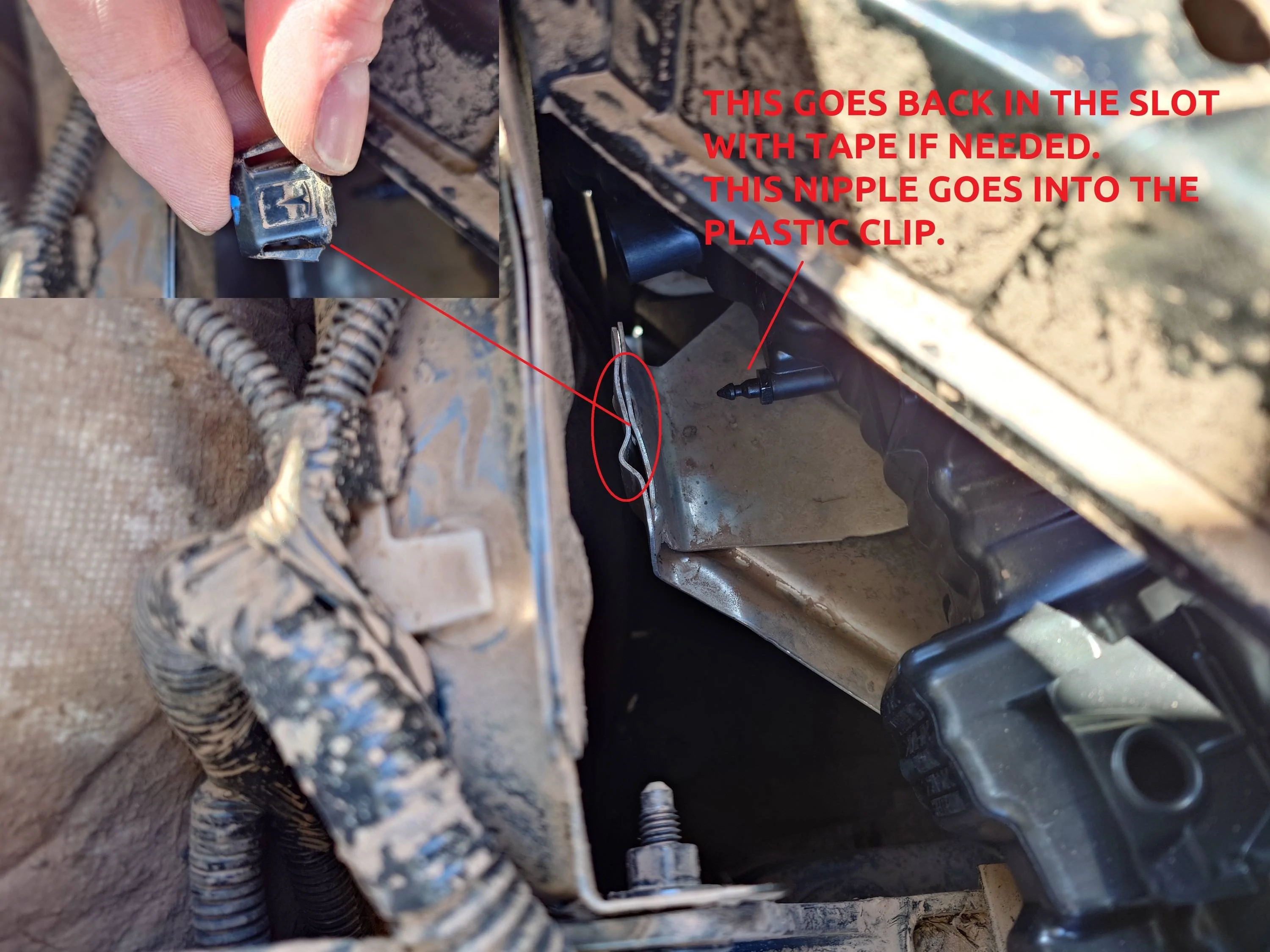

Once everything is loosened and the headlight is removed there is a clip that needs to be found. (disconnecting the headlight is in Teslas instructions read that)

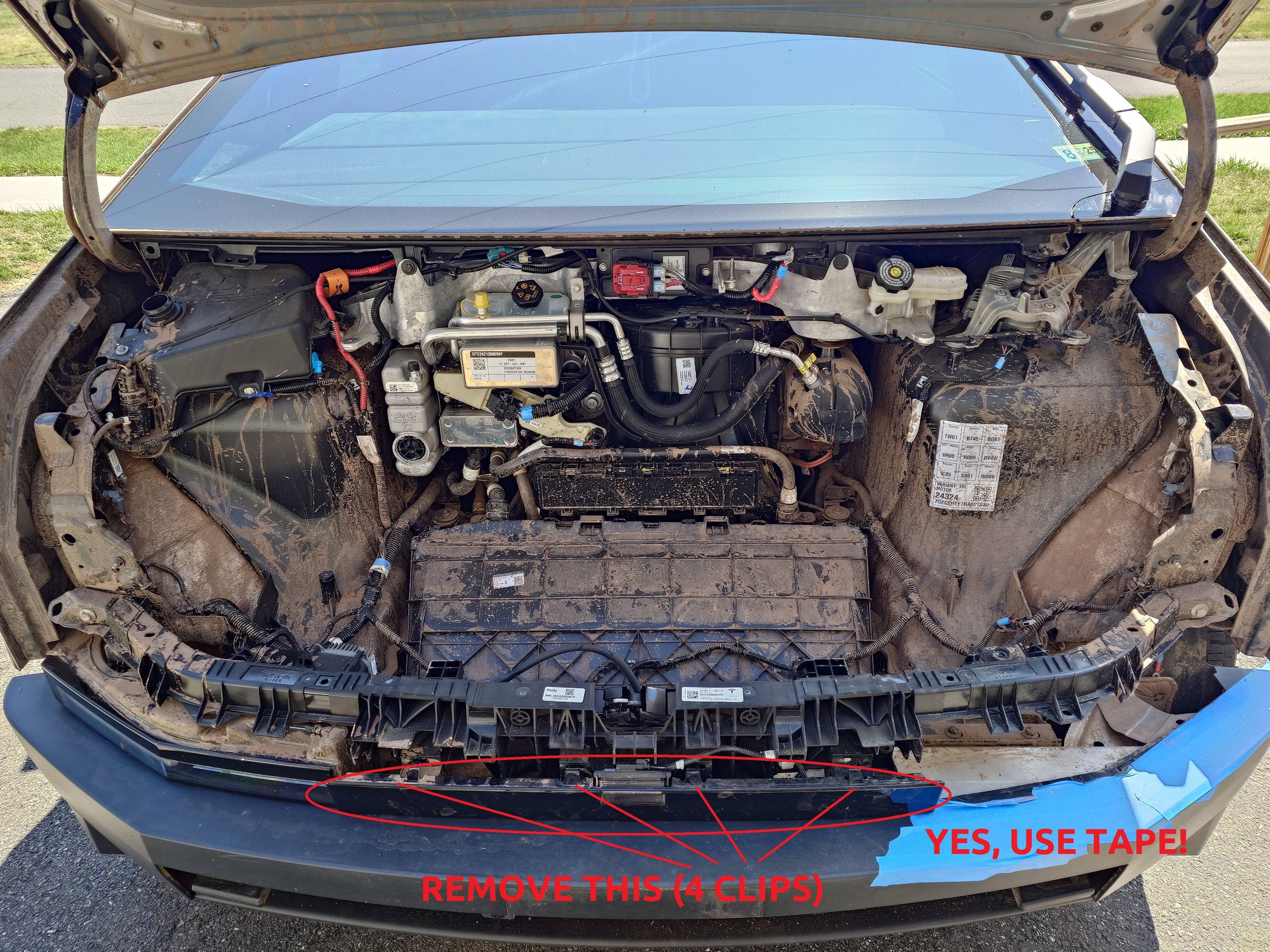

Likely it will be slightly damaged and will need to be wrapped in tape (I used the painters tape) this makes it snug especially as the bracket behind it will likely be damaged (we are replacing a headlight due to impact after all). I had to put and pull the headlight a couple times to get the bracket fit right.
If all the bolts mentioned above are loosened then this will only be a small PITA. The headlight doesn't actually fit, it needs to be gently forced into the slot. The two circled components will be the biggest pain for this. Looking closely at my headlight in this picture there are a bunch of scuff marks on the top part as I had to trial and error learn this. I found pulling up between the two circled brackets worked the best.
The headlight 'falls' into place after it slides in 2/3s of the way (there is a bottom lip that falls behind the bumper).
Before tightening everything back down plug the headlight in and test flashers, running, headlight, and highbeams.
