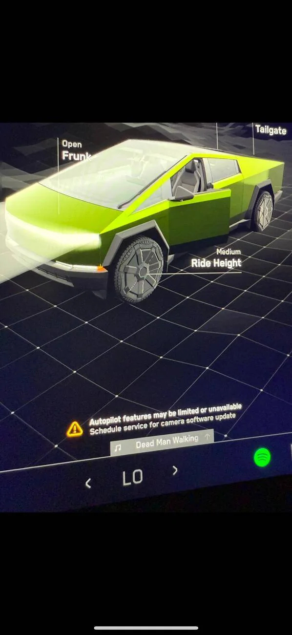

So I got the warning that says I need a professional camera cleaning. They are charging me for it. I’ve owned this truck 5 months. Should we prepare for paying for this cleaning every 4-6 months?
This post is just plain silly. It does not say anything about professional cleaning. Take a tissue around your car and wipe. Hopefully everyone knows how to wipe. ?
If it persists after basic maintenance, then it would be a warranty or repair item.

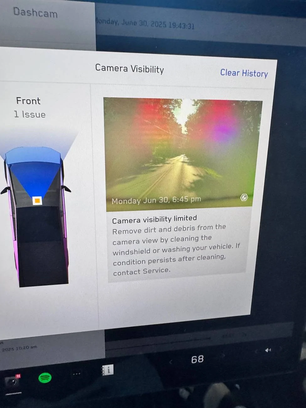

No. This is caused by off-gassing of the new plastic in a new car when it bakes in the sun. The hydrocarbons condense on the camera lens when a hot car cools. The off-gassing typically drops to near zero after the car has been baked by the sun over the first summer.

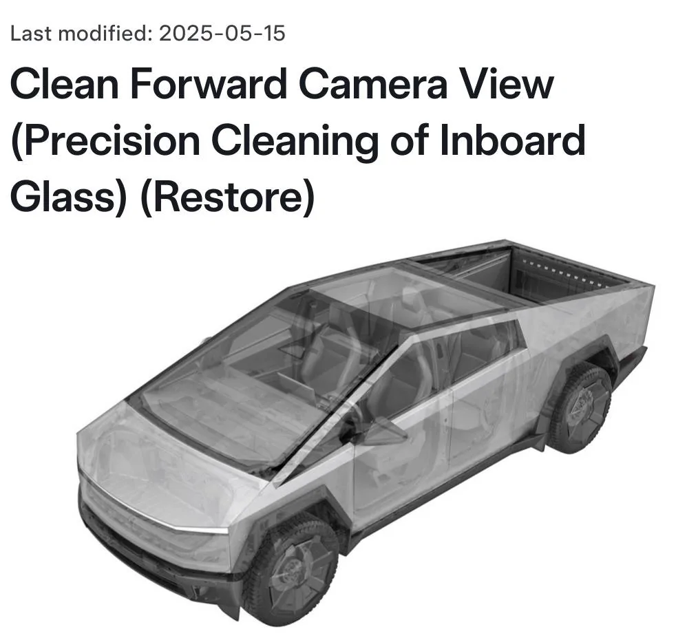

They may be confusing "professional" with "precision" cleaning. Regardless, a tissue around the car isn't going to fix the inner fogging.
While removing the five subassemblies to access the section of windshield in front of the cameras is in the realm of DIY, having the service center do it is much lower risk.
https://service.tesla.com/docs/Cybe...UID-6229D89E-739C-4ABF-BF8B-58E8FD447952.html
