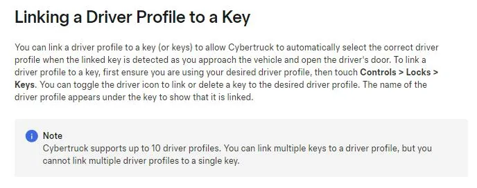

My wife and I share the cybertruck and when she takes it, she has her profile and I with mine. The only thing is we haven’t figured out how to automatically have the profile switch when she takes the car without me. We have the priority Bluetooth settings set but if she’s there without me and it pairs with her phone, my profile is still the one that is on the screen until she automatically switches it. Can the cybertruck be set so that the phone it pairs with changes the profile to the owner of the phone automatically?

Link one of the key cards (or phones) to your spouse's profile and the other one to yours.

Thanks for that last tip. My profile pic comes up and it matches what I have uploaded in my phone app. But my wife also has a photo associated with her profile in the app but no photo is shown in the car. How do we update that? I had to manually put her name into her profile instead of it updated to match the app as well.

When you toggle the driver icon on the key you want to assign, make sure the driver you want to assign to that key is the currently active driver profile.
