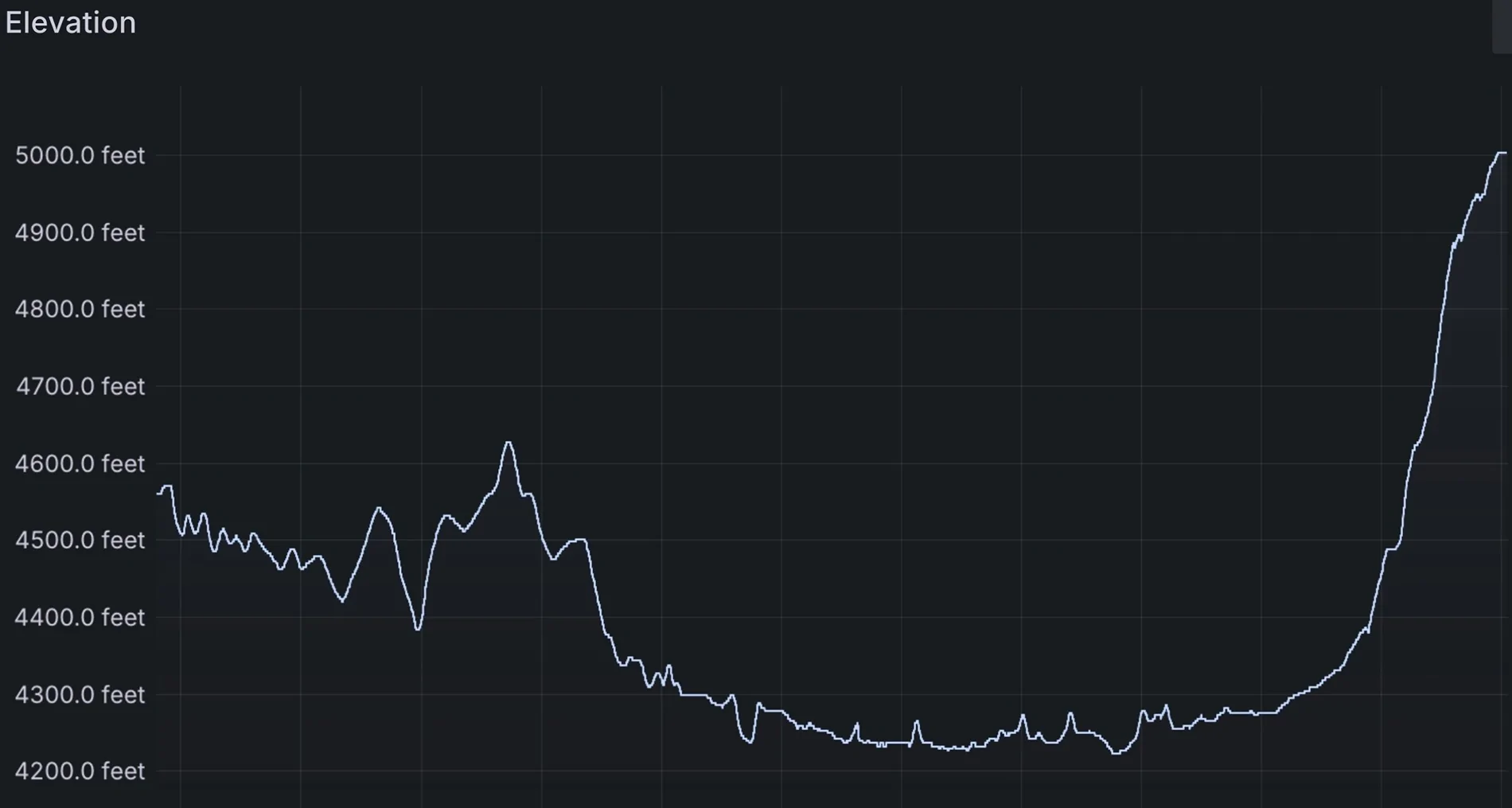

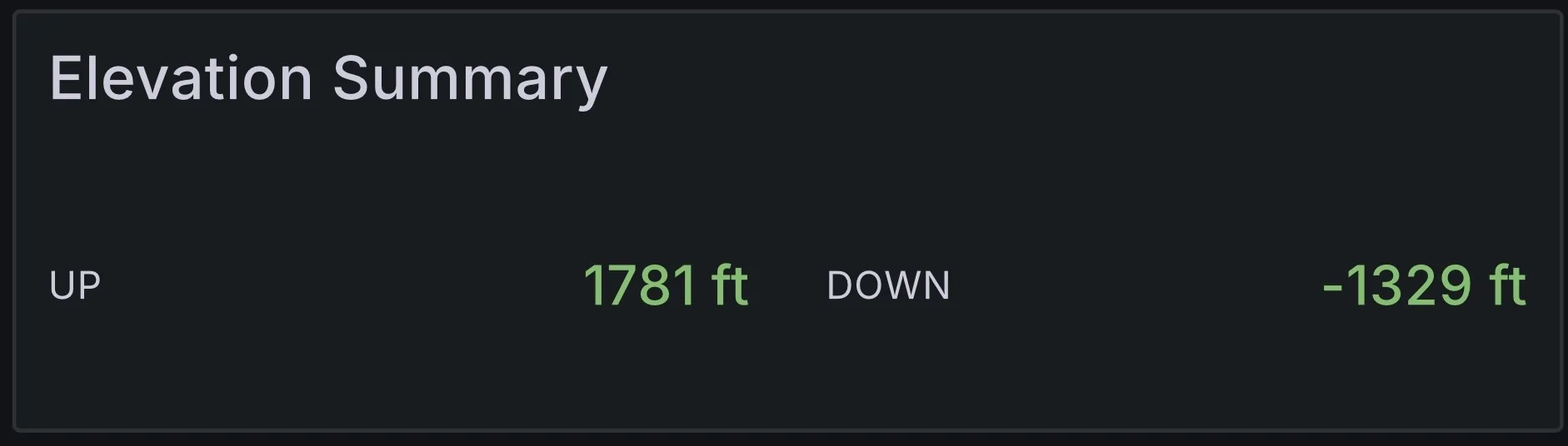

TLDR: 49% to go 118.1 miles with ~108 miles at 75 mph on BFGoodrich KO3, no aero covers.
Some stats as promised, if there is anything not listed you want to know and I have it, I’m happy to add it.
Total distance of both legs was 118.1 miles. First 4.8 miles and last 4.9 miles of each leg respectively was side roads with speeds between 25 - 55 mph and roughly three stop each way.
All interstate speeds had cruse set to 75 with little traffic forcing slower speeds and never over 75 mph. No aggressive accelerations. One of the most difficult drives of my life :)
Drive mode was set to comfort for both legs.
Climate was set to auto @ 66°F
Outside temp was between 61°F and 68°F for the entire distance
Estimated 250 lbs of gear that lives in the truck full time plus a single human @ 230 lbs
BFGoodrich KO3 with 5,893 miles and tread depth between 18/32nd and 17/32nd at the start of the trips
No aero covers, only lug nut caps and center cap.
Little to no wind
Charged from 51% to 91% on Wall Connector @ ~11.8 kW for four hours and eighteen minutes directly prior to drive, battery should have been warm.
Lifetime trip stats prior to trips:
Distance Total Energy Avg. Energy
30,441 13,636 kWh 448.0 Wh/mi
DistanceTotal EnergyAvg. Energy
30,44113,636448.0 Wh/mi
Lifetime trip stats after trips:
30,555 13,692 kWh 448.1 Wh/mi
30,55513,692448.1 Wh/mi
First leg starting SoC 91% with ending SoC 68%
First leg of the trip “Current Drive” data:
59.0 mi
26.7 kWh
1:01 hr (time is different due to an ATM stop)
452.2 Wh/mi
Parked for 19 minutes between trips.
Second leg starting SoC 67% with ending SoC 42%
Second leg of the trip “Current Drive” data:
59.1 mi
28.7 kWh
55 min (time is different due to an ATM stop)
548.1 Wh/mi
“Since Charge” data:
118.1 mi
55.4 kWh
468.6 Wh/mi
Elevation graph for second leg (first leg elevation graph was jacked up but it’s s just the inverse)
