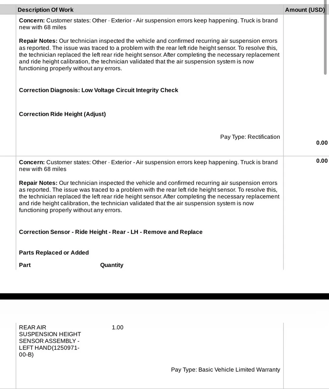

Just picked up my new 2026 CT and it has a warning saying that Adaptive Suspension Unavilable

Drove the 3 hours down the the SC and they were extremely helpful, even let me have the private office like room for working. They managed to work it in without the appointment and had to order the RF height sensor. Gave me the option for a mobile repair in a few weeks, but I told them I have to pass through there next Wednesday so they kept my original appointment to install it. I did get to the supercharger with the system disabled, then reached in and pushed the plug in again. It worked all the way home until the bump in the car wash exit. It rode great the whole way, quite a but smoother and better efficiency on low with the operational system.

It says it maybe available on the next drive (its been a few different drives to get home and it's still there) After picking it up today I went back but the service department wasn't open today and it's a 4.5 hour drive back, or 3 hours to the closest one. Did they not calibrate something? The truck is still on FSD 13.2.9, so it hasn't been updated yet to the newest software. Thanks for the advise!
Schedule service appointment, then drive straight to the service center & they will see you immediately since it’s basically still brand new. It’s under warranty…your welcome!
Where is the plug you are referring to located?

Up in the wheel well near the upper control arm

Ok follow up stop by the SC when returning from my 1200 mile trip. They installed the height sensor (took lees than an hour including letting the truck charge to 80% from 20%) and all is good, which just barely saved me from insanity due to constant warning beeps for the previous 300 miles...
