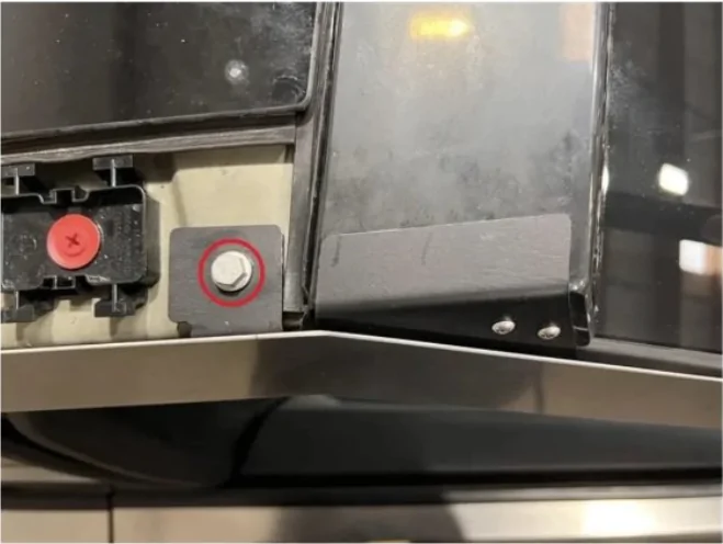

so this has nothing t do with the cantrain, it's the access panel that's flat that runs along the upper window, the lift out the plastic cover, install a bracket to the first 10 mm bolt believe or 3/8's , then the bracket faces forward to attach to the end cap of the light bar via a rivet in the triangle end cap. i have an appointment for April 2nd to get my recall completed in Milford CT

Virtually no range from the light bar. Immaterial. Yes. It’s fully compatible with the Mars rack. I go through all kinds of detail (with pics) regarding that in my post from last year.
I didn't see your post, but I thought you got yours installed back before they added the brackets.
In any case, I see the brackets now and understand the installation.
https://www.notateslaapp.com/news/3338/tesla-rolls-out-fix-for-cybertruck-off-road-lightbar
Tesla Cybertruck Lightbar installation - is there a new method? 1773341917659-lq
Also means I need to pull the rack off for this. Sigh.
