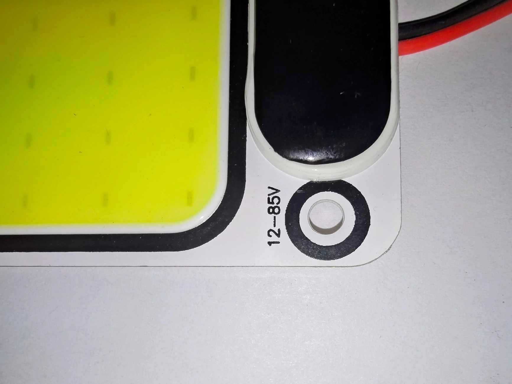

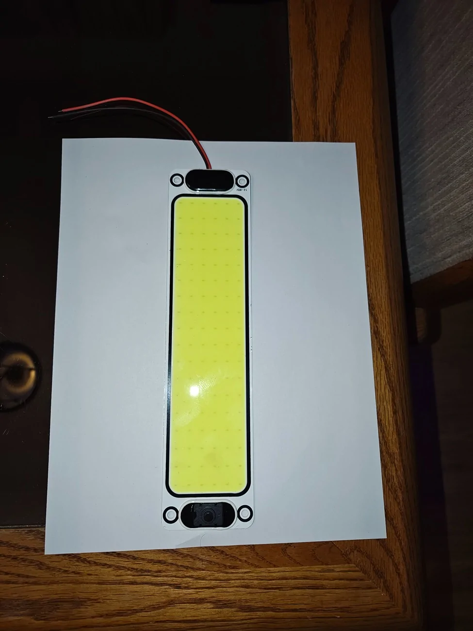

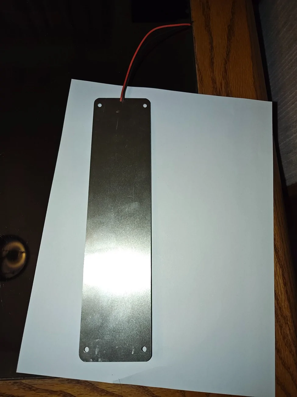

Haven't posted here in a while. I need to get caught up. I found these cool lights on Alibaba, a Chinese version of Amazon. I haven't mounted them yet as I just got them but i was able to test them with my lab power supply. They run on 12 to 85 volts. I saw that in one of the pictures not the listing itself. I can verify that it does start up around 12v and is stable at 55v as well. it has its own switch built in. I got two pairs of them for less than $15. I plan on putting two of them in the frunk on the side wings, and at least one on the underneath of one of my roof racks to shine in the bed. I know we have bed lighting and a frunk light but both are barely adequate, and with all the stuff in my bed most of that light is blocked. This will probably be overkill.
BTW that is a full sheet of paper.

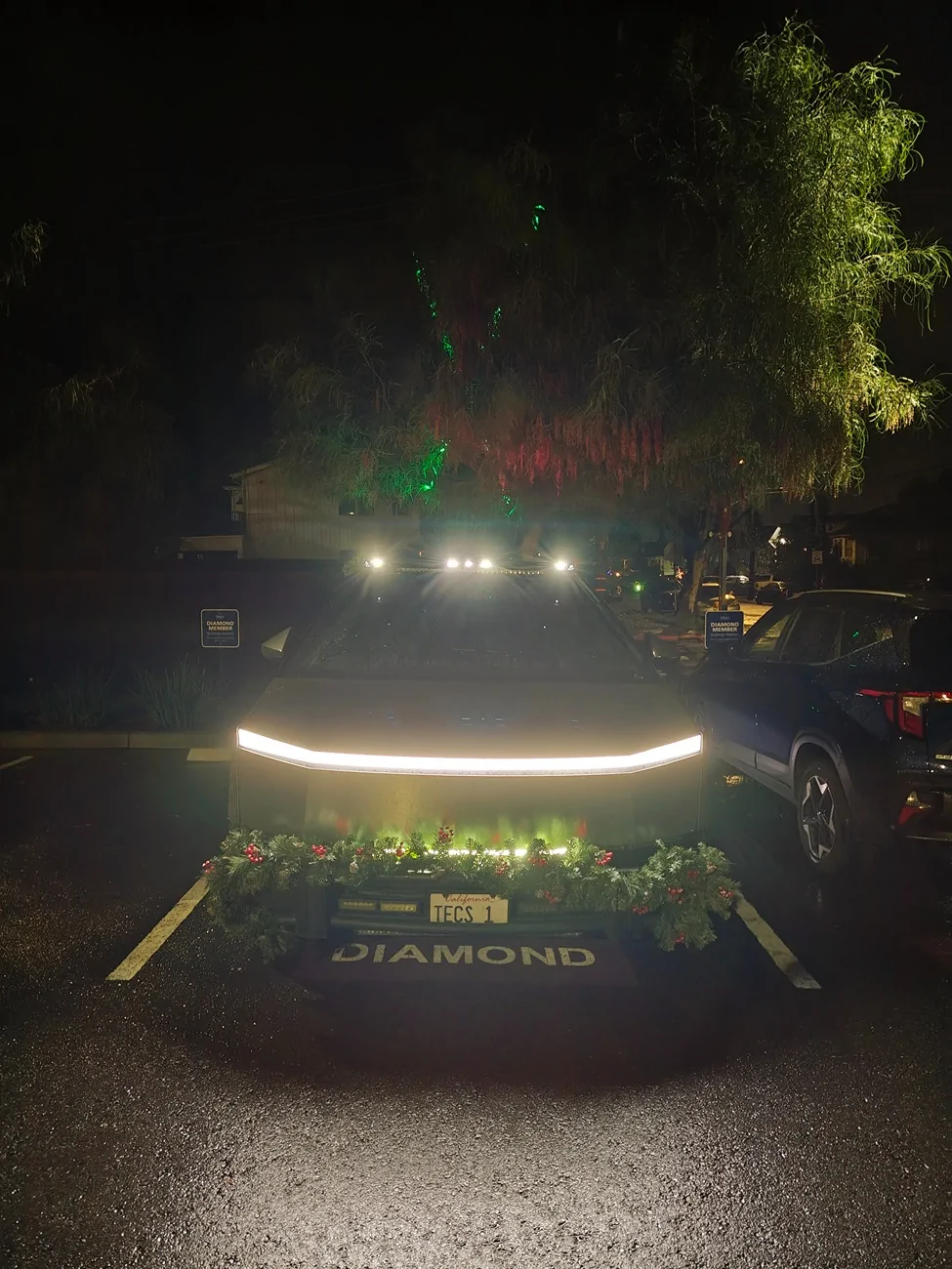

Got them installed finally. THIS TRUCK! Is anything predictable? I was tapping into the existing Frunk light so that it would work with the opening and closing. What voltage would you expect? I had read that everything was 48v. Then i found a few points that were 12v. Well guess what, the frunk light is 5V. 5volts! Why would a light be 5 volts. the puddle lights are 48, the interior lights are 48, the license plate light is 48v. but the frunk light is 5! anyway, i had to put in a relay, and then it was trouble finding one that would fit between the outer and inner panels. finally got it in and working. Its very bright and very helpful and comes on when you open the frunk, and if you don't want that much light you can turn them off manually.
