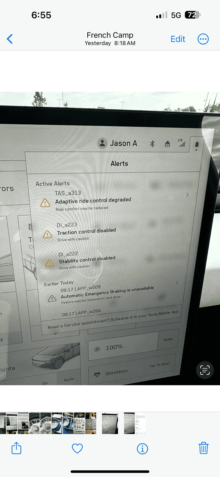

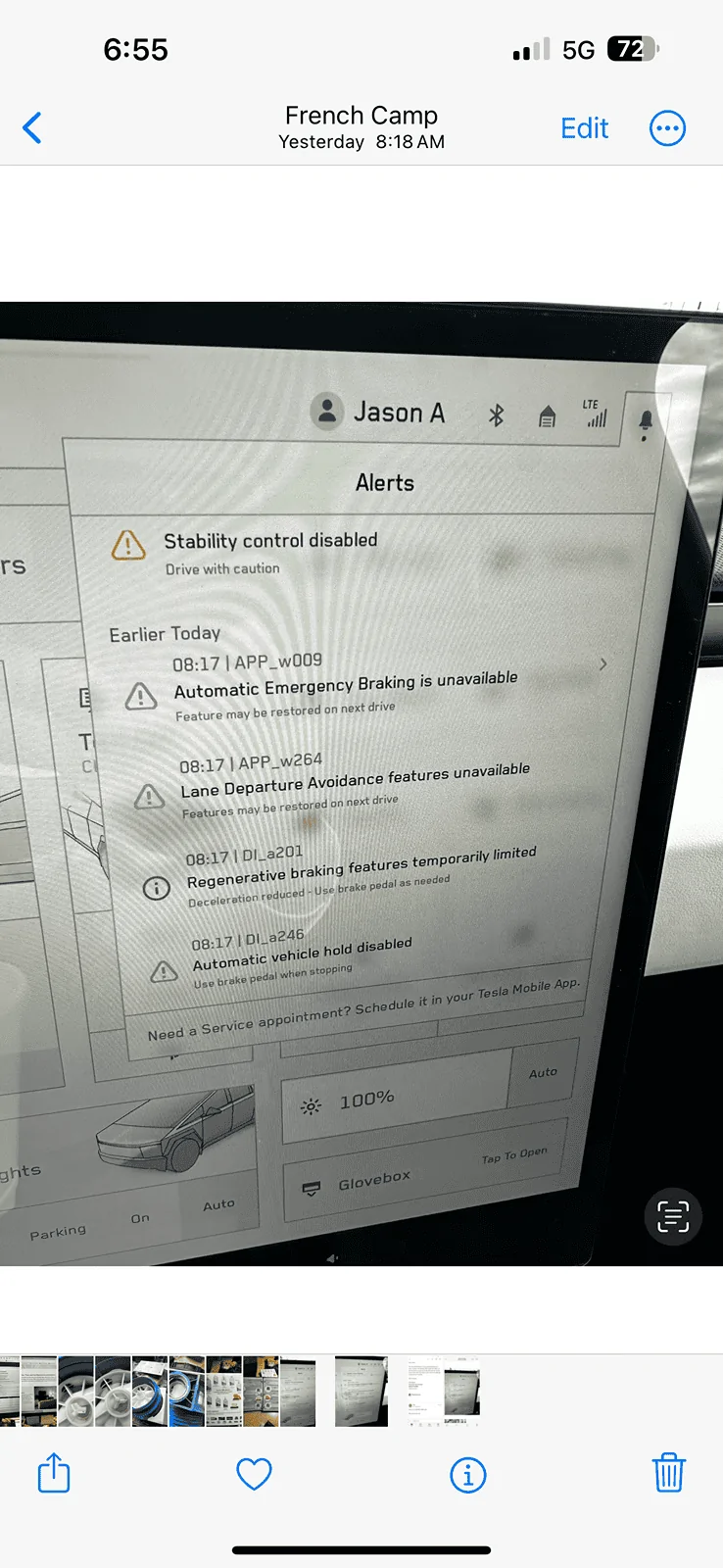

So my month old Cybertruck had three different instances of these same codes (see photos). The SC states that my case was sent to the escalation team, and a proactive repair is awaiting parts. My truck has been at the SC since last Thursday. I asked the service team if the issue is one of the wiring harness’s as some are reporting, but she wasn’t sure.

I forgot to mention, the codes self cleared after a walk away reset. While the alerts were up the braking was extremely sluggish and no regen at all, that was the only noticeable effects as I didn’t drive too far before resetting.

My ‘23 MX had the same exact issues. It took three sc visits for them to figure out it was a broken sway bar. The car has been fine since the part was replaced. YMMV.

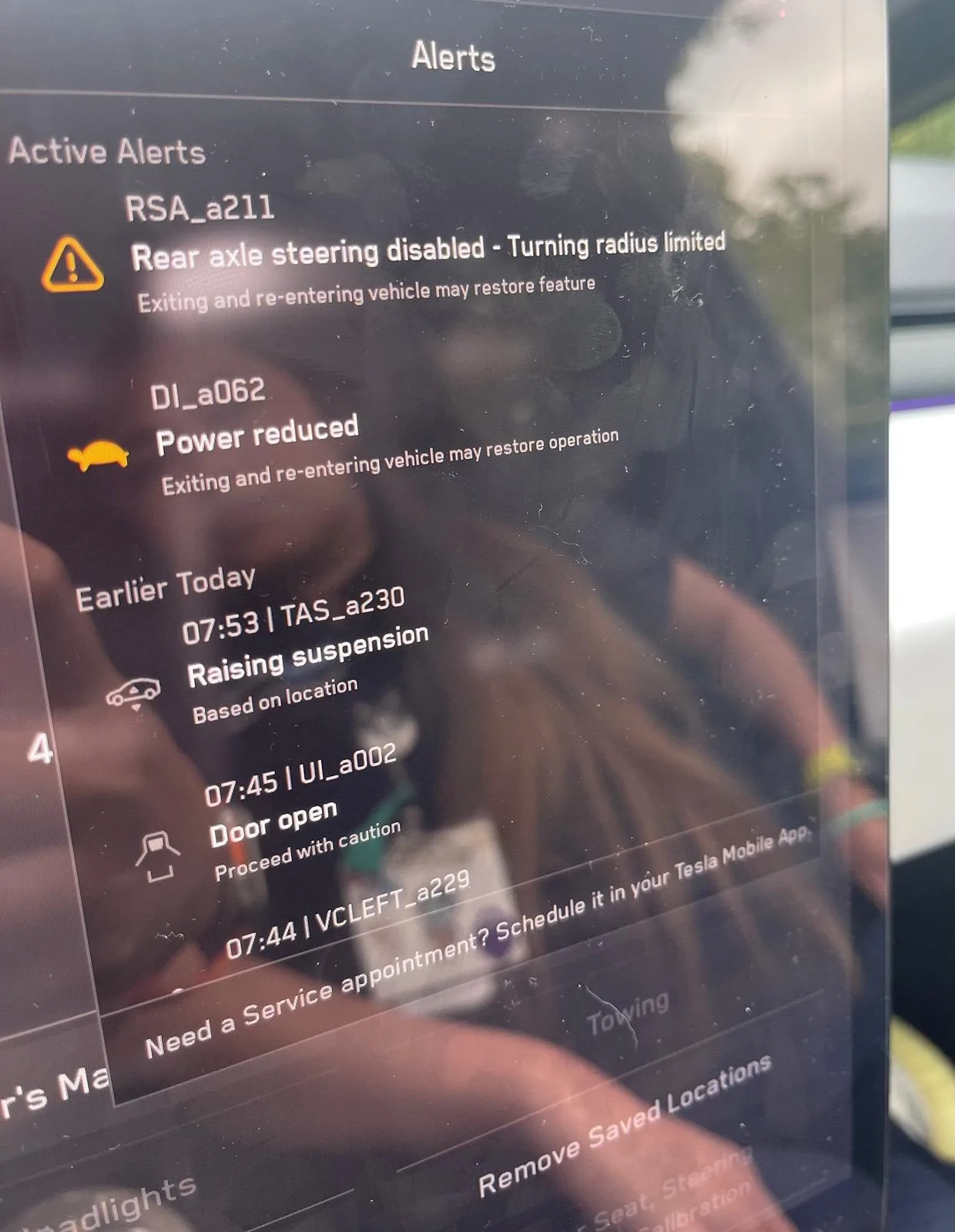

Had a similar issue, but the walk away reset worked for me, hasn’t come back.
Only had the truck for a week.
Alerts RSA_a211 & DI_a062
just my experience, not to worry you, but my MX had the same error code events that cleared themselves, several times before I decided to have it looked at. Even then, it took 3 different visits to have the problem go away long term. It was a broken sway bar in my case but they couldn't diagnose properly at first.
