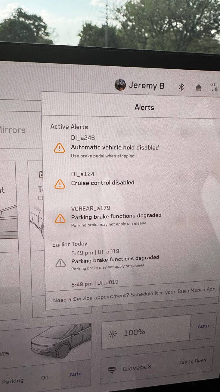

This happened to me today on the way home from work. Shutdown worked temporarily but the. The error came on after about 15 minutes. Scheduled a service appointment.
Tesla Cybertruck Receiving a lot of parking brake + vehicle hold error codes over the past couple of days IMG_9238
DFW_Hawt_Cyber
Derem
Jan 27, 2025
Dallas
2025 Tesla Cyberbeast
Finance
I am getting these errors and have caliper covers on. Should I take them off before I take the truck in for service?

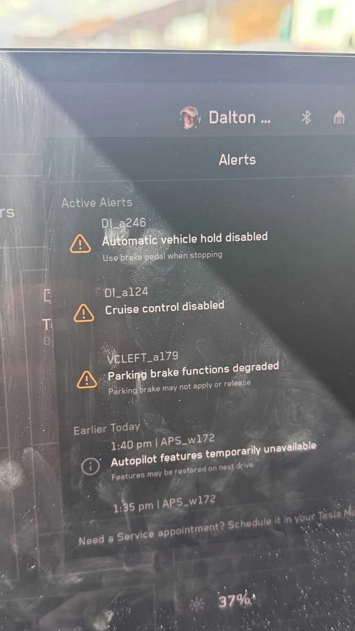

Over the past 1-2 months, I've had similar alerts occur...both while using FSD. What will happen is out of nowhere FSD will display the red steering wheel icon saying to take control immediately. It's as if the FSD software stack crashes, then I get 3 alerts in the Notifications menu:
  • DI_a246 - Automatic vehicle hold disabled
  • DI-a124 - Cruise control disabled
  • VCLEFT_a179 - Parking brake functions degraded
When this occurs, FSD is no longer available (and a dual scroll wheel reset doesn't fix it). Only way is to park the truck, get out of it for a few minutes. Then, everything works fine.
I had this happen two times (only while FSD is engaged):
  • Yesterday (the day after I installed 2025.32.8)
  • Maybe 3-4 weeks ago on, I think, 2025.32.6.
I'm wondering if it's just a software bug with the more recent releases or if my Body Control Module or brake sensor is failing?
Tesla Cybertruck Receiving a lot of parking brake + vehicle hold error codes over the past couple of days IMG_0075

Anyone else seeing these codes? They are starting to happen on every drive. They usually clear after the truck sleeps for a while. The parking hold issue usually occurs when I come to a stop on a decline or incline. After the code throws the truck just free rolls forward or backwards after I come to a stop. I have to hold the brake manually.
UI_a019 - Parking brake functions degraded
VCREAR_a179 - Parking brake functions degraded
Yes I had the exact same thing multiple times on my trip back from SoCal when I got my rock sliders installed at UP. It affected my ability to use FSD multiple occasions and it only happened while I was using FSD. I’ll say it happened three times requiring a power down reset (scroll wheel reset ineffective) of the vehicle to get back on the road and use FSD.
Very frustrating. It seemed to have happened in my case while I was driving and if I was passing or being passed by an 18 wheeler the gust/vortex seemed to cause the issue. Was your situation similar or did you have maybe high winds or something?
