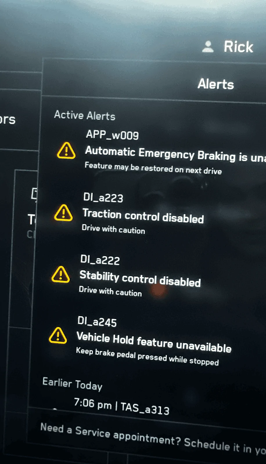

I was driving my CT, driving normal and at the speed limit all of a sudden I received ABS disabled alert, traction control disabled alert, automatic emergency braking unavailable, stability control disabled and vehicle hold feature unavailable. The truck would jolt when I accelerated and then drive bumpy as if I was driving over ridges. Has anyone had this issue ?? This was scary! considering I was driving with my kids. ( I have a service center appointment today ) sooo bummed!
Did you get it into service? Looks like all break related so you may want to get it towed in instead of driving it.

Yes, I had those errors along with others. They identified the problem and replaced the faulty Low Voltage Wire Harness.
What other errors did you have? If you go back to your Cybertruck and scroll down you can see them all. The other errors associated with those were that the rear steering stopped working. If you exit the car and let it reset it will clear the problems, but more than likely it will happen again. Create a service appointment.
I had this happen once on my model S after having it detailed. I think a sensor got wet and threw the system out of whack. Next morning everything was fine.

What’s your truck’s s/n? Does sound like that wire harness issue. That’s a big repair so I’m wondering if newer s/n’s are having this issue. If they are Tesla’s problem looks very expensive.
S/N 1868
