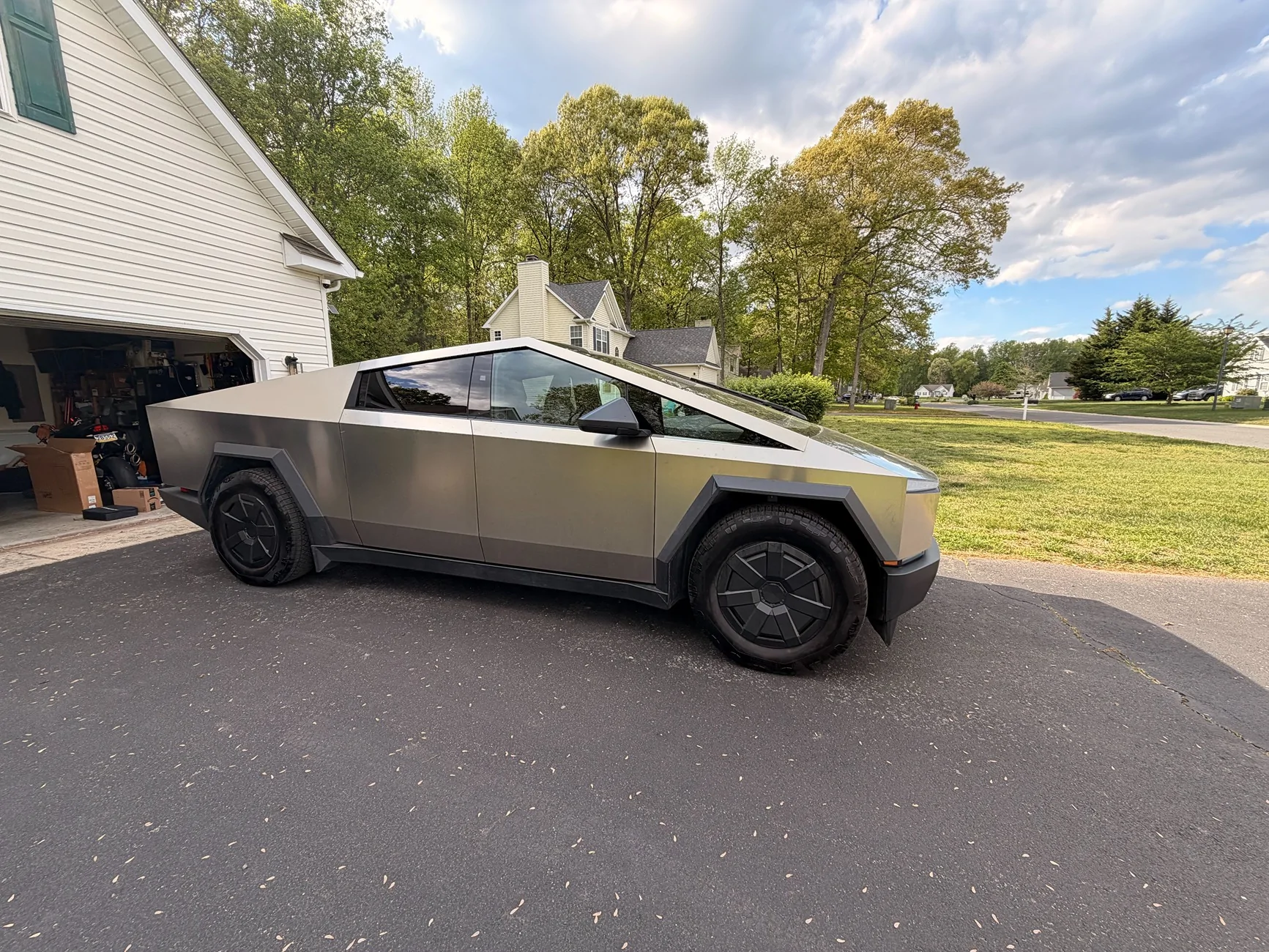

Here is the before:

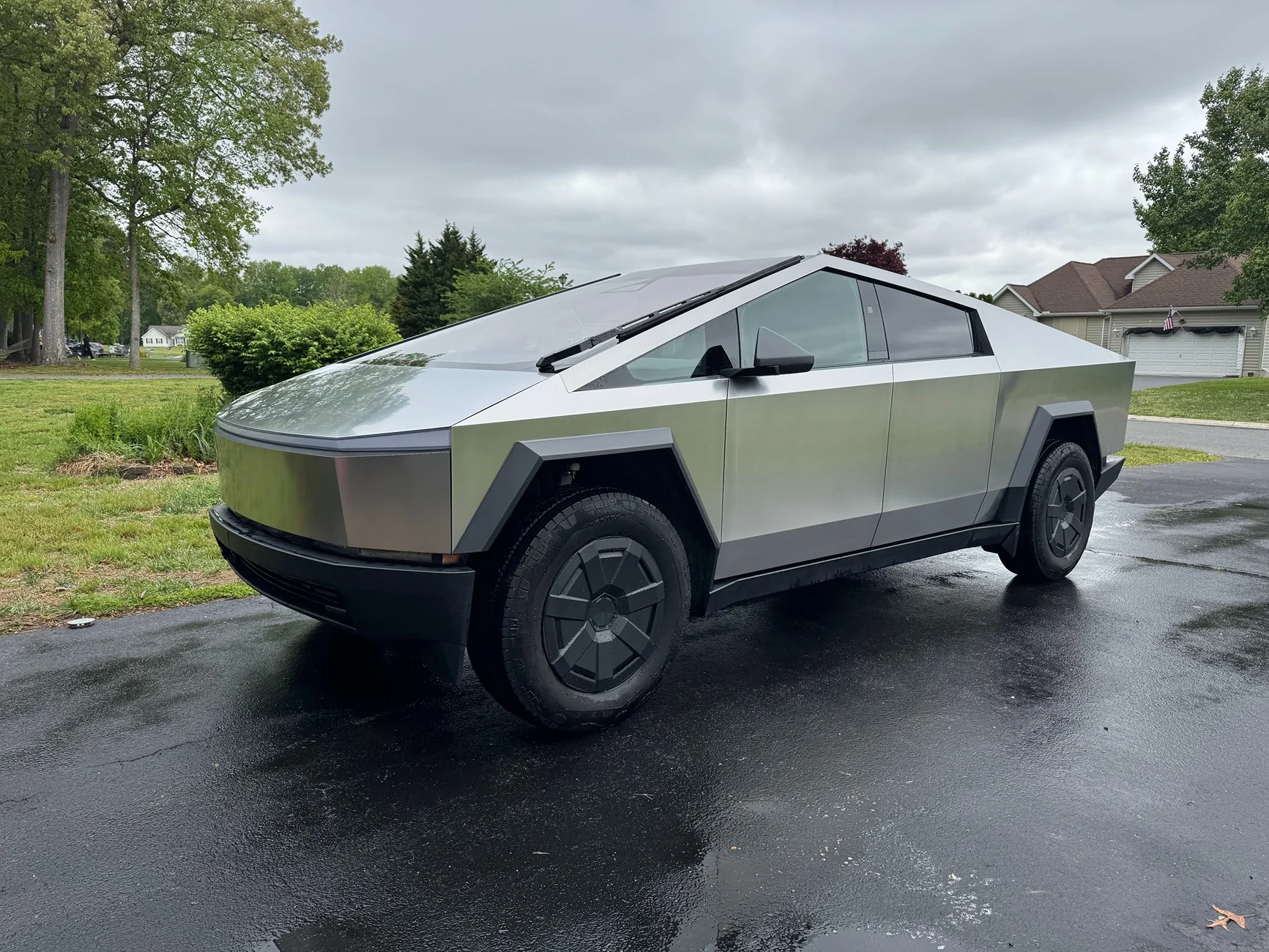

And here is the After:

Here is the before:
