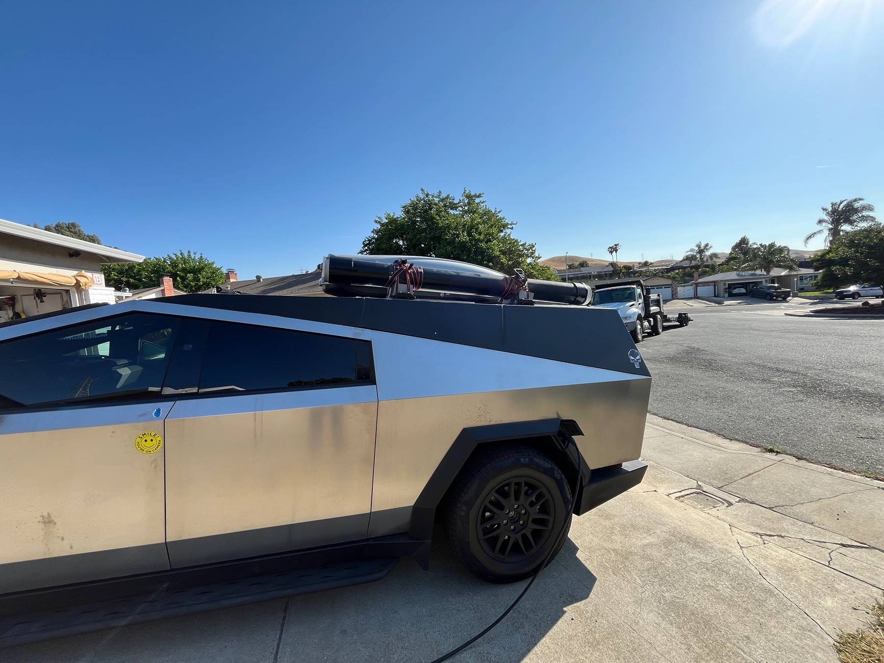

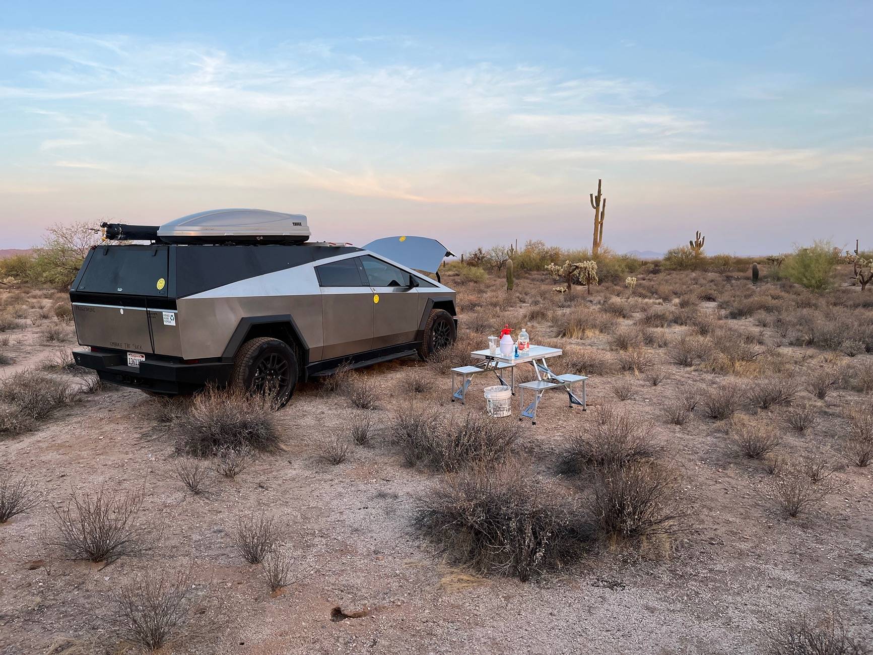

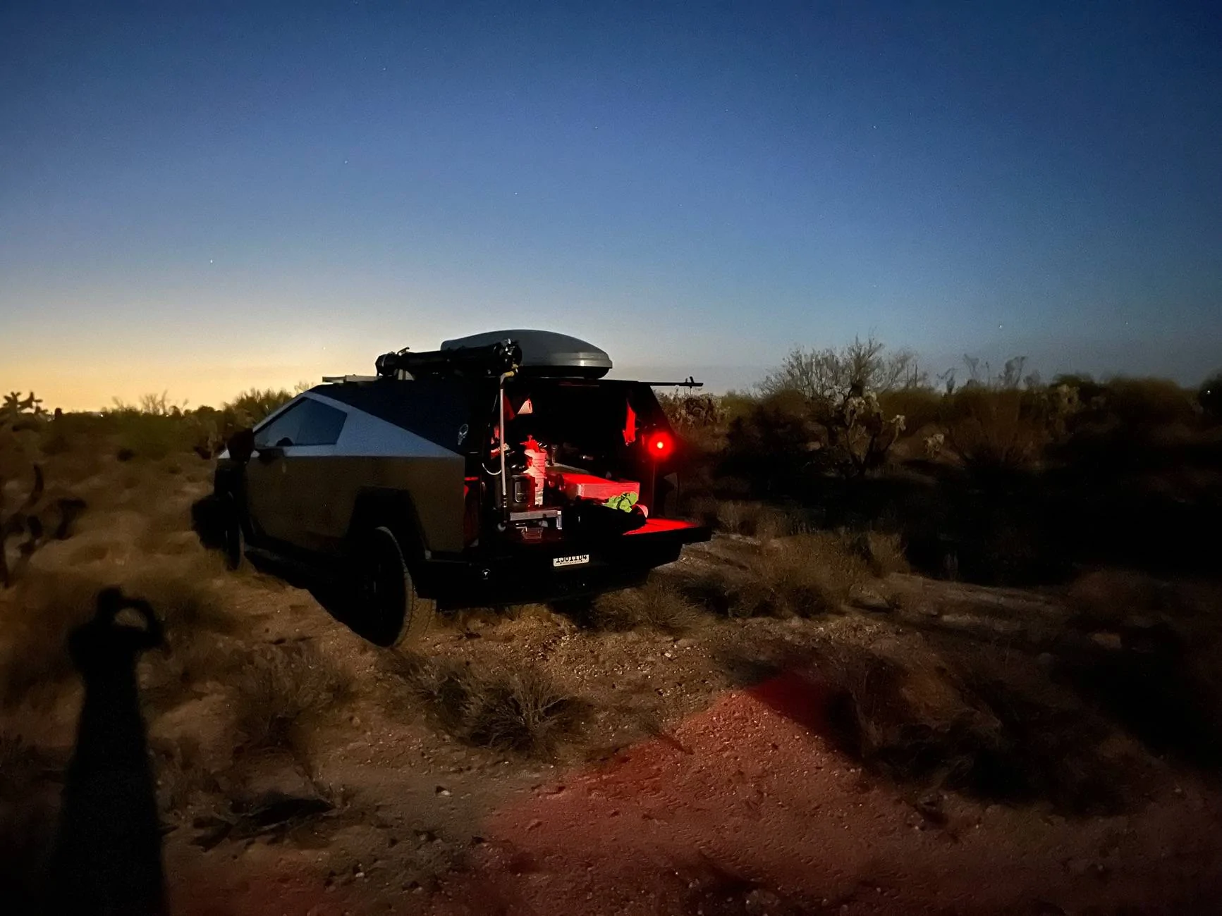

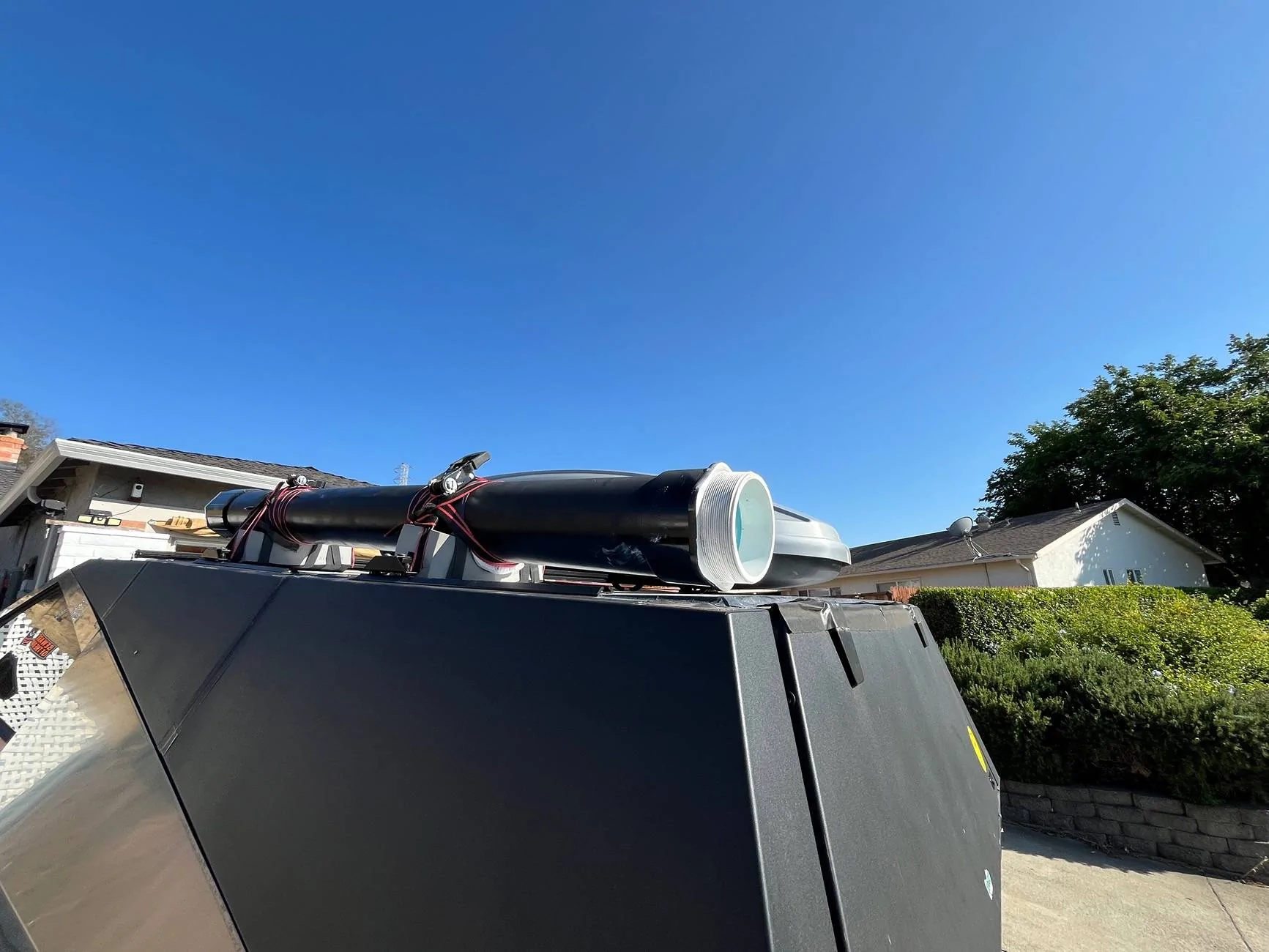

I just did 20 days in my DIY non-pop-top build truck bed with guest sleeping / galley / storage. I slept in the back seat cab area with climate control and did 7000 miles in about 20 days. I made a solar shower for roof that got to about 120f daily. 10 gallons

My average efficiency was around 475 watt hrs per mile. With rear rack. Thule topper. And solar shower I built the solar shower out of pvc piping painted black with both compression fittings for pressurized air spray or gravity fed which was its most used style. I also put in a 1500 watt heating element incase I needed supplemental heat which I didn’t during summer during winter it could be different.
