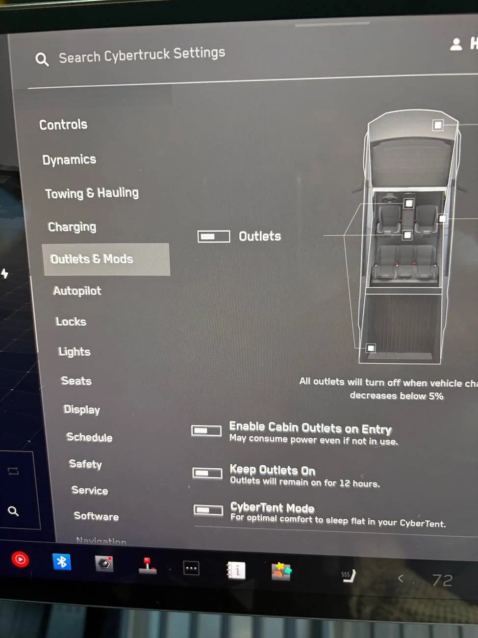

Still here for me on 2025.20.6:

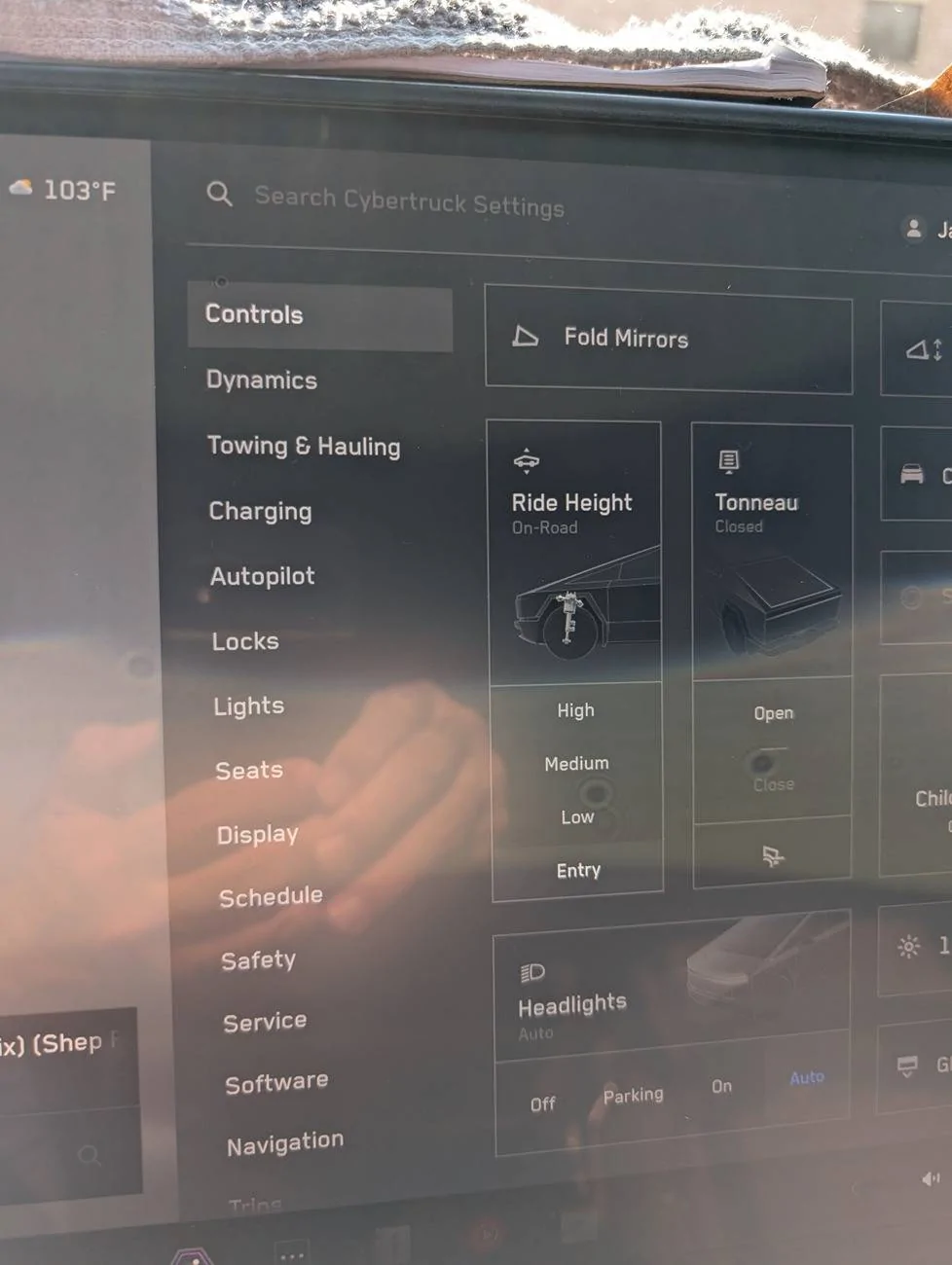

Well, I am missing the Outlets menu and my outlet does not come on :(
How do I get the menu back? Any suggestions?

Still here for me, too. Man, that's a weird one.
If you haven't, try a reboot.
Touchscreen Restart:
- Shift the Cybertruck into Park.
- Press and hold both scroll buttons on the steering wheel simultaneously.
- Continue holding until the touchscreen goes black and the Tesla T logo appears.
- Release the buttons and allow the touchscreen to reboot.
- The touchscreen should be responsive again.
Power Cycling the Vehicle:
- On the touchscreen, navigate to Controls > Safety > Power Off.
- Wait for at least two minutes without touching the vehicle (no opening doors, touching the brake pedal, etc.).
- After two minutes, open a door to wake the vehicle.

That worked!
I just restarted the screen (no red Tesla logo appeared, and it remained dark, so I released the buttons). And after a while, the CT logo appeared, and the Outlets menu is now back.
Thanks for your help.
