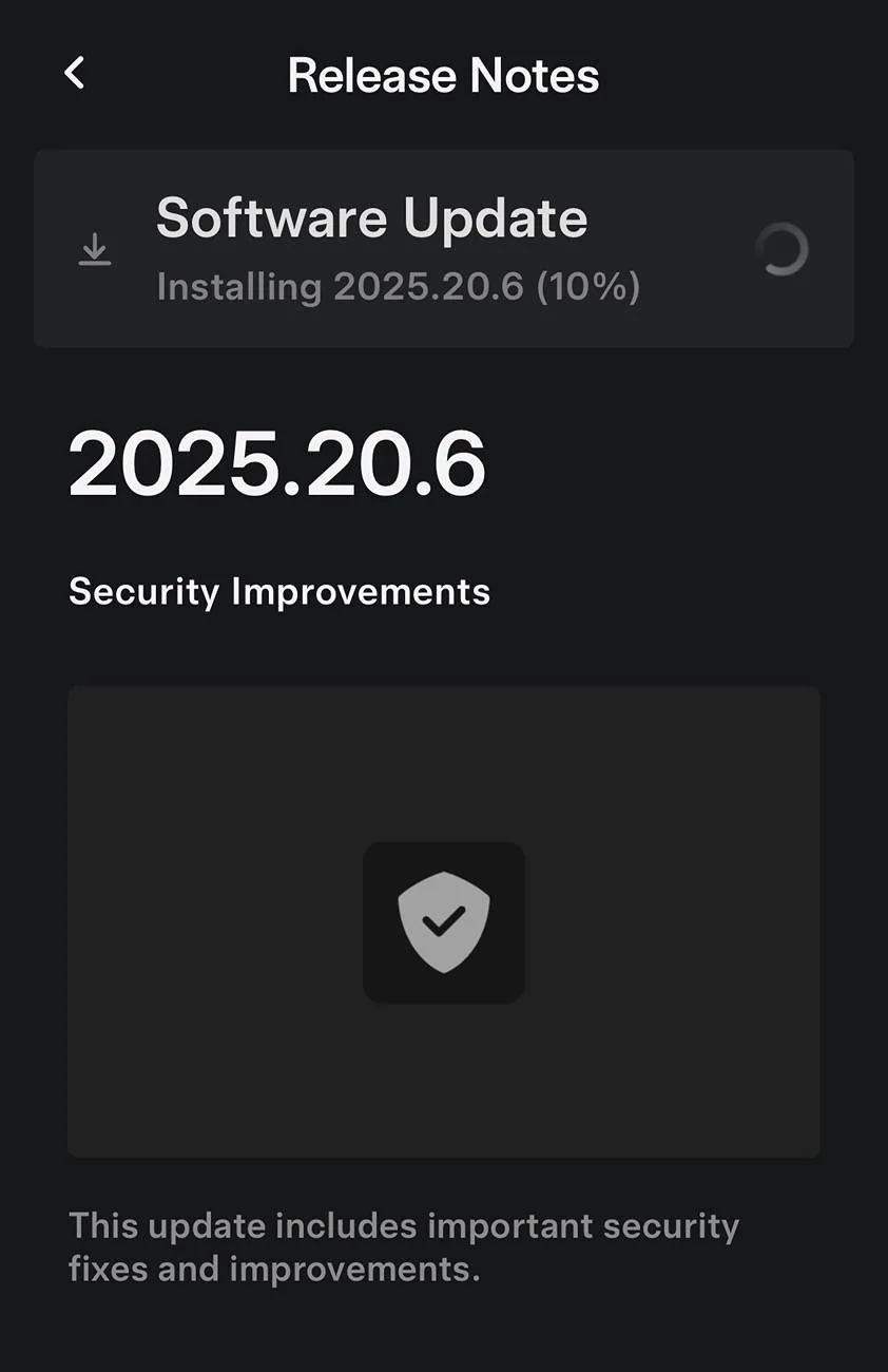

Tesla Cybertruck 2025.20.6 Update now downloading IMG_8060

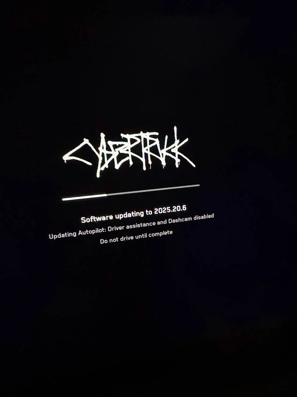

Tesla Cybertruck 2025.20.6 Update now downloading IMG_1197

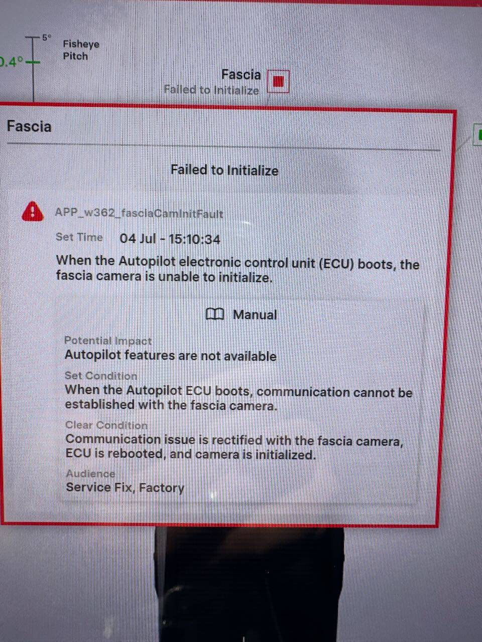

My bumper camera stopped working (and "Park Assist unavailable" error appeared) after updating to 2025.20.6. The bumper camera view was just black. I went into Service Mode and saw that the fascia (bumper) camera failed to initialize. Rebooting didn't help so I reset DAS and that fixed it up.
I was also logged out of Apple Music, but that might have just being a coincidence with timing (possibly expired?).
