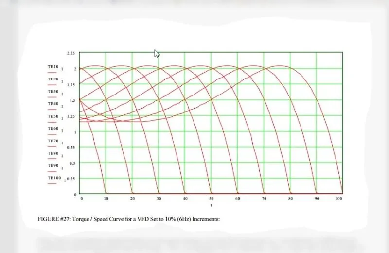

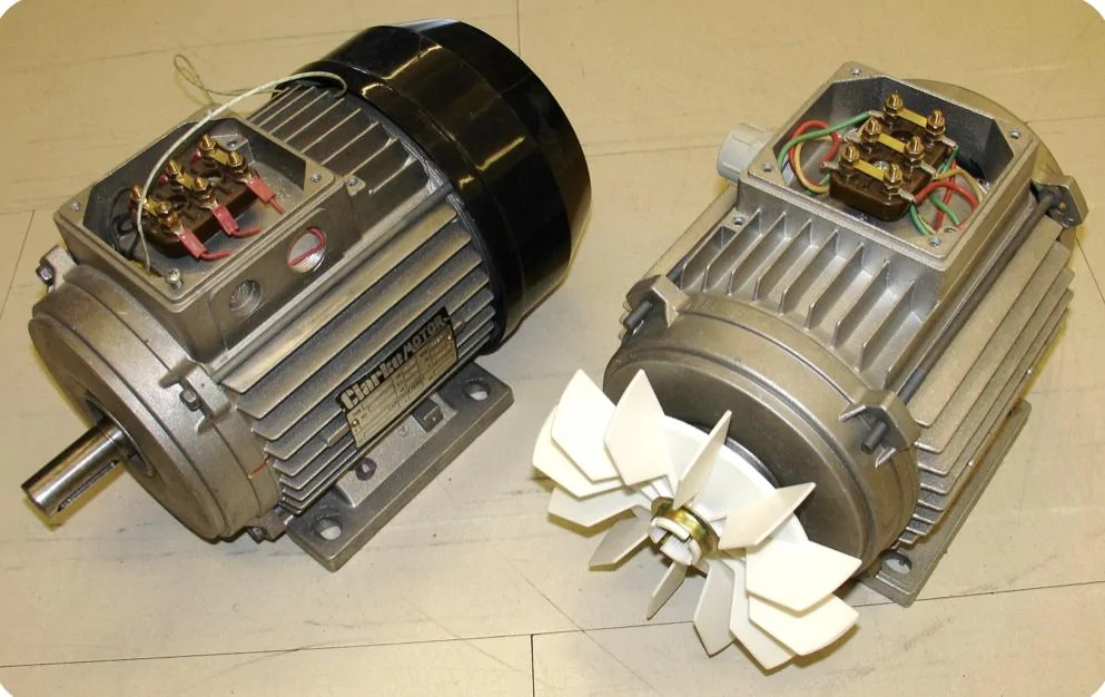

The Semi can benefit the most. Running high torque at low speeds is not efficient for the induction motor and they produce a lot of heat.
Heat production is a direct connection to power applied - so more speed equals more heat.
As pointed out earlier, static motors push air away from them through centrifugal force, which means are higher speeds you have more cooling.
This just doesn't apply to EV motors at all.
Although the power applied does have some connection to the amount of heat generated it is not exactly a direct connection. The efficiency determines how much of the power applied gets converted to heat. With a simple motor you can't change the efficiency in any way so your job is done. With the power split we can do all sorts of tricky things to get better efficiency.
Do I need to explain why that statement is completely false?
Crissa are you doing ok? I'm genuinely getting concerned now. :-(
"so more speed equals more heat" and " which means are higher speeds you have more cooling".
You're going to have to decide which one it is.
If you read the entire sentence she was referring to a type of motor I pointed out earlier. A static (meaning mounted in a factory, not in a vehicle) motor that is fan cooled where the fan speed is based on motor shaft speed. In this type of motor, the cooling is increased with speed.
So what does a static motors have to do with planetary gears in a electric semi or truck as per the OPs comments?
None of the EV motors in production cars that I know of are "static" (stationary?) neither are there many that are air fan cooled directly from its own driveshaft. Especially Teslas, that are all water jacket cooled motors with seperate water pumps and with fan driven radiators. Further heat generation is not dependant on motor speed (rpm?) rather motor load, which is not rpm dependant. A stalled motor also produces heat, and water jacket cooling works while the vehicle is stationary as well, like on a car dyno at full power.

So what does a static motors have to do with…
Well, when I brought it up earlier it was when you claimed high torque low speed motors created a lot of heat. I explained that the only time I knew of where low speed caused excessive heat is in this fan cooled type of motor. I was pointing out that unless you have this type of motor, (which EV’s most likely do not), low speed has virtually no effect on motor temperature. I believe we’ve gone full circle and now you are also claiming speed has virtually no effect on the motor temp.
Yes, load affects motor temperature. More accurately, current (amps) is the most relevant factor in temperature and depending on the type of motor, application, etc. motor current can be considered proportional to load. (with some exceptions).
