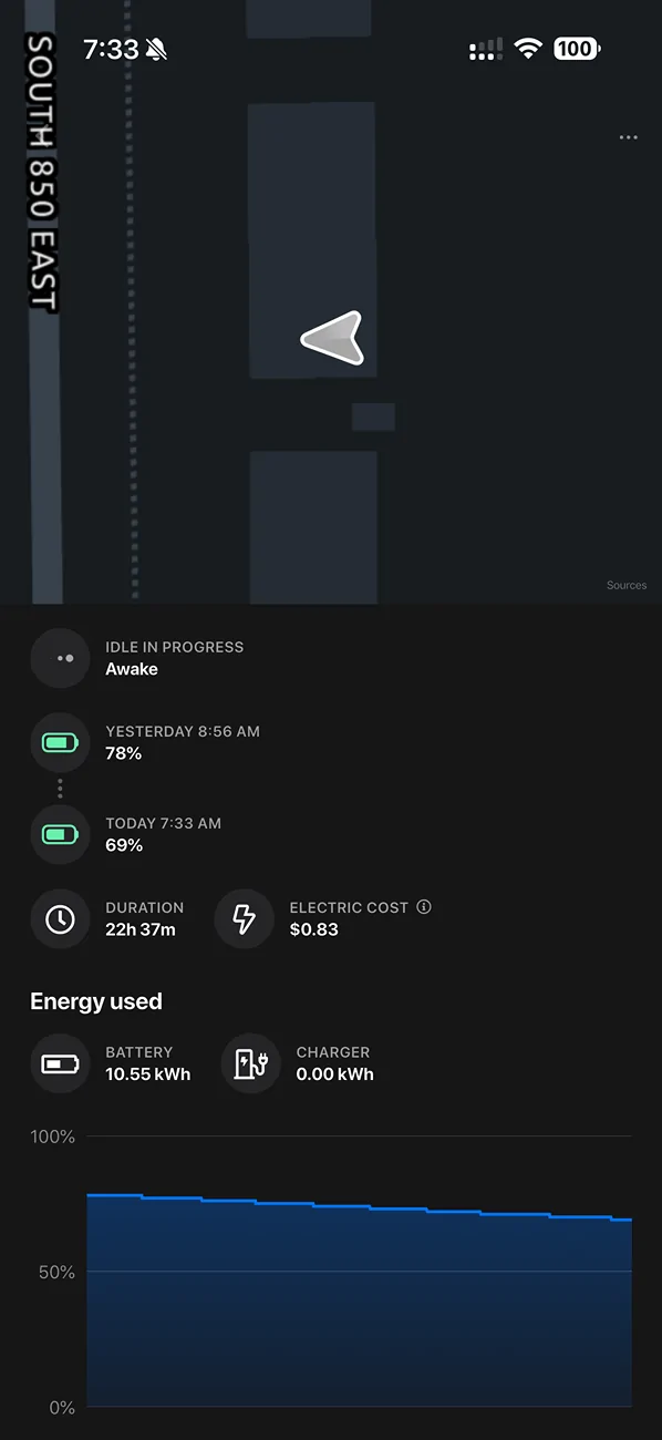

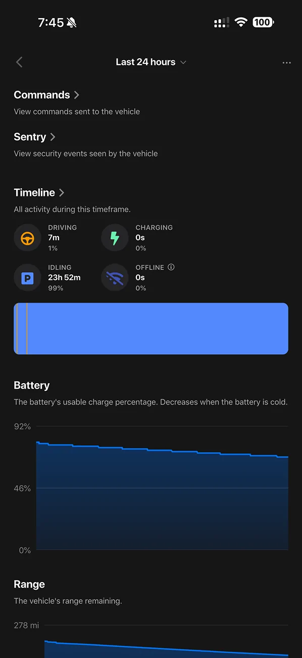

Hey guys. Lately my truck has had terrible insomnia. It never goes into deep sleep and the phanton drain is horrendous. I feel like this started with the 2025.38.9 update. Haven't been driving my truck a ton lately and this is just outrageous. SOOO much wasted energy. Truck has been sitting in my garage unplugged. Sentry off. I even turned on low power mode last night and it didn't help. I'm about to give this thing a hard hard reboot by pulling 48v battery and HVIL. Anyone else having similar issues? Only third party app is use is Tessie and it's never been the problem.

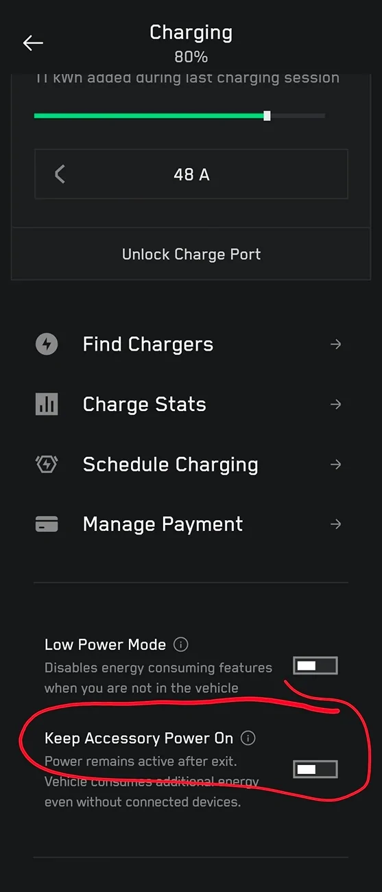

Make this is disabled I your phone app under charging. Whenever I turn it on it will drain by not going to sleep.

Yep that’s off too. What really drives me nuts is I have it low power mode with should force it to deep sleep. Still nothing.
