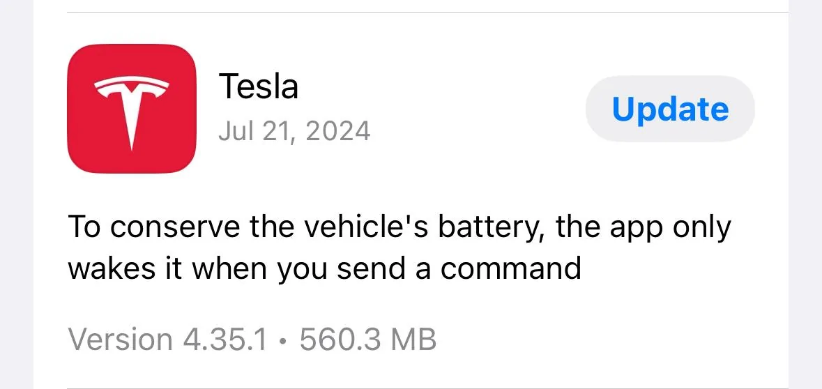

I did not do anything to wake it up as opening the app now does not wake up the truck until you interact with it
Before the simple act of looking at the car or truck in the app started the wake up procedure. Finally years later the app fix was made.
When you check on your truck, you wake it up and that also uses energy.
