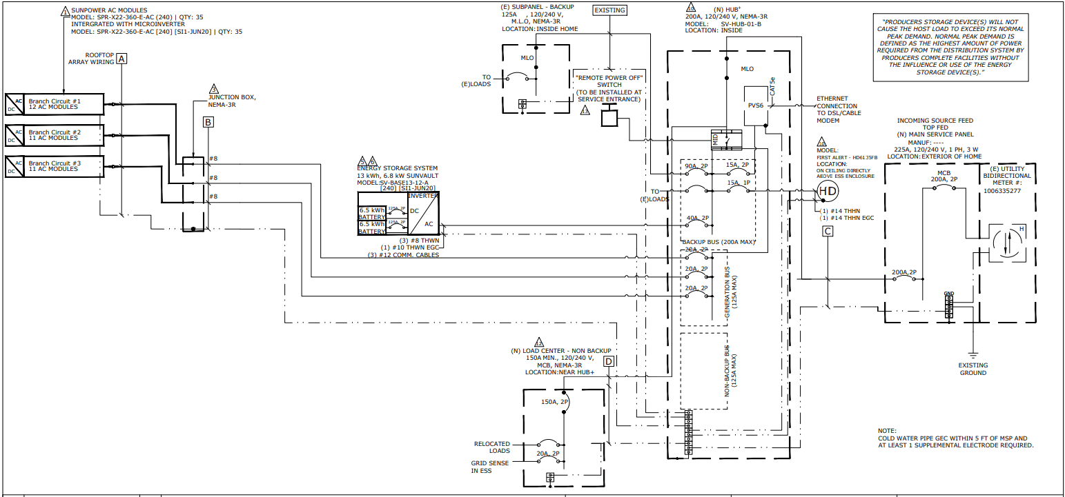

We have a newly installed SunPower PV & battery system. The PV system has micro inverters. It is a partial home backup with a 13kWh battery. EV chargers, AC units and the oven are non backup loads.
I have no idea how the Tesla gateway can be added for Powershare. Attached is our electrical diagram.

If you are running microinverters, it may have to be installed upstream toward the panel.

It won’t. They will want to install it isolated from the Pv and third party battery. For now it won’t even support power walls or Tesla solar.

Update: So I called Sunpower, and was told their system is not compatible with Tesla Powershare. Then I told my installer Willow Glen Electric so. They had updated their Tesla portal with my notes to confirm the reason that I’ve cancelled this opportunity 2 weeks ago. I haven't heard from Tesla yet.
